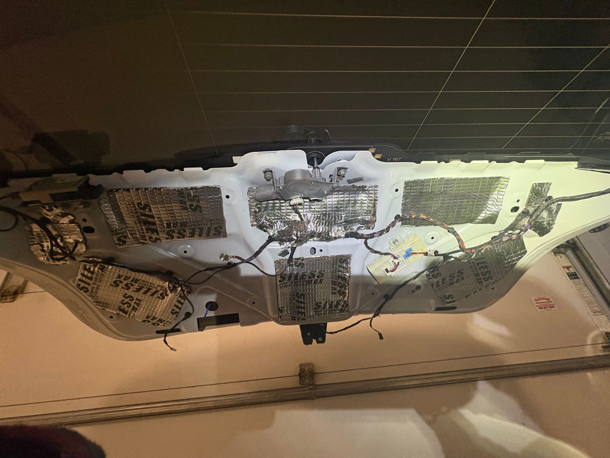

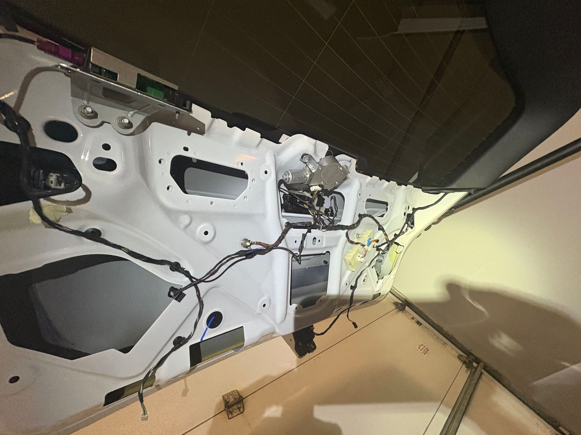

I have been suffering from and following this issue for roughly the past year. Along with this post, I have followed similar postings on other sites (such as https://www.mercedesgleforum.com/thr...?nested_view=1 and https://www.mercedesgleforum.com/thr...-gle-350.4438/). Many have reported brief relief from software updates to the park control unit, but no definitive fixes yet that I have seen. I assume many are aware that Mercedes has a couple of sound proofing blocks (parts 166-682-03-41 and 166-682-00-70), but most people say are only minimally effective.
However in the second link I posted above, I was excited to see post #10 where bkp says he "found a solution if you're willing to pay for it." His solution was to put Siless Max sound deadener all around the rear hatch camera area. The success was confirmed on post #33 by JRD47. That was enough evidence for me to order the Siless Max from Amazon and make plans to install it. I am also calling it a great SUCCESS. Not silent, but probably 95% improved. What a relief! Details below.
Amazon sells the Siless Max either as 6 square feet, or 30 square feet.
Amazon Amazon
I got the 30 square foot box, but only used about a third of it. However, not sure 6 square feet would have been enough. Perhaps two of the 6 square feet boxes is the sweet spot.
This is the best how to I could find for removing the rear hatch trim:
Obviously a different model than the v167, but (other than two handles vs one) it is very similar to my 450e. Be sure to note the metal clips inside the handle grip that he shows at around 45 seconds in the video. It is essential that these clips be removed, and it's probably the hardest part of getting the trim off. One would think that all you need to do is squeeze them and they should slide right out, but there is secondary ridge of metal behind the outer edge of the clip - and both sides of this ridge need to be pressed in at the same time before the clip comes out. I ended using a combination of a very thin small screwdriver and a pick. Frustrating, but keep at it and you'll get it. You'll also want a nice pick tool to undo the electrical connections as seen in the video. Also, I wouldn't use the handle as the method for initially separating the trim from the plastic clips like he does in the video - when I did that the handle separated from the trim piece. It clipped back in just fine, but a little unnerving when it happened. My advice is to work the edge of the trim piece with a plastic pry tool until a plastic clip loosens.
For the other plastic clips I recommend having an extra long clip removal tool (such as
Amazon Amazon
I was very careful and all my plastic clips came out without losing or breaking any, but you might want to have some spare ones hand in case any break during removal. Part # 001-991-32-98.
After removing the trim, this is what the back of the hatch looks like. Two layers of sheet metal seemingly designed to echo the clicking noise of the camera opening and closing.
I particularly focused on attaching the Siless around the area under the rear wiper where the camera is located. I really went to town on it and put lots of small pieces everywhere I could think of - basically filled that area up. The Siless cuts easily with a large pair of bandage shears. As can be seen, there are two pieces of sheet metal that form the rear hatch. Attempting to dampen any reverberation that may be occurring between those two areas I put several sheets of Siless on both sides of the internal cavity. Then I also covered all the openings. Of course, note where the clips fasten to the hatch and leave those areas uncovered. This is how it looked when I was done:
As an aside, even though I mentioned the sound blocking parts that Mercedes offers, I did not use them since so many people have said they are only minimally effective.
Quite a shame that I had to pay for the solution myself, as well as spend about an hour cutting and sticking on the Siless, but I am very, very pleased with the outcome.
Hope that helps.
Amazon Amazon
Amazon Amazon
Hope that helps.
Stephen
stevieg58,
Thank you very much for your post! I bought Siless Max from Amazon and installed it this afternoon. I am back from my first drive after installation and the Siless Max made a huge difference. I also purchased some batting at a fabric store and stuffed it into all cavities in the tailgate during the process. I have struggled with the camera since we have owned the car and have been extremely disappointed in the way MB has ignored this issue. The treatment they have given their customers has been atrocious. I have been a loyal MB customer for over 40 years, but I will be looking elsewhere the next time I am in the market.
Bottom line, with the radio on, I cannot hear the camera.
All, if you have struggled with this issues, here is your fix. I am extremely happy with results.
Again, stevieg58, much appreciated.
Doug

I found this from the FB groups. An MB tech said that this is what they did to drastically reduce the sound from the rear camera. I had my dealership do this and it worked. I'll obviously still hear it when the volume is completely off, but it's much improved and during regular driving, I don't hear anything anymore. It used to sound like something was rolling around back in the cargo.
