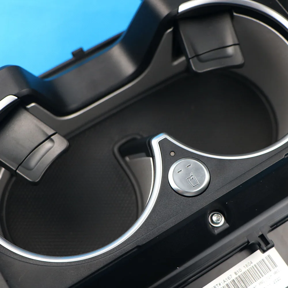

Nov 29, 2023 | 04:38 PM
https://ae01.alicdn.com/kf/H1f7b97dd...1678101804.jpg
^that button there toggles the heated/cooled cup holder on/off. Default is off.
Reply 0
Thanks guys!
I can now relate the issue to climate control. If I turn the climate control off, there is no heated spot by the middle console, but turning it on, and setting the backseat temperature to 22 C, or higher, that spot heats up.
