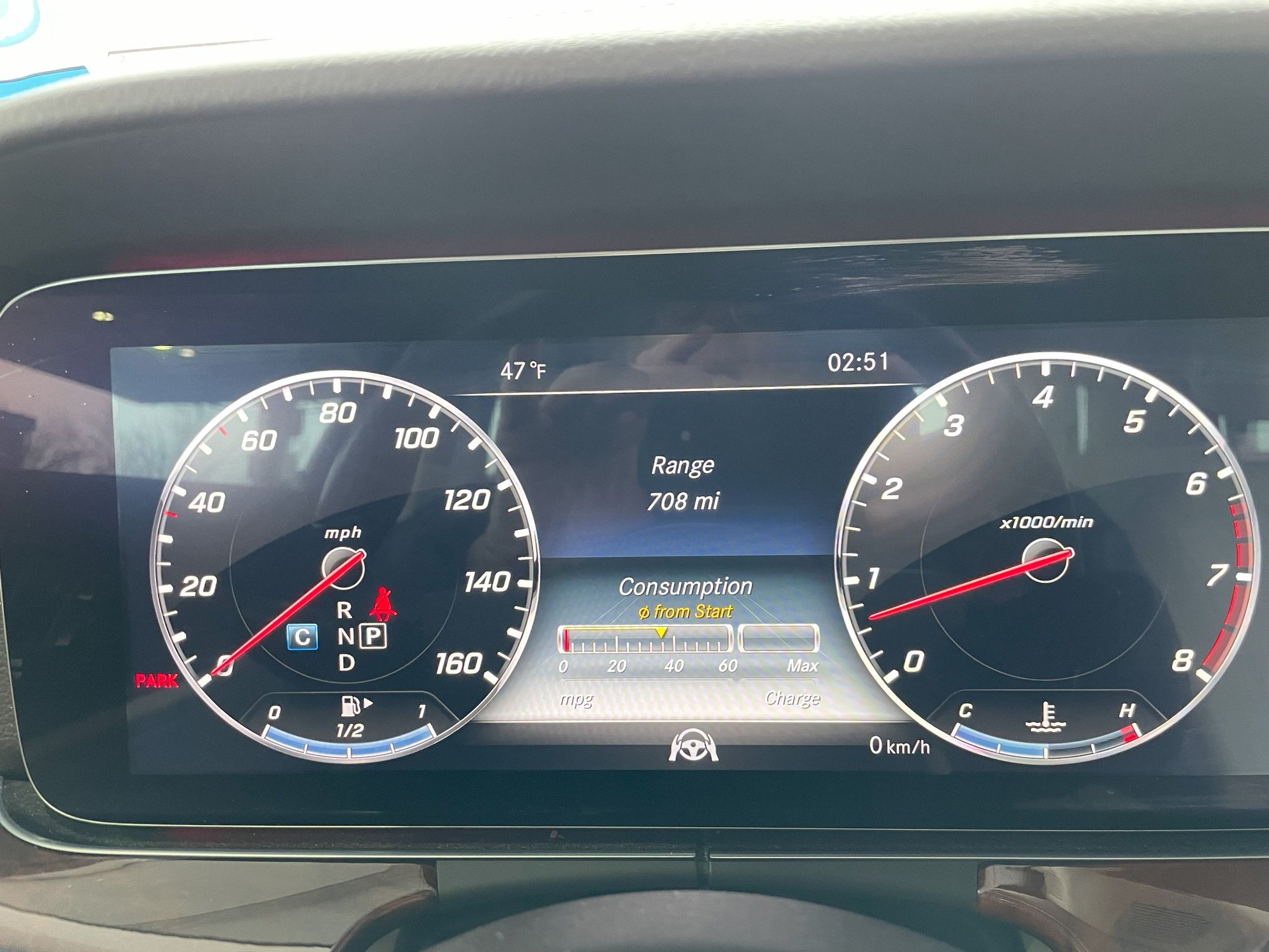

On Monday March 17 I drove from Long Island to Vermont. When I filled up in Springfield, Mass, I hit for me a new record an range: over 700 miles! that is about 35 mpg:
Temperature 47 degrees
Average speed 65 mph. This included local traffic plus driving on I -95 at about 70/75 mph
Tire pressure: 35 psi when cold
Tires: Pirelli Centurato P7 run flats
Gas: Costco regular
Weight: driver plus about 100 lbs of ski equipment
conditions: dry
