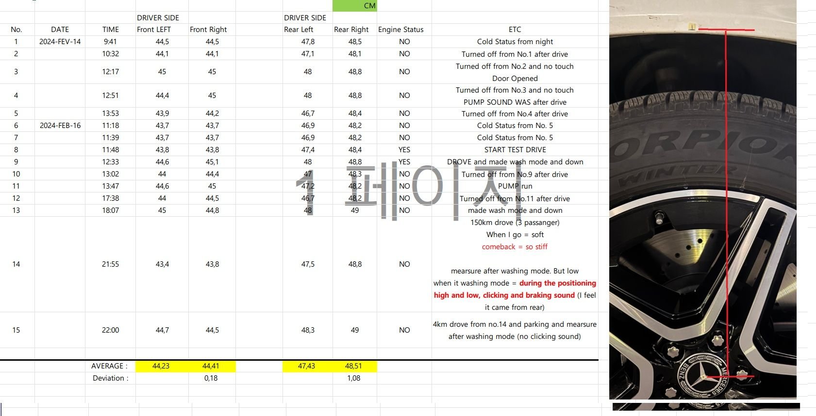

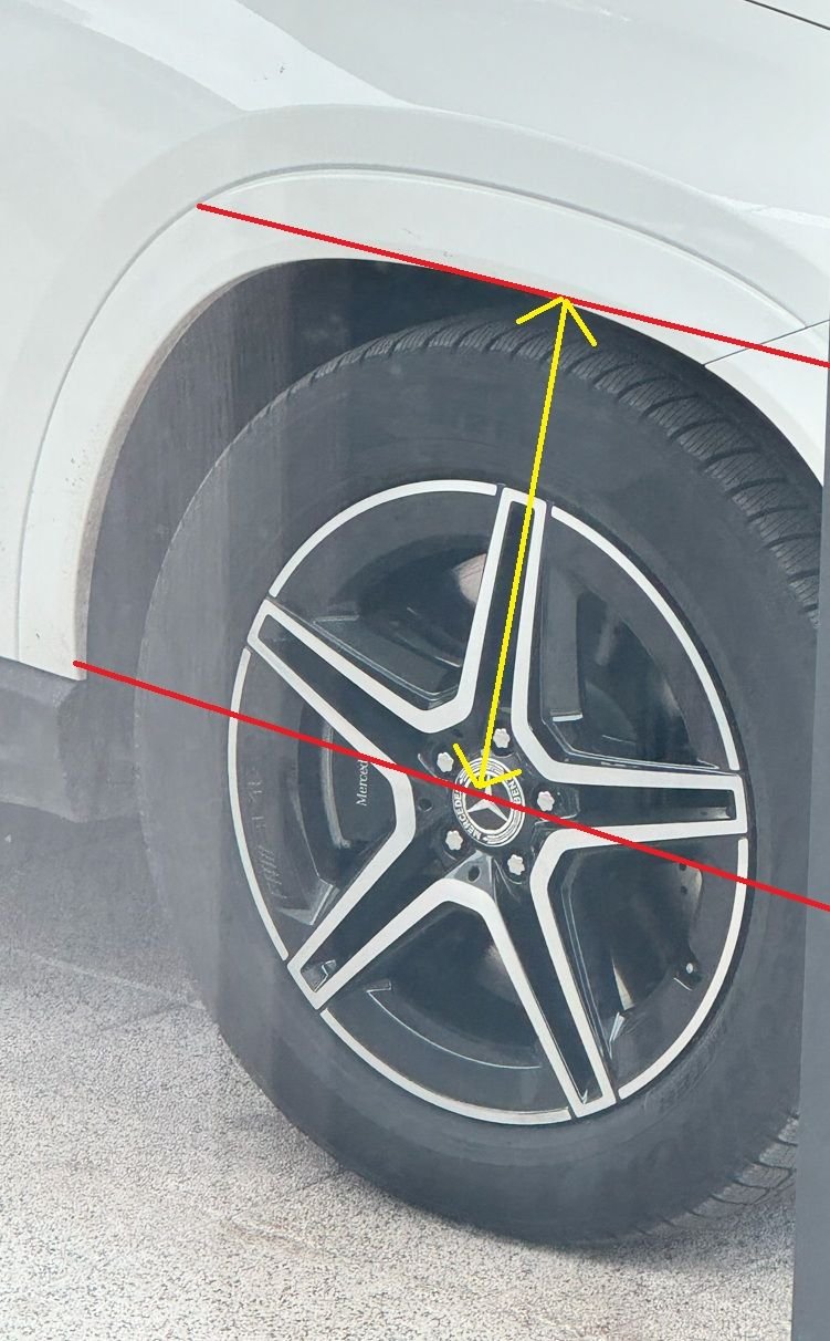

I measured the height this morning and it was roughly as follows.
FR45 cm, FL45 cm, RR48.8 cm, RL48 cm
After driving (about 22 km, city driving about 50 km/h ~ 70 km/h)
As soon as you park, open the driver's door, turn off the engine, and measure.
FR43.9 cm, FL44.2 cm, RR48.4 cm, RL46.7 cm
The measurement method was from the center of the wheel to the end of the wheelhouse.

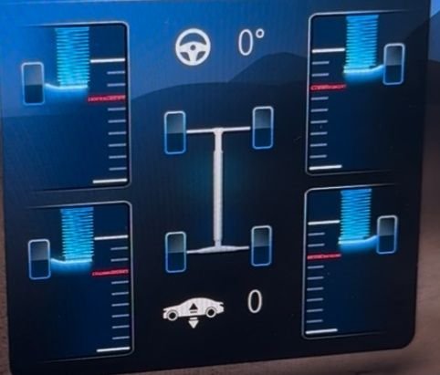

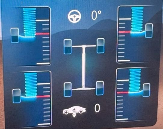

If I look at the OFFROAD program of MBUX, I can monitor the suspension,
While driving, the Suspention heighe is all lowered or only the front is lowered. (The front is particularly lowered, I don't know if it's height compensation..)

Yes. yesterday on my last drive, the suspention absorber on the mbux offroad utility was uncomfortable when it fell off the line between the red and white.
Then I lifted the vehicle with the switch and when the suspension on all four axles on the mbux offroad was on the red line, the ride was very comfortable for a while. Then when I drove, it fell off again.

I think about it carefully, there is a common characteristic...
Two days ago, I used the car wash mode and changed it to sports mode on the way home and it was very comfortable. (That's why I think sports mode is more comfortable and test drove with sports mode),
The ride quality of the 21-inch wheels was very uncomfortable, so I changed them to 22-inch wheels for a short test at a tire shop, and they were comfortable for next driving. (lifting up)
The 22-inch wheels became increasingly uncomfortable, so I bought 20-inch wheels and installed them, and they were very comfortable for next driving.(lifting up)
They all have the common feature of the ride quality returning when the suspension is extended and lowered.
I ll test more about it....

Originally Posted by HEKI82
Hello.
It seems to be exactly as written, but could you give me some more detailed advice on the error code? I just went to a private center and had it tested with a diagnostic tool to find the error code.
I mentioned earlier about a potential leak in the airbags of the Airmatic. This is the other side of the equation, which is the compressor that pumps up the air into the airbags of the airmatic, seems to have a problem, and the airbags are not being pumped up properly.

I submitted report as below via email.
Do I really have to go this far..
it is for It can be so broad in its problem solving that it's approached with the mindset of minimizing the harm to both parties, but they don't seem to think that way.
I am keeping quiet about what happened with them now,
but I am also a businessman, and I approach my work with my customers with a sense of solidarity that although it is difficult to determine the exact cause at least for now, we should work together to solve the cause when my costumers complaind
