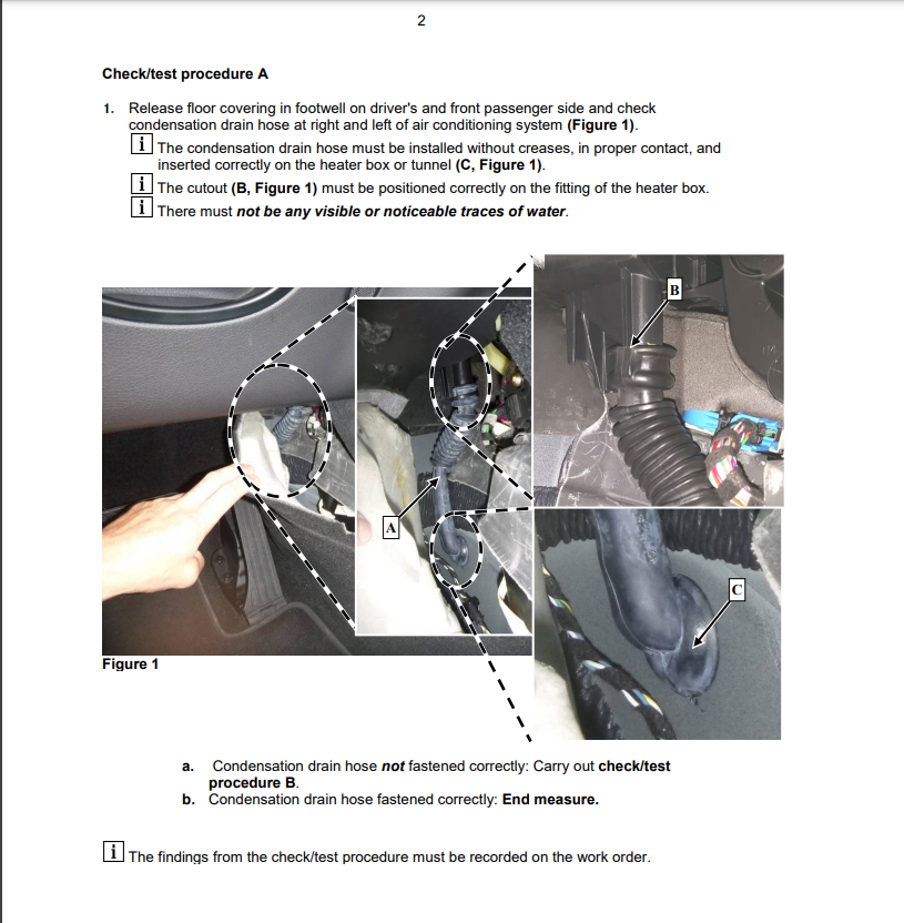

I want to start off by stating that my vehicle is not under warranty. I have a 2020 GLE and recently my screen went dead. I tried multiple things, which did not fix it. I took it to the dealership and thy found that there is water covering the MBUX control module in the front passenger seats. I have tuxmats installed in my vehicle and the dealer states that water was going through the tuxmats and onto the control module.
However, I am pretty sure the dealership is lying because I have never really had any water spill into the front passenger area. I definitely feel like it is related to the AC line drainage recall in this vehicle. My vehicle had the recall performed about a few years ago, but I have read instances where the AC drainage kink reoccurred. I really feel this is due to the AC line issue and I am not buying the dealerships story about the mats. It honestly does not make any sense.
The dealership wants me to charge me close to 7k to have the module change. They also stated theres a possibility that that may not fix the issue as other connectors may need to be replaced secondary to water damage. I think this is absolutely criminal to charge this much for this as I think ultimately this is a manufacturing fault. Anyone have recommend next steps I can take? My vehicle is not under warranty, but it was CPO and CPO ended about 3 months ago.

Show them the recall and the paperwork that showed that they did the recall work. If they inspected the AC drain and found a problem that required repair, you probably have a case. If they found no evidence of leaking from the drain hose, you might have more difficult proving that it was a Mercedes caused fault. Even then, your dealer should kick this up the chain to cover the repair.

Interesting. I do not have a GLE but found some info online. https://static.nhtsa.gov/odi/rcl/202...1V288-5461.pdf

thanks for sharing this. I had this same issue with my car, they tried to claim a water bottle caused the leak and shortage. Doing further research, I saw others that issues. The dealership claimed they had never heard of the issue or the recall. And when I contacted Mercedes they said my car wasn’t part of the recall as it was produced in October or 2020. The repairs were over 7k. Any advice or anyone else who knows more on this issue your help would be appreciated!
