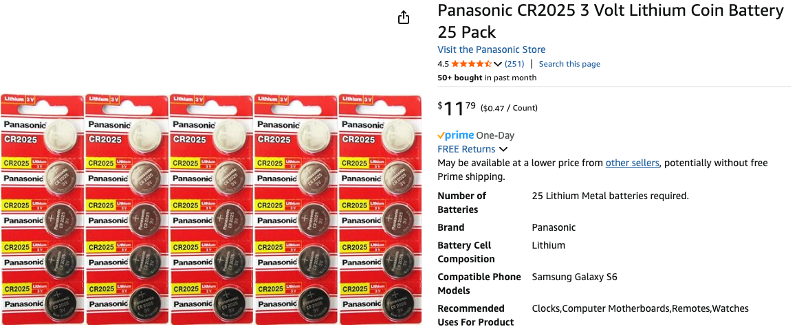

What brand of battery is being used. A similar problem was discussed elsewhere on these forums. The consensus is that, for whatever reason, the battery brand made a difference and Panasonic was the brand to get. I have done that and it seems to work for me. Honestly, getting a bunch and changing them out is a lot easier than going to the dealer, etc.
Old Apr 15, 2025 | 08:03 AM
W205C43PFL's Avatar
Posts: 32,217
Likes: 6,275
The bitter coating

I have been using my main key only. Testing the spare key will take another 4 to 6 weeks. For now, I will lock my car and keep the key 50 feet from the garage to test this theory, especially if there are changes in the 2025 model (unlikely). If it still fails, I will switch to my spare key to test.
Old Apr 15, 2025 | 08:58 AM
keyfob's Avatar
Joined: Apr 2025
Posts: 9
GLE 350 4matic
I don't remember what brand I used for the first two times. Probably Duracell. For the next two times the battery was replaced by the dealer. Presumably, they use something reasonable.
Old Apr 15, 2025 | 09:02 AM
W205C43PFL's Avatar
Posts: 32,217
Likes: 6,275
Do that (lock and away) but with the spare key, no need to go through testing let's just say it was the main key being broken after all, so use the spare key right away to save you from the frustration.
Old Apr 15, 2025 | 09:04 AM
W205C43PFL's Avatar
Posts: 32,217
Likes: 6,275
If you viewed the other thread linked, there is a part number with a Mercedes Original sticker, yet you can clearly see the actual battery brand is Panasonic. Worth a shot, except if the MB dealership replaced it and supposingly they should be using Genuine parts, it should be the Panasonic one anyways. I mean, it is easy to check. Remove the cover and let us know if they put a Panasonic one in.
