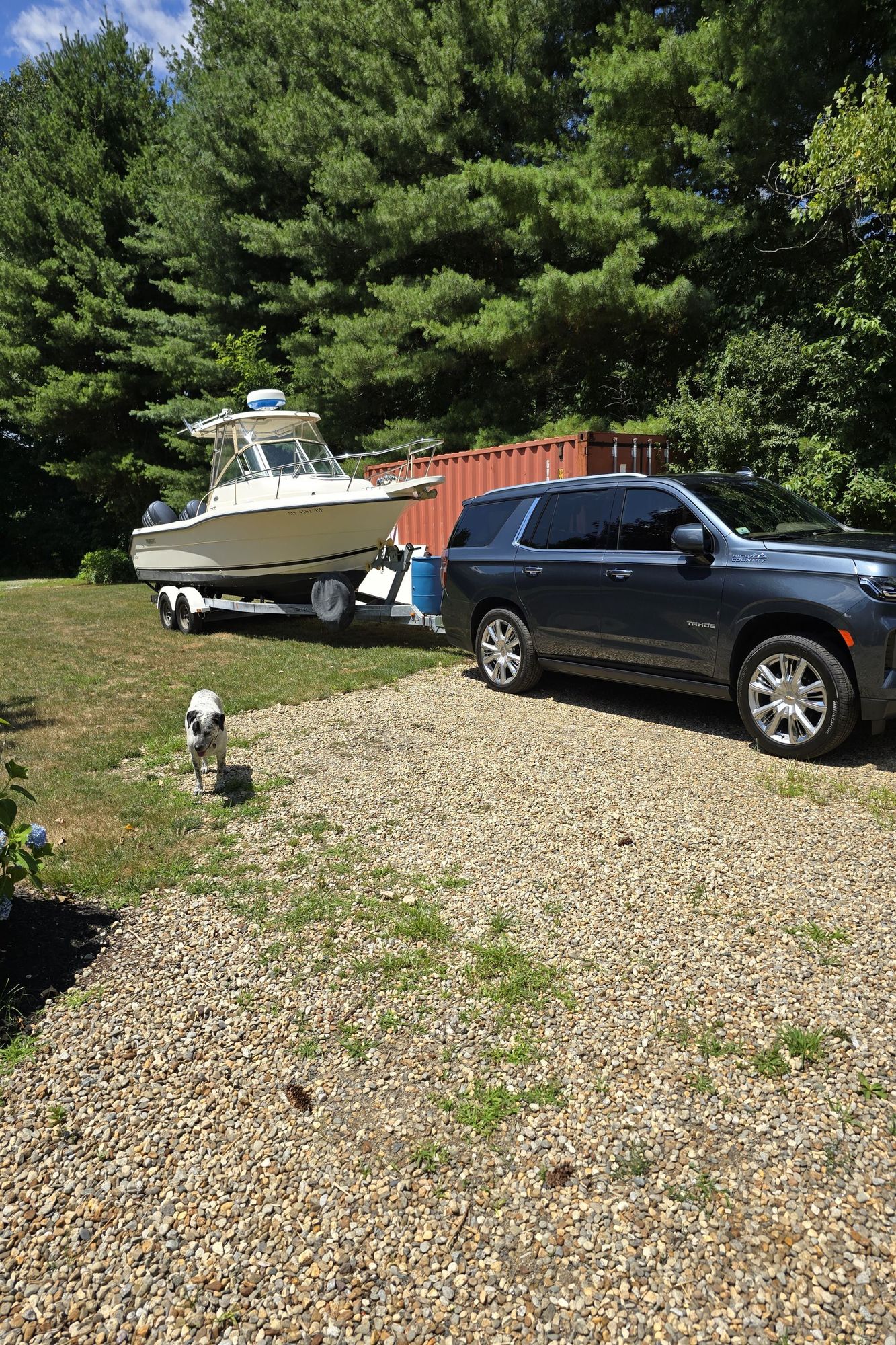

I am considering getting rid of the Tahoe for a GLE-450e. I like the hybrid but I need to be able to tow our Pursuit 2470WA. We drop it in about 15mi from our house, mostly highway and fairly flat route. I plopped 1K on one but am wondering if I should look for a GLE-450e with Airmatic instead of the standard suspension? The boat weights about 6700lbs tongue weight is 600lbs with water fuel and trailer. I'd hate to get the GLE and find out the front end is light when towing
tahoe, pepper, and boat for perspective
. My first tow vehicle was a Chevy Colorado which held its own but I would get a bit of hobby horsing.
Have you asked the dealer? Do they have a GLE with an OEM hitch you could hook your boat up to?The factory-installed Class III trailer hitch on the 2025 Mercedes-Benz GLE 450e 4MATIC® SUV is rated for a maximum towing capacity of 7,700 pounds and a maximum tongue weight of 770 pounds when properly equipped. (search result)
Two thoughts about your airmatic question. Even if not needed for your short tow it's a nice feature to have for other situations as well. But if you don't want to spend the money, 15 mi is a short tow, that could be done slow and easy so the airmatic would not be critical.

The Tahoe weighs about 1500 pounds more than the GLE, that's a lot of boat to pull with a car.
Airmatic doesn't affect weight transfer - it just reduces squat. In other words, the handling and front end steering grip will be approximately the same with either suspension.
However, a 6,700 pound trailer of any sort, with only 600# tongue is on the light side, inviting sway, no matter the capacity to the tow vehicle. Rule of thumb is 10-15% an you are at @9% (I'm fine at 10% with either steel springs or Airmatic), so I'd make sure you don't upset that ratio by loading the rear of the boat and having a lower percentage of tongue to gross weight.
The GLE is a far better tow vehicle than a Tahoe, because of the stronger, stiffer unibody construction, modern suspension and real brakes. GLE brakes are bigger than a 3/4T Chevy. And it has a built-in "tow package," with HD cooling & electrics, plus a Tow-Haul mode changing shift/engine mapping and light-out detection when towing. That's IF you get the factory hitch.
You'll be fine IF you pay attention to loading. With either spec.
(That is, if the 450e tow capacity really IS 7700/700#, which I haven't verified.)
