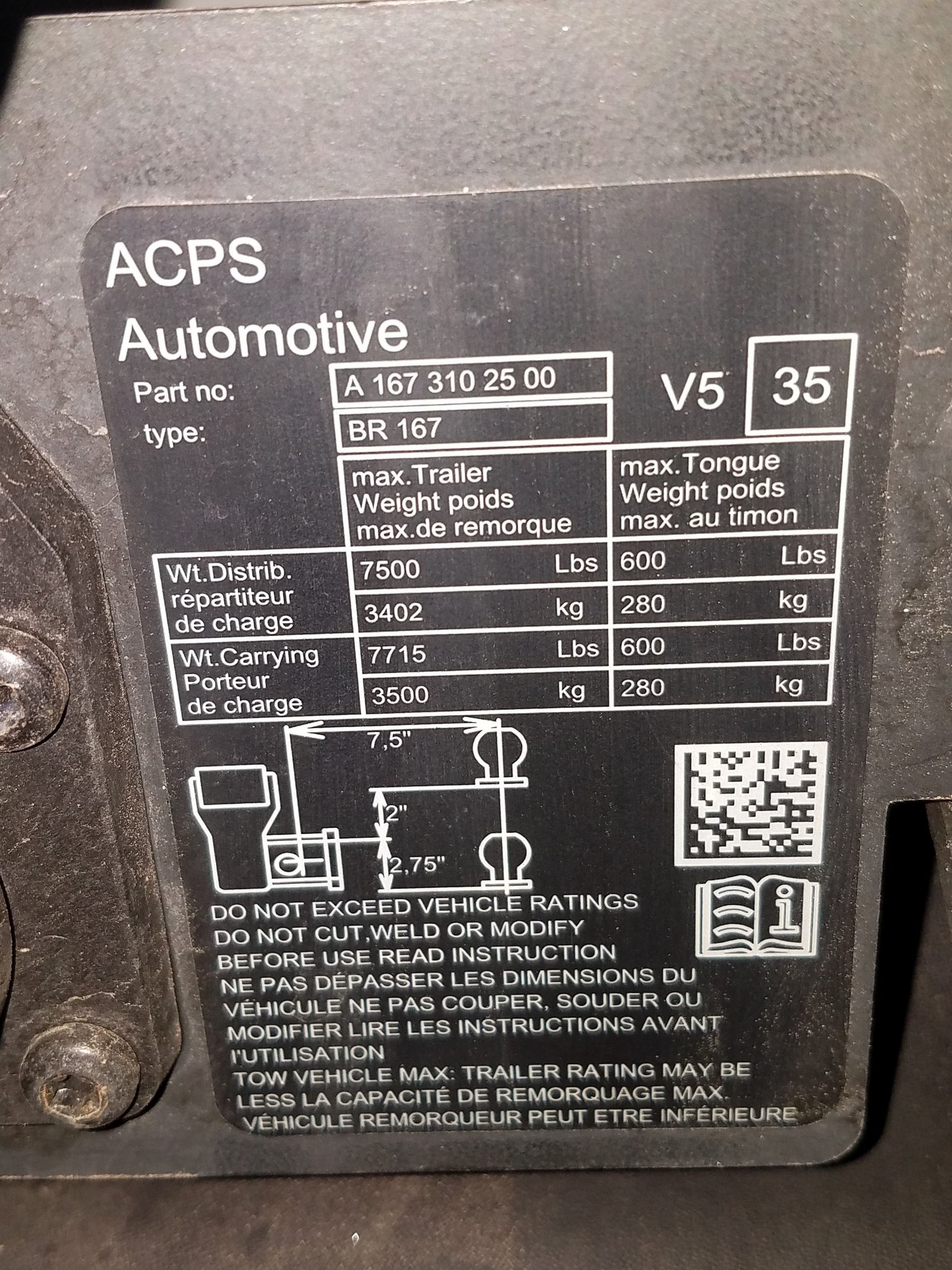

I have a 2024 GLE with a factory installed tow hitch. I got her about 6 or 8 months ago after boat season. Today when I went to attach my boat trailer to it, the receiver wouldn't accept 2x2 tongue that I was using on my previous vehicle. Tried white lithium tried Vaseline tried all kinds of things but it would only go in so far. After careful inspection, it appears the receiver tapers in the back. Even though it's probably about 4 to 5 in of length only the first two is usable. This is pretty significant problem since I can't pin anything to the hitch because it won't go in far enough. I have a call into my local' MB parts department to figure out if this is just how the factory installs them or if this is some kind of odd whoopsie at the factory. Thought I would check here before I drug myself to the dealer.

I couldn't get a brand new hitch into our W164 receiver when it was also new (was only a few mm from being in position), but a used one went in just fine. After being used a couple times the new hitch also fit with no issues. Our GLS had no such issues. Have the dealer fix, it likely just needs some paint removed.

Originally Posted by MI MB580
No, it's not the correct one. It appears to be one for a Euro hitch, even though it says US spec.
The odd thing is that, when searching MB parts US online stores, they all show the same part. It just won't fit a 2-in receiver.
I use a Reese ball mount that matches the requirements shown on the label on the actual hitch.
It took some doing to get it to insert fully, so I just kept at it until the paint wore off.
I had a different ball mount that fought me all the time until I removed its label. I was stymied by a piece of paper!

The 167 hitch is made in the US. As was the 164 and 166 (not German). All my ball mounts fit my 167. Reese, Draw-tite, Curt, my 166 factory stinger, and my (German) Cayenne OE factory one.
They are all tight until the paint wears off.
Bare metal is a good thing, because it adds another ground point, in addition to the 4/5/7 pin connector.

​​​​​​​A wire wheel on a dremel should be all you needed. I tried a sledge on our w164 to get the new hitch to fit, nearly had to tie it to a building to remove it after that. A few uses later with the older hitch though and the new one magically fit like it's supposed to. There couldn't have been much but apparently a mm or two of paint made it very difficult to insert fully.

My GLE's hitch did not had a problem. Straight from the factory. If it is clearly bent don't do anything to it and let the dealer fix it. If it is just paint, well it is just virgin tight and ram that thing like it is it's first time .
