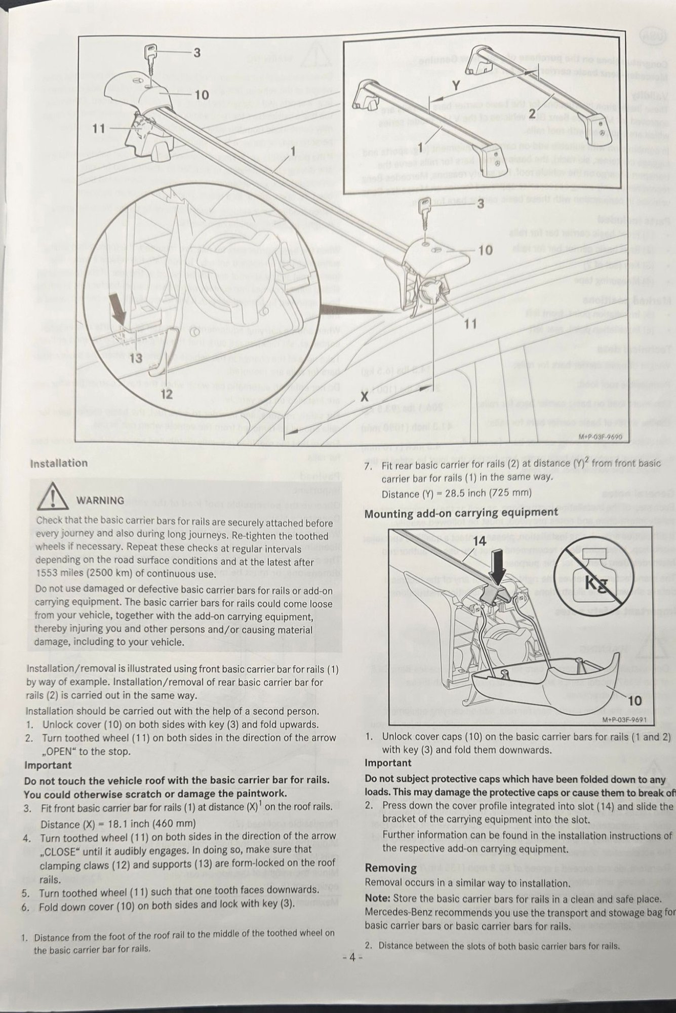

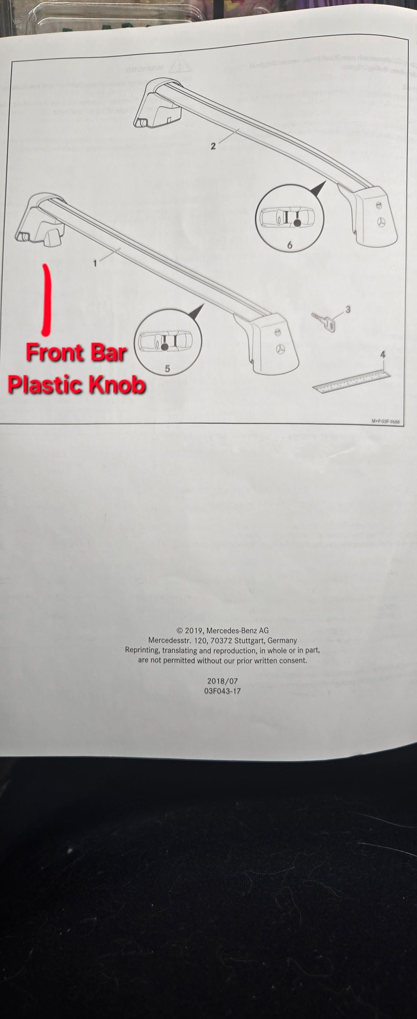

Imstallation was a breeze. There are no tools required since there are knobs that you can easily adjust to install or remove them.
One of the OEM crossbars come with some rubber stops for the moonroof, so that one has to be installed at the fornt, while the other at the back.
The rails on tue GLE, where you install the cross bars, are not parallel, it is wider on the front and narrower on the back, so you need to be careful when you install any crossbar. The crossbars will not fit in the places where it is too narrow.

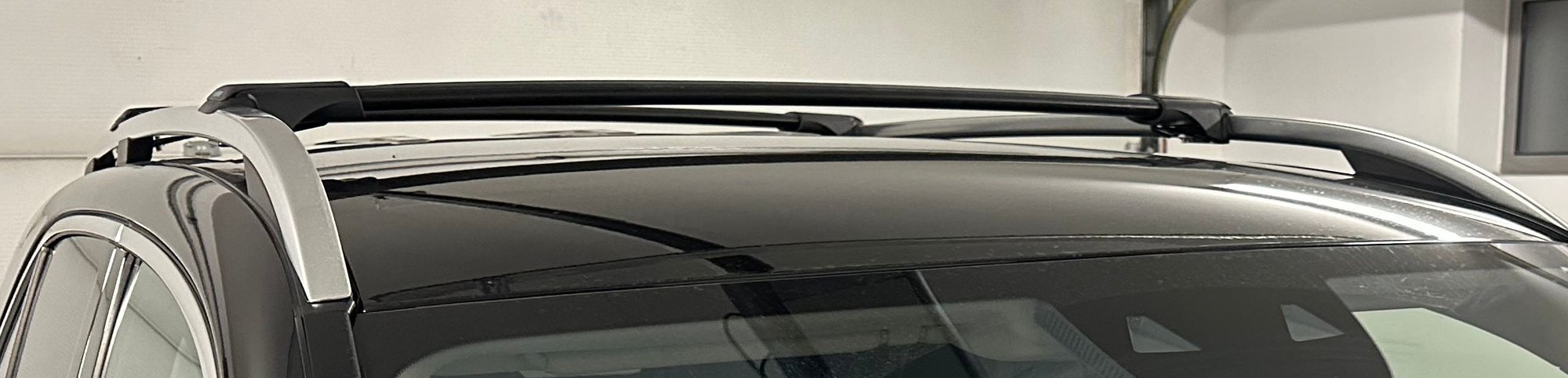

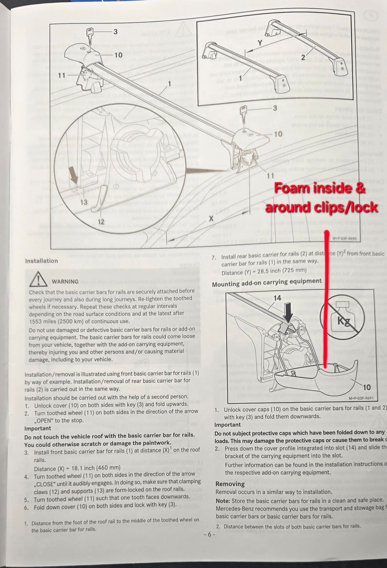

When I fist took a test drive, they were noisy, so I put some foam inside the lockable covers, whiich really cut the moise and whistling.
Then, I put some 1/4" x 25' Elastic Cord, as shown in the picture, and the wind noise went away ans is very quiet until I reach 55 mph, and then you can barely start hearing some wind noise and at 80 mph you can hear some wind noise, but you can still talk normally so its not bad at all. If course, if there high wind, you will be hearing wind noise earlier, but not bad at all, and a lot less than the one in my Porsche SUV.
The crossbars have to be 28.5" from each other, and there are instructions on where to place them and their separation too. Make sure the thick part of the bars point to the front,as described in the manual.
I am very satisfied with my OEM crossbars and the very low noise with them after my adjustments.. I am sure, you can do similar things with your non-OEM crossbars.

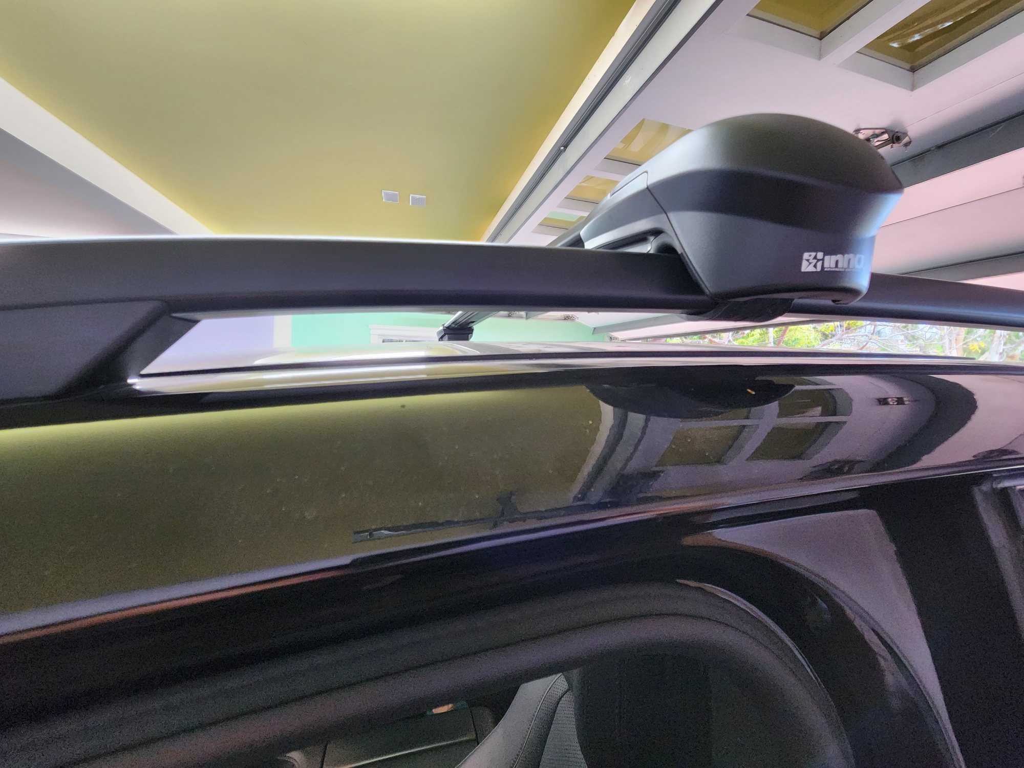

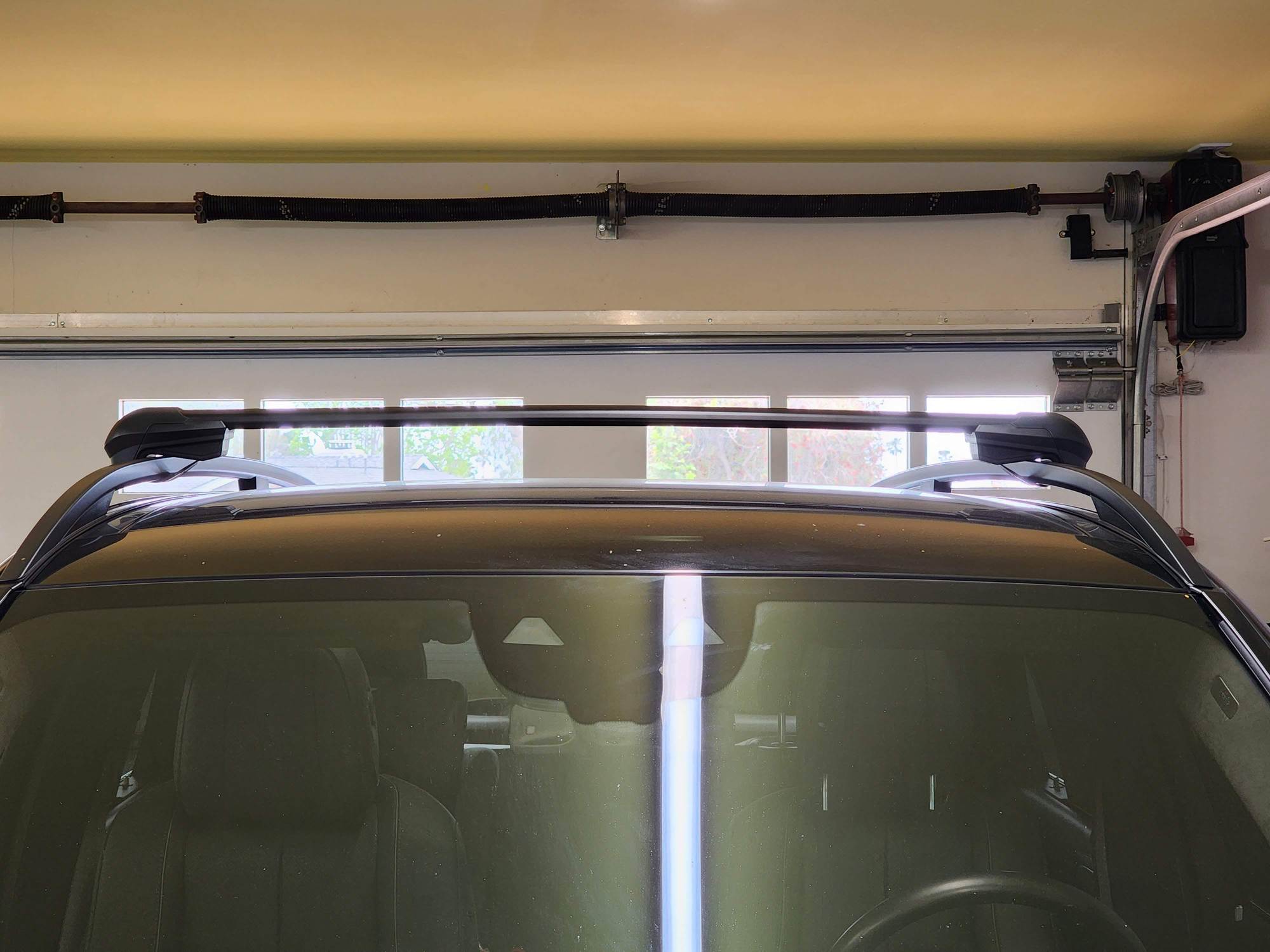

I'm happy with my inno crossbars. What I really like about them is the ease of putting them on and off. Takes less than 5min so wind noise is never an ongoing issue as they are so easy to throw on and remove when not used.

I have the 42" and 45" Inno bars here:
https://a.co/d/8Yu3BsK
Sunroof operates just fine.
