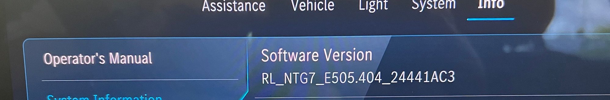

I downloaded this version and installed it via USB last month. Appears to be newer.

Well THAT's interesting. My version, 2026 (V25.0) is all that shows on the Me.Mercedes website.
I wonder if your newer 2024 car gets the different version 2026 (V26.0). My 2021 MBUX software version is apilevel/ntg6/081. I think they "streamlined" MBUX the following year, 2022.
I'll have to go out to see if the version on the car is actually V25.
2021 GLE 53 AMG
2021 GLE 53 AMG
Does anyone have more info on these various versions?

That must be it. I have a different software version.

OP has the pre-facelift, so different mbux version altogether yours is MBUX 2.0 and his is MBUX 1.0 : )
