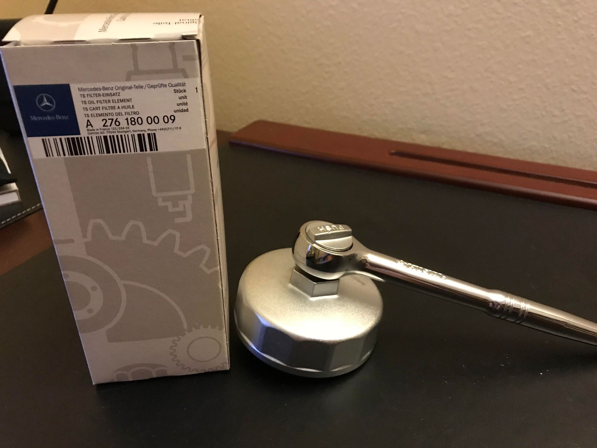

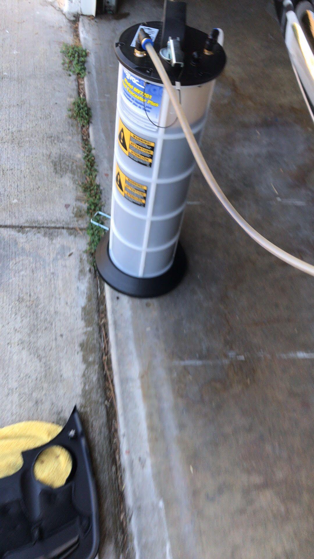

Hell everyone, just wanted to share that this past weekend I've successfully done my 1st oil change. I'm so glad I did it. Very easy and no mess process. I used the 7201 Plus Mityak extractor plus tons of youtube learning. This is definitely worth it.
The hardest part, oh well, is resetting the light, but I finally figured out you gotta switch to "1" and follow the instruction. How easy it is. But guess what, I am confident about my baby and how wonderful feels that I could take care and use the best oil, best filter and most importantly the learning process.

Thanks for sharing. How many quarts? Where did you get the fluid extractor, oil wrench etc? How much?

CLK320
On my GLE 43 I extract out 7 liters, not sure if you open the drain plug will get more out.
Got everything from amazon.
The wrench tool to open the cap -
Amazon Amazon
Extractor -
Amazon Amazon
Filter -
Amazon Amazon
that's a dealer.
Yes, I extracted out about 7 L as well. (as supposed to 7.5L that should be). I think the GLE burns a bit oil over time.
