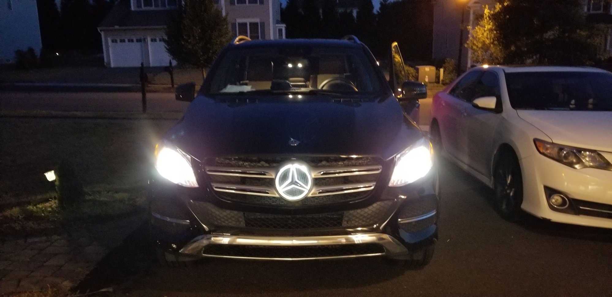

I also purchased aftermarket and just did mine today. Took about 2 hours installing is not hard. Just finding the positive wire took a while and wiring. Here is my results.

It depends on your Technician where he wire to. I wired mine into the headlights so whenever the headlights are on it also turned on automatic. It make sense to light only on night instead daytime. At Daytime you can't really see them unless you have LED super bright but that will drained your fuses.
That actually looks better than i thought it would. Its nice and clean for after market.
Yep. Let me know if you need any help on wiring. The positive wire should be color code Gray with white strap.
