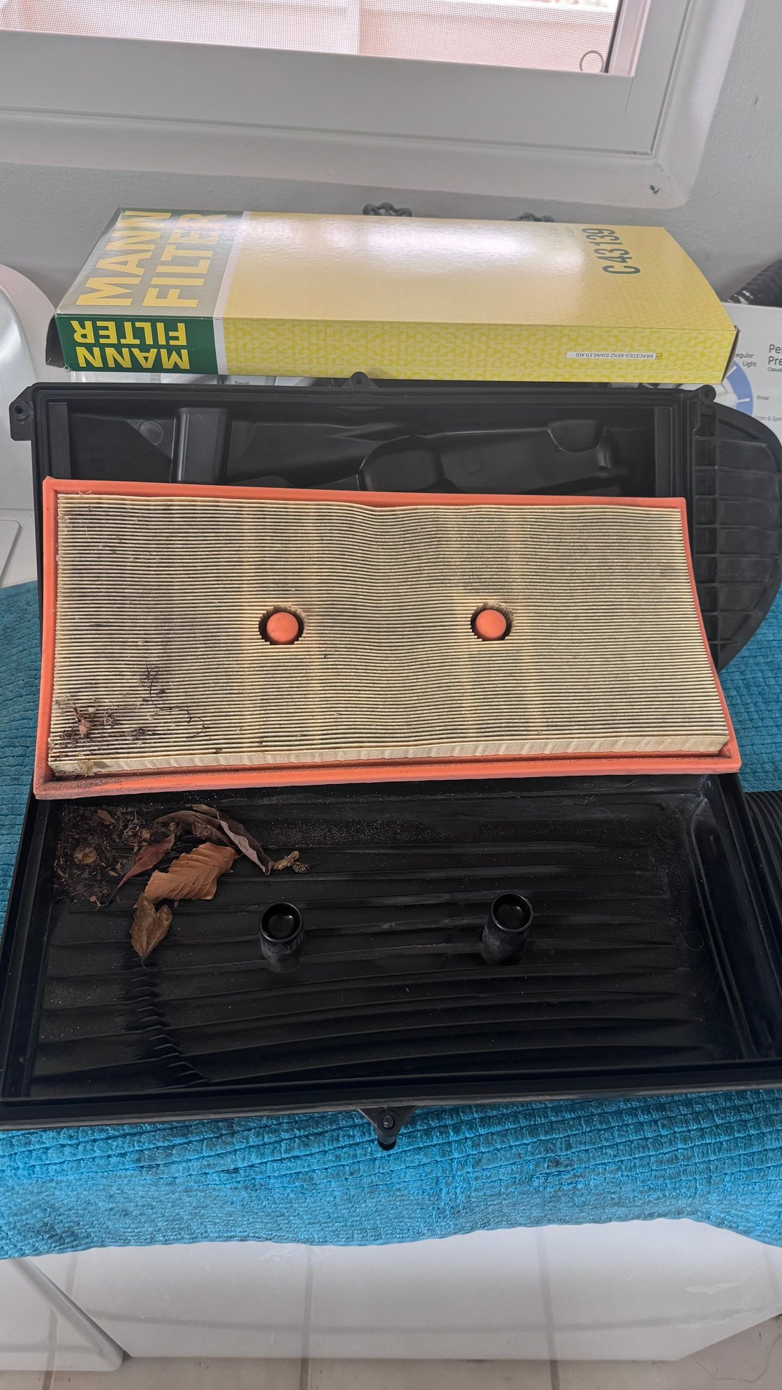

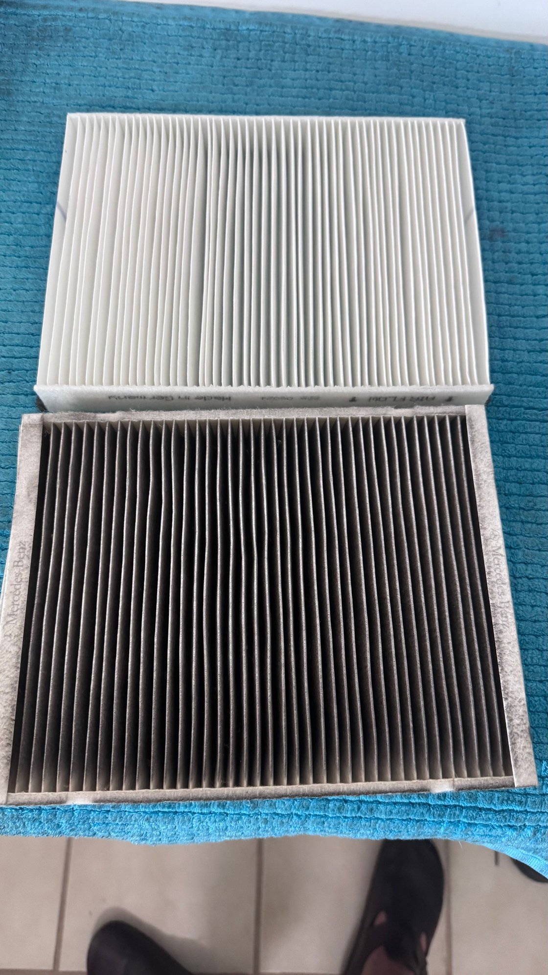

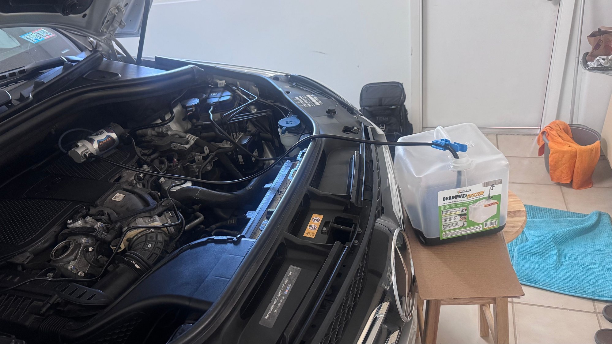

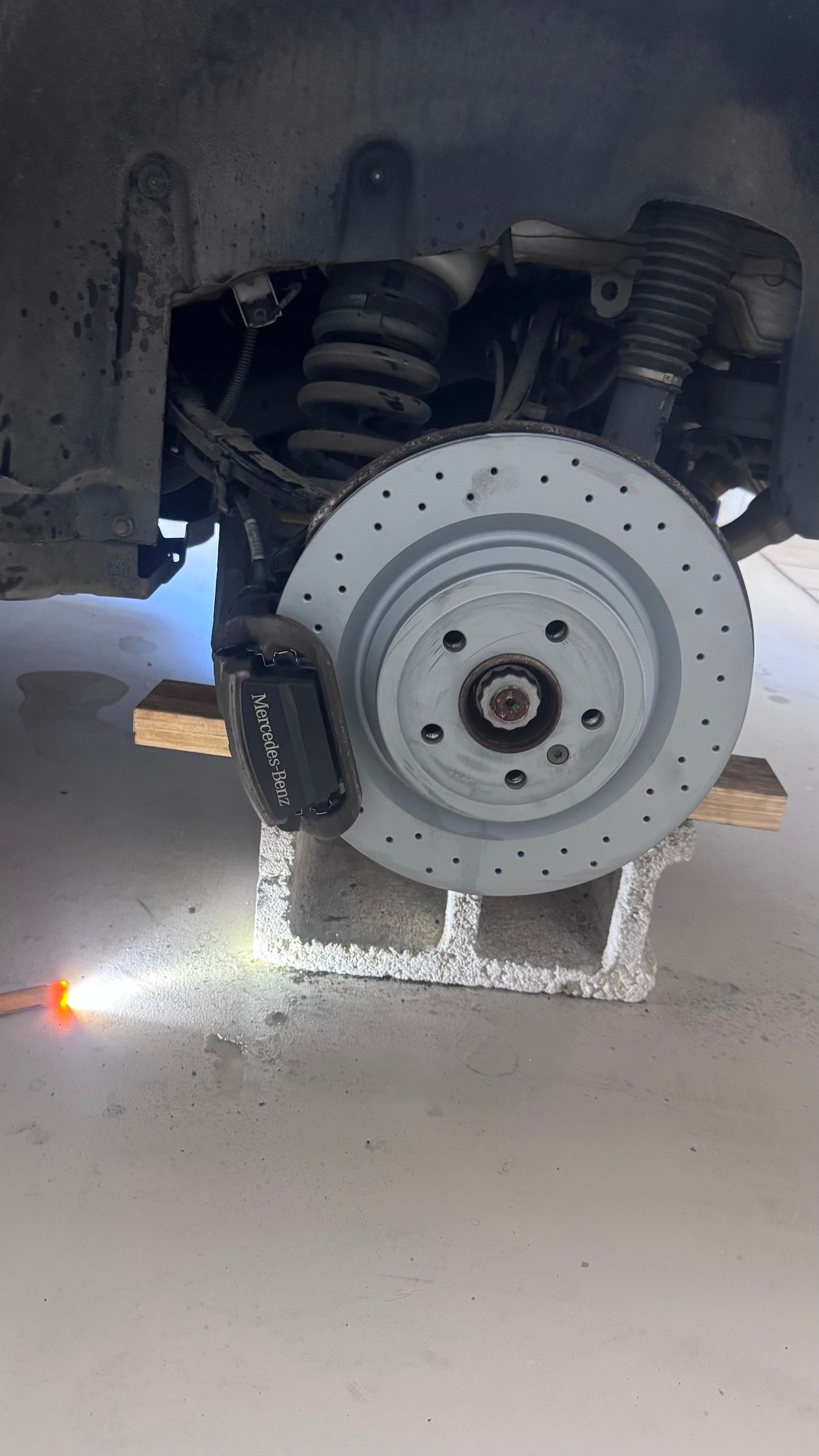

Ownership Update – 2018 Mercedes-Benz GLE 350 4MATIC
Just passed the 90,000-mile mark and the car continues to perform flawlessly — no mechanical issues to report.
Recent Maintenance:
  • Rear brake discs and pads replaced
  • Front brake pads replaced
  • Air filter and cabin filters changed as part of regular service
  • Engine oil and filter consistently changed every 7,000 miles
Upcoming Service:
  • Transmission service (finally!) is scheduled for the end of the month — long overdue, admittedly.
Other Notes:
  • Tires will need replacing soon; the current set has lasted a solid 36,000 miles.
  • Still love this car. It’s been incredibly reliable, comfortable, and enjoyable to drive.
Zimmermann Brake Discs and Pads
Oil change every 7000 Miles

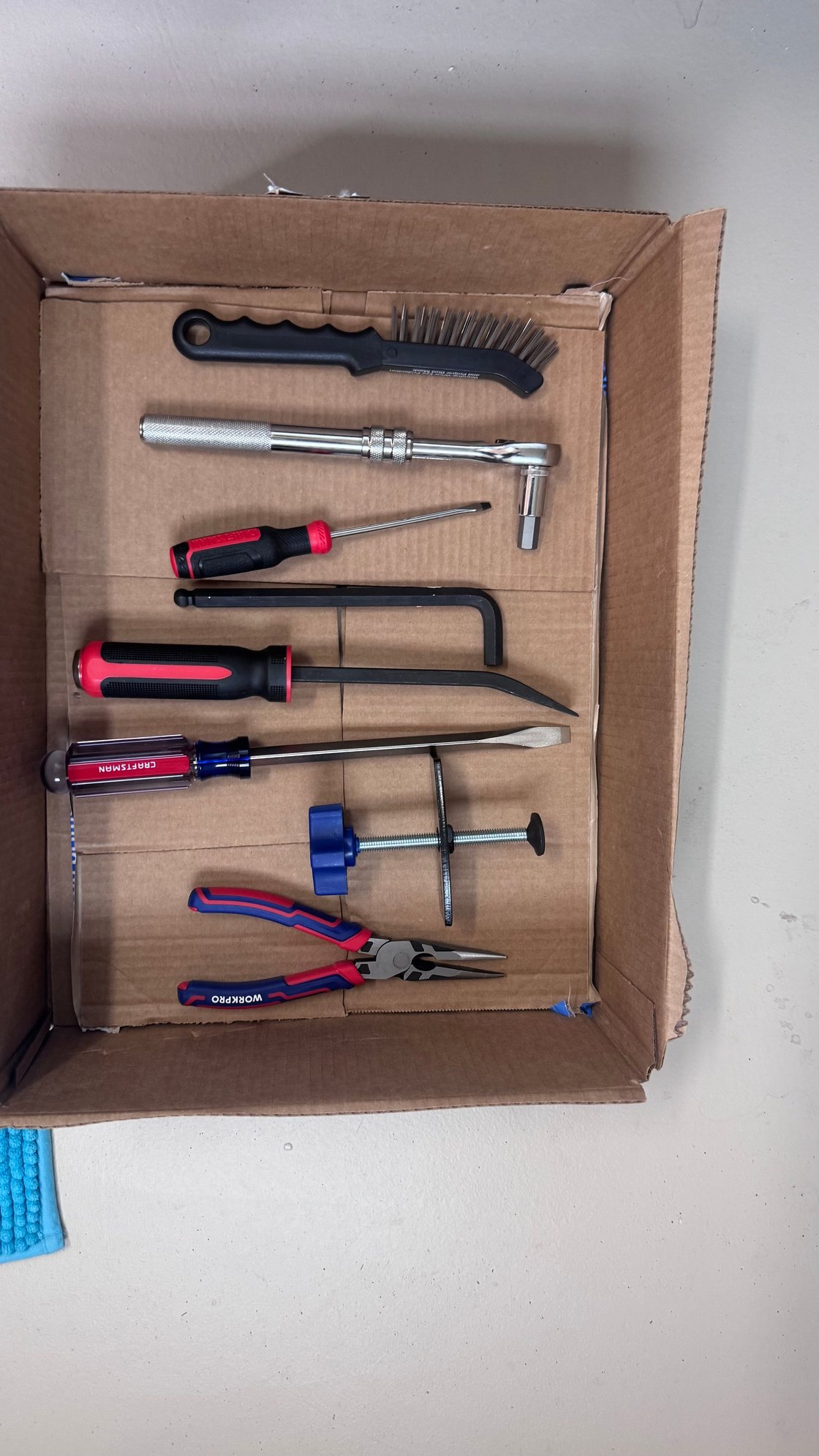

96k miles now.
Changed the poly-v belt today. Easiest job ever. It took 20 minutes including fetching tools and putting them away, and I really took my time. Poly-v belt replacement is not a recommended maintenance item by MB, I chose to replace it because I wanted to do it. The new belt should be good for more than 100k more miles.
There is really not much to say. 17mm socket to release belt tension, use a 4mm allen key to lock the tensioner in the released position. Pull old belt off, put new belt on, release tensioner tension, remove allen key, and ease tensioner onto belt. Done.
No codes, no XENTRY, very easy. The engine sounds like it runs a bit quieter with the soft new belt that is a bit shorter than the hard stretched belt with 96k miles. I kept the old belt as a spare.
Tools:
1/2" ratchet drive
17mm socket
4mm allen key
thin flat screwdriver to release the intake s-duct
Parts:
Belt 003-993-57-96 $47+tax in stock at the local dealer
I didn't use this video, but it is a good guide for the M276 3.5L NA.

1/2" ratchet drive, 17mm socket, flat screwdriver and 4mm allen key
