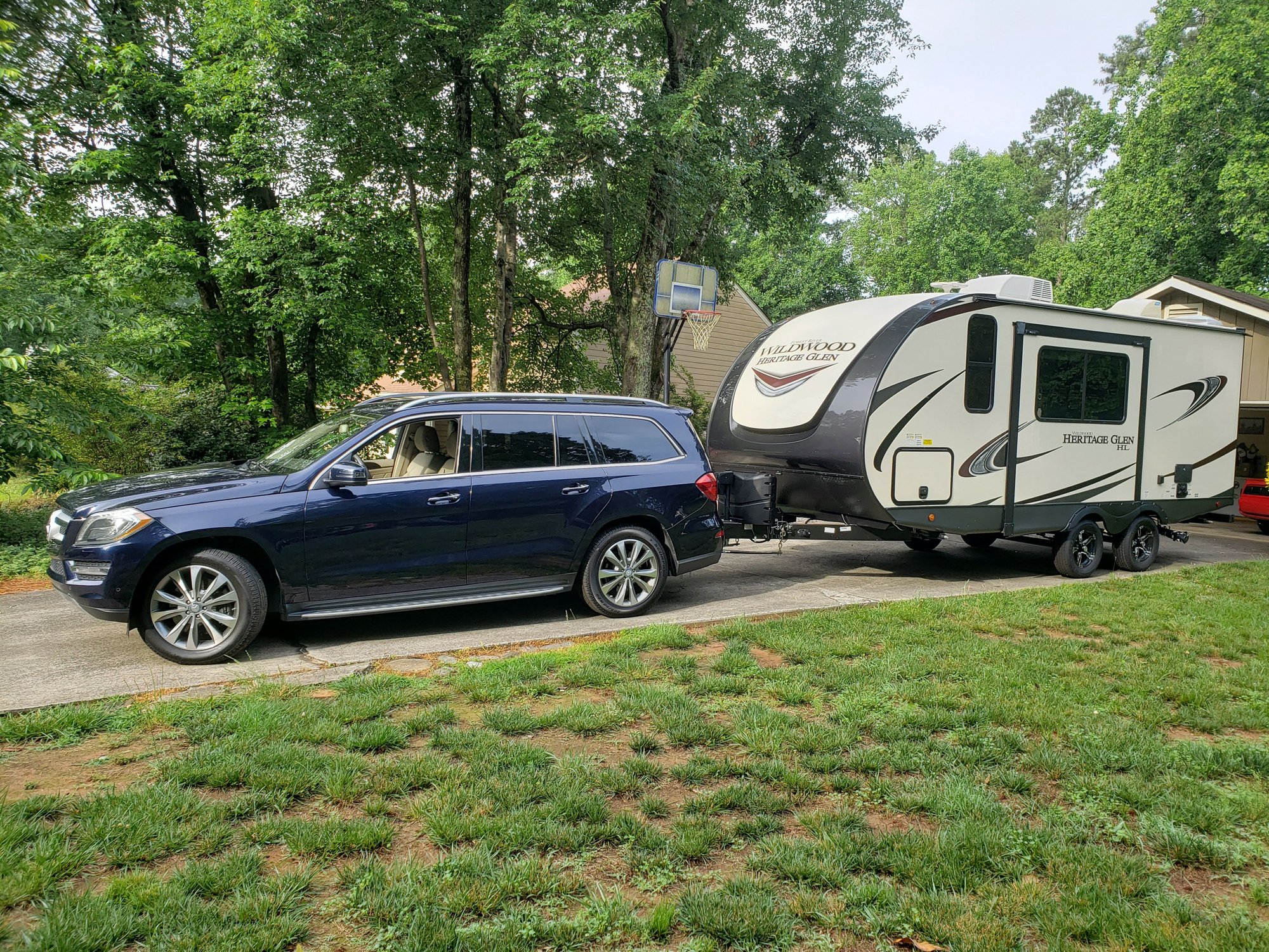

John, I've got to say that your posts did a lot of good for me. I got set up this week and did a shakedown cruise rgis morning. Amazing!
Of course the GL is a tank but with the brake controller and the WD hitch working well, it drove like a dream.
Thanks again, sir!
