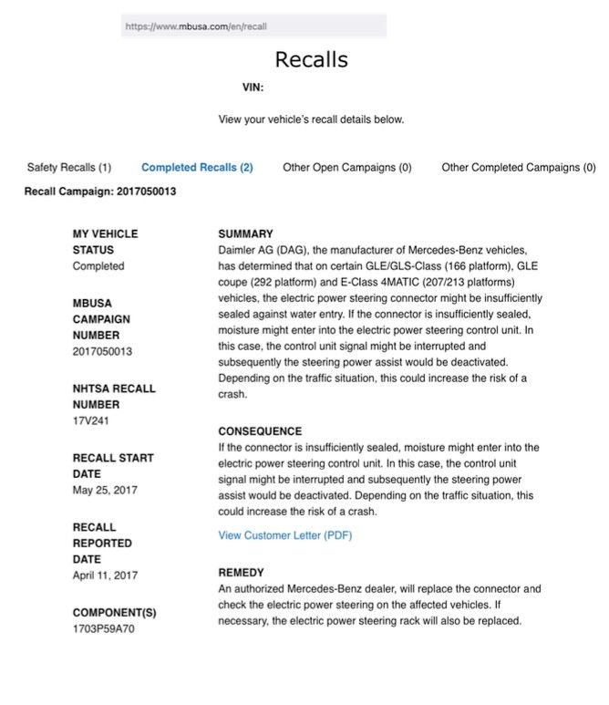

There was a safety recall to correct a connector that might not be sealed completely against moisture. The recall campaign was 2017050013. If you've not had that done, you should look into it. You can enter your VIN to see whether it applies to your vehicle at https://www.mbusa.com/en/recall.

I think I had the dealer take care of recall a few years ago .
