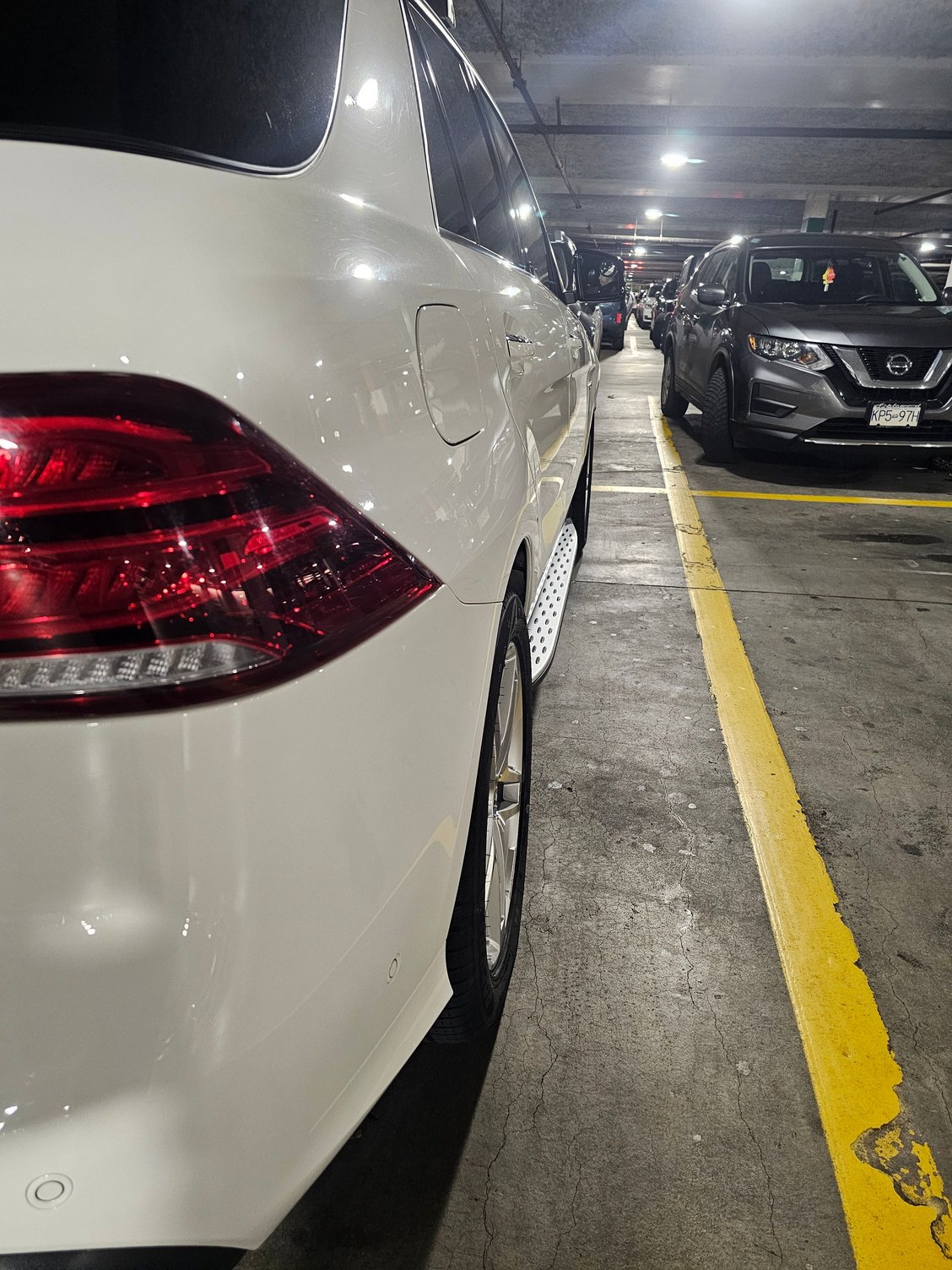

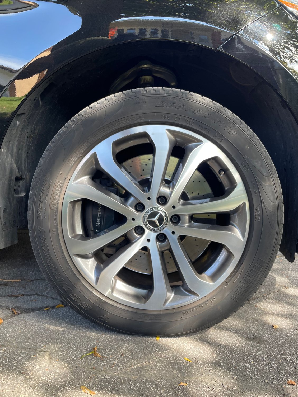

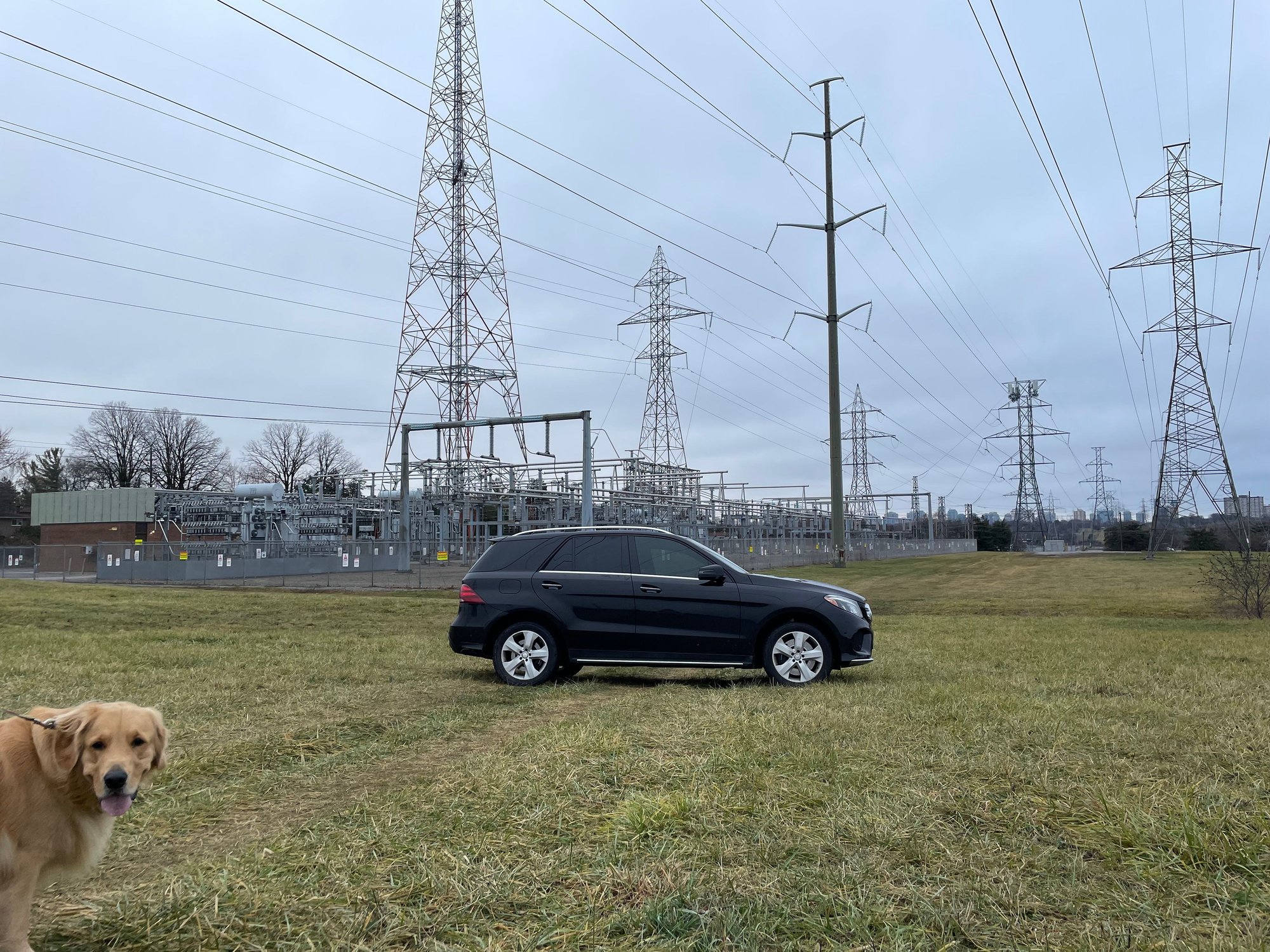

Sorry I don't know how to make these pictures smaller. The pic with my dog is a set of OEM 19s off an ML, and the other pic is of the factory 19s. I only have the Premium Package so no AMG goodies, but the rotors are the larger 43 AMG size based on the replacement rotors I bought.
Edit: I checked my purchase history and can confirm that I ordered up 375/345mm front/rear rotors that matched my factory rotors.

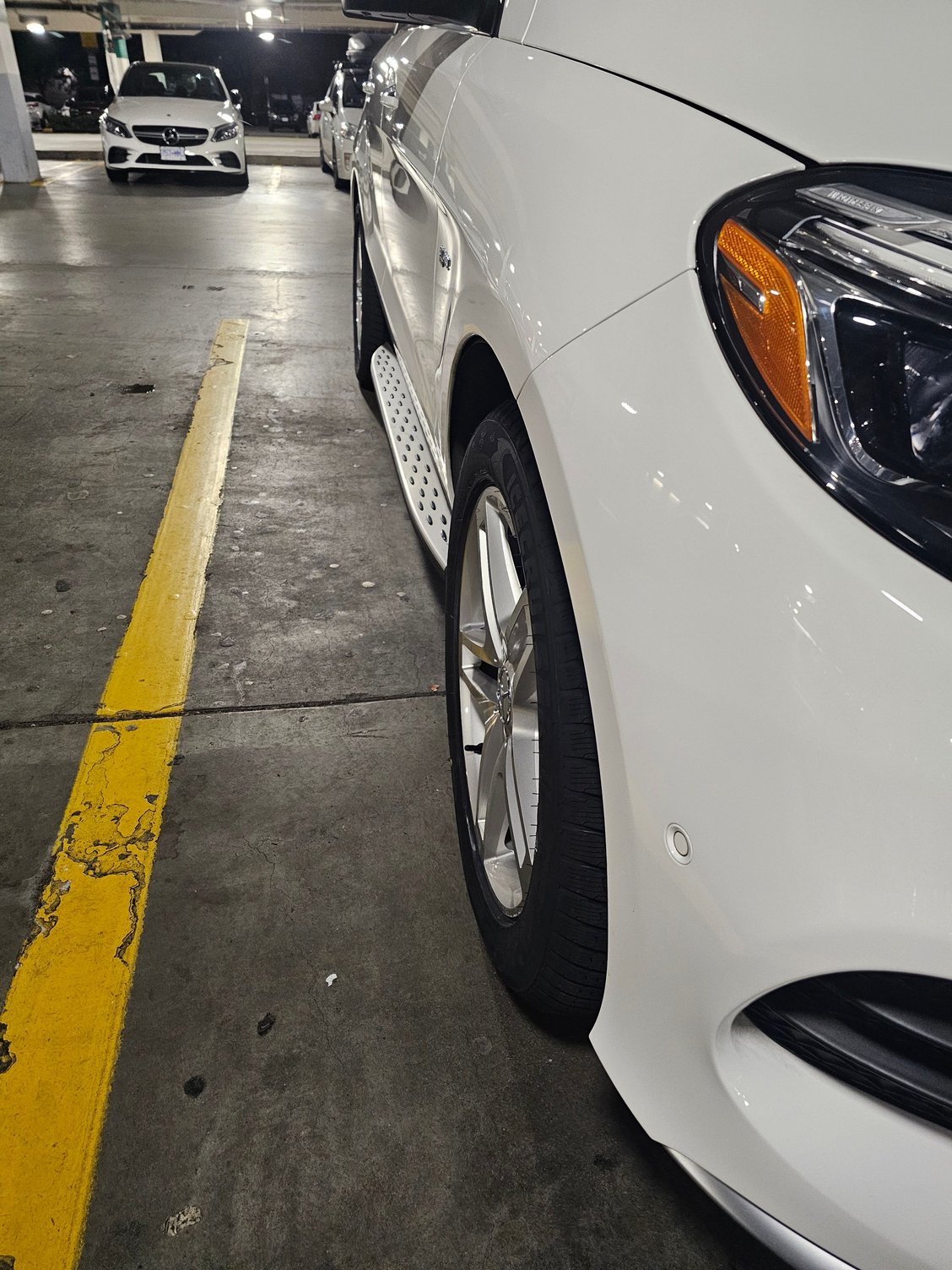

Only a little? Here's a pic I took of a 43 AMG (non-coupe) when I was double checking my rotor size. It's on the factory 20s and the caliper-wheel clearance looks just a tad bigger than my setup.

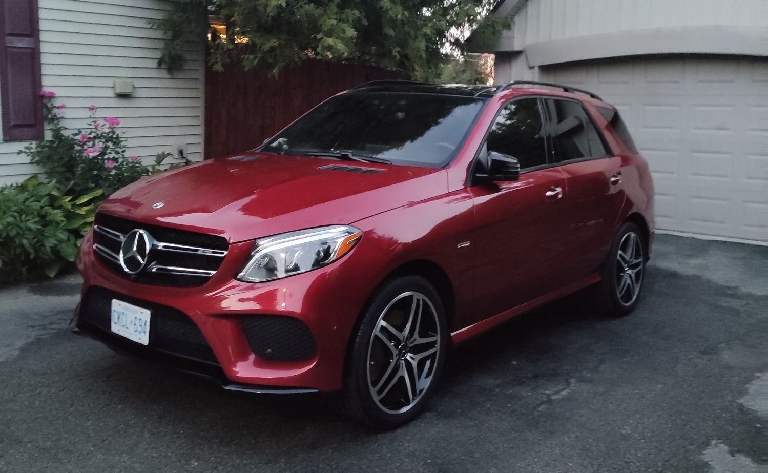

I decided to use a 20" GLK AMG rim on the GLE 43. I do need to use the GLK bolts as the GLE bolts wont work on the rims (goes further in). Spec of the GLK rims are 8.5" 45 offset. Tire I'm putting at is 255/50 on it.
Old Dec 8, 2024 | 10:28 PM
shotgun_banjo's Avatar
Joined: Jun 2011
Posts: 2,119
Likes: 271
'13 GLK350 4matic,'10 C207,'15 GLA250,'07 Honda Odyssey, '18 GLE 43, '24 EQS 580
255/50 r20 on GLK AMG rims 8.5" wide 45 offset. Need to use GLK bolts with the rims.
I love how it sits. Pushed out just right with taller rubber and a tad bulge on the sides. I'll do 275 on the original rims when spring comes.
