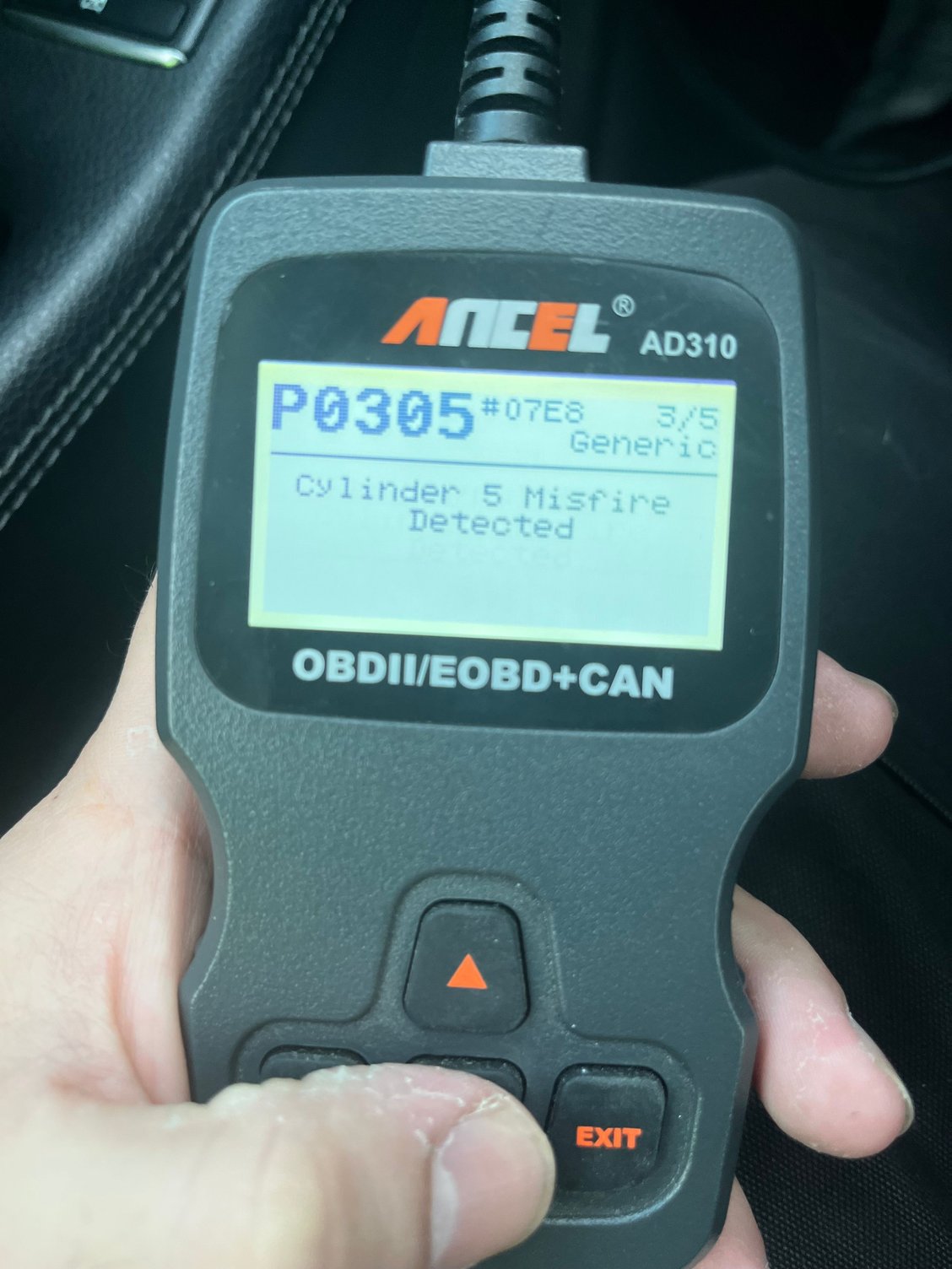

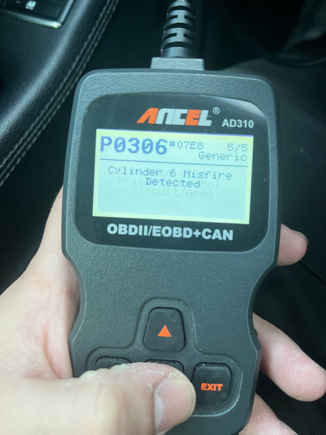

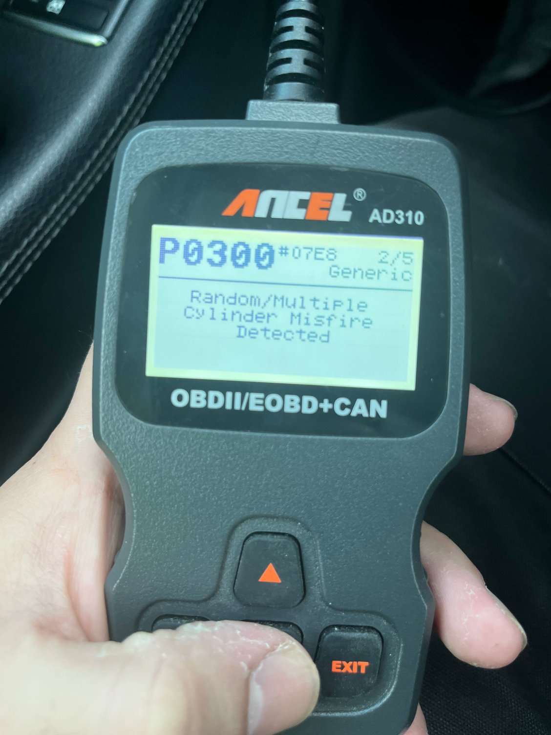

I've owned the SUV for about a year now 91,422miles on dash. No issues when purchased. Regular maintenance done to vehicle: oil changes, transmission flush, brake pads, etc... This issue came out of nowhere while on freeway. It is intermittent and the CE clears itself by the time I can get to a scanning tool. I was finally able to catch it and these are the codes it read. I've paid close attention to see when the engine starts misfiring. Idling for long period of time or accelerating, appears to happen more frequently if its fast acceleration, seems to trigger the misfires. Occasionally turning it off and on clears the misfire. Turning the SUV off and on enough times and the codes clear. I took it in to get a tune up but the issue persists. Has anyone dealt with this in the past, if so how were you able to resolve issue.
