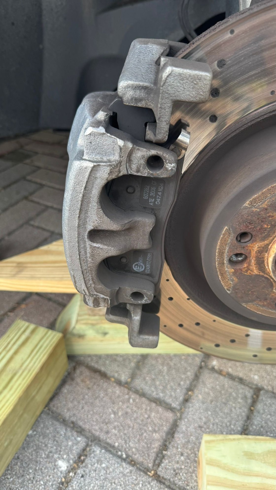

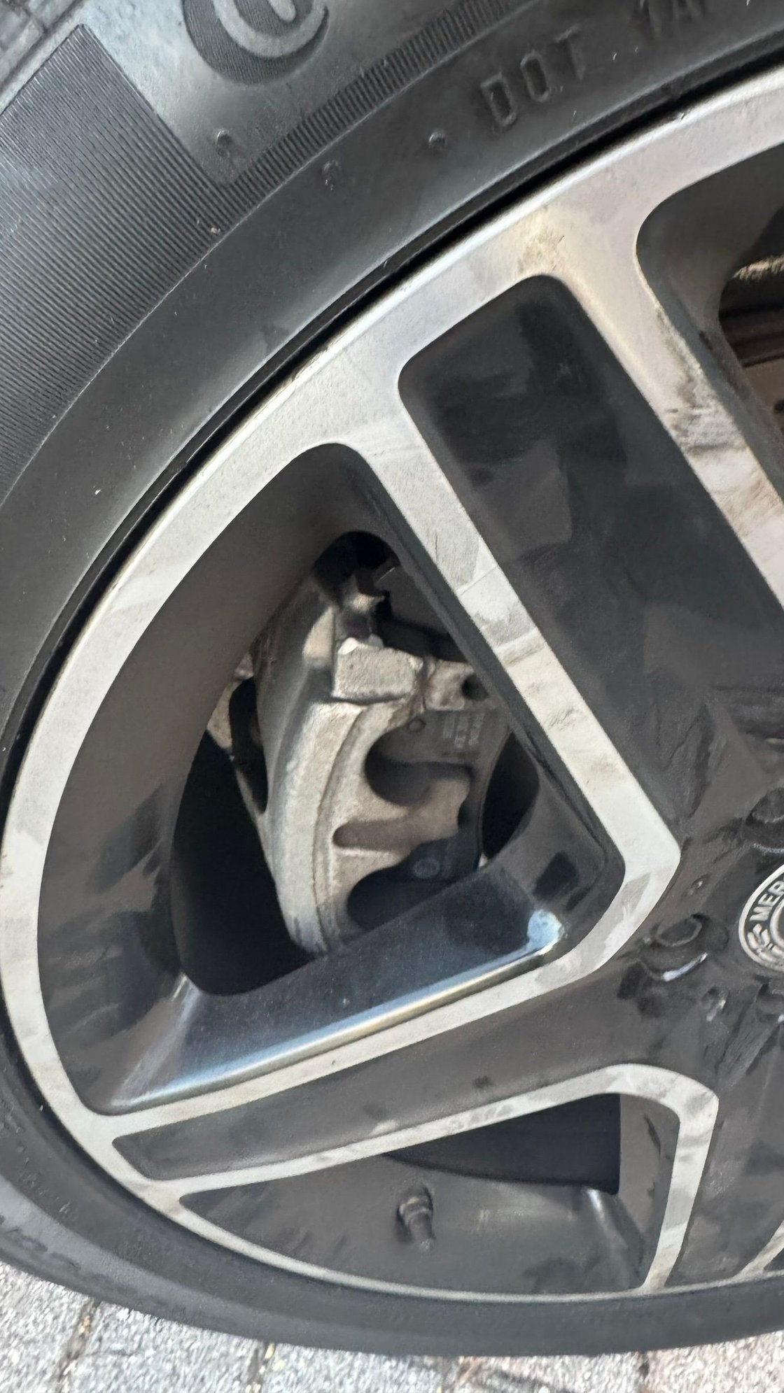

I was driving over a cobblestone street with the window down when I noticed a rattling noise coming from the right front wheel. After checking, it turns out the brake pad anti-rattle clip is missing.
I’m not sure how that could have happened — has anyone here experienced something similar?
I looked up the part on Pelican Parts and it’s around $160, which seems pretty high for what it is. Does anyone have recommendations on where to source this part more reasonably, other than Pelican or going directly through a Mercedes dealer?
Thanks in advance.

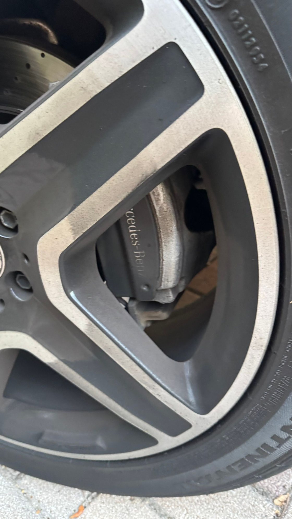

Left Front Wheel with clip in place.
Right Front Wheel, missing anti-rattle clip

It was incorrectly installed the last time your brakes were replaced. Dealership is your only option, around $135 wholesale
