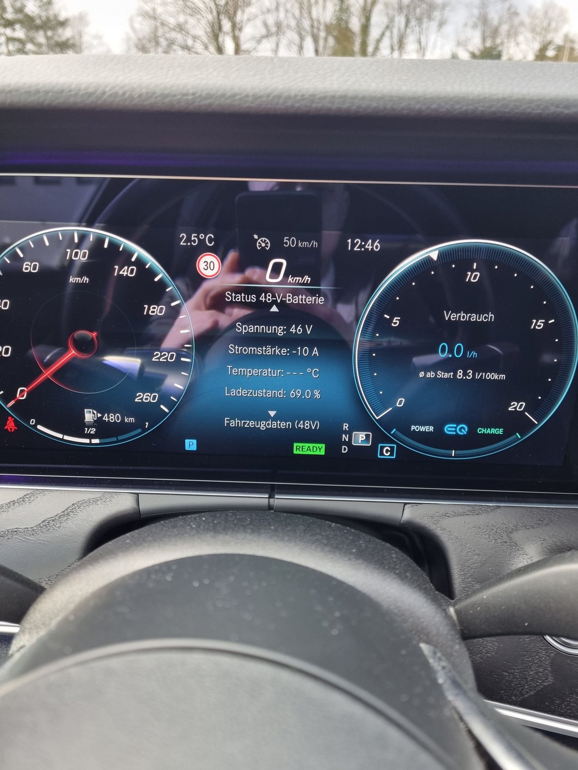

hi, I'm from Germany and also have problems with the 12v battery or 48v battery. After a short drive, the 12v battery is charged and remains charged when parked, after a long drive it is also charged but does not remain charged after parking. every day the 12v battery is in critical condition. and I don't have a temperature for the 48v battery in the workshop menu, is that correct. E Class S213 from 2020

Oh, that is correct. The 12 volt battery in the boot goes through a converter which charges the lithium battery in the front of the car. I am taking mine in to the dealership tomorrow because this is the second time that the car has left me stranded with out being able to start. It appears that the lithium battery in the front is what is responsible for turning over the engine. I'm not thoroughly sure about that, but it would appear that the 12 volt battery in the boot since it is fully charged according to my voltmeter is well over 12 volts. Apparently that is not the source of cranking the engine.
