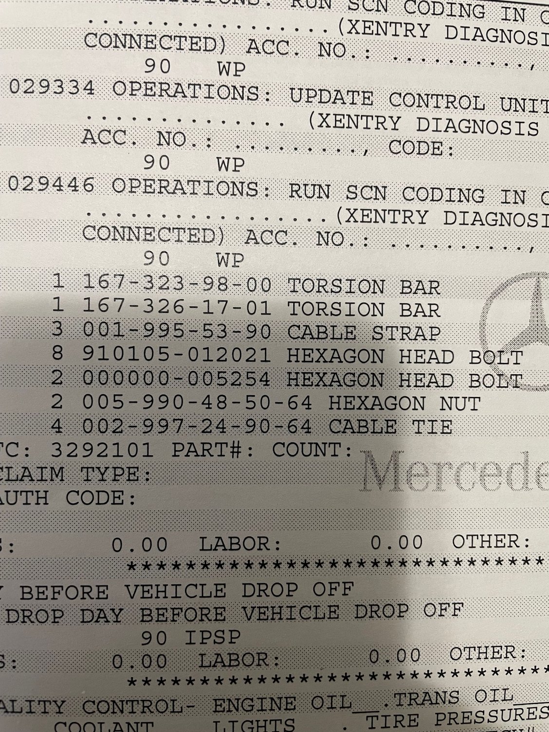

Got the car in April 2024 and it currently has just over 4,000 miles. I have the same clunk sound from a stop and also slow rolls. From the driver seat I can sometimes even feel it. I had my wife drive while I got in the cargo area with my ear on the “floor” and the sound was more pronounced. I listened from outside also and heard more of a clanking sound, so, I’m not sure that was it.
It’s currently in the shop for this a second time. Nothing was solved the first time and they’re telling me this occurs in some cars. They want me to drive some of these other cars to demonstrate (that they build other cars poorly like mine?!?!?). I’ve never had a car do this and I’m not satisfied with their answer. It’s a cop out. I may ask them to drive a Toyota Corolla to demonstrate that a cheap car can be built without the clunk.
I just sent them a screen shot of the messages above about the active sway bar solving it for some others. I’ll see what they say. I’m not going to accept this problem.
