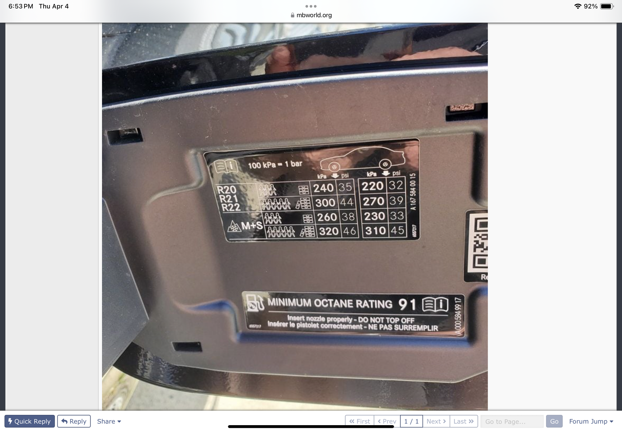

Use the pressure on the inside of the gas flap.
Mercedes provides more specific information on the gas flap, then the confusing two labels on the door post.

Originally Posted by bkushner
21”
The gas flap I posted above is for 21s.
I found that plus or minus one PSI from those pressures works pretty well.

Originally Posted by aces&eights
Mine’s a little different than yours showing lower pressures.
Is yours an AMG 53 or is it a 450, as shown in your profile? Year? 166 or 167?
All these differences might affect the gas flap recommended pressure.
Mine is a '21 53, and I should have added that it has ARC, which could be another variable.

I noticed the M+S pressures listed on your fuel door label, this must be an AMG thing?
