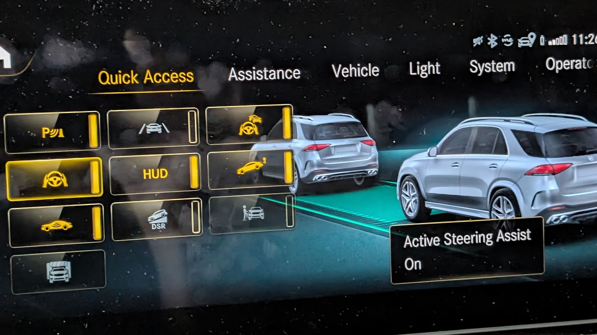

Originally Posted by Ttmmuurrpphh
I turned this off right away. Did not like the feeling of it.
This issue I’m referring to is when the car is going completely straight with steering wheel straight on. It’s like it’s so easily swayed it will go left or right on a dime by itself with out me moving me hand to make it go left or right. (When there’s a groove or pothole that the tire hits)
Observations:
I'm assuming from your video that you didn't have hold of the steering wheel.
I see the Active Steering Assist icon in your instrument cluster, but it's not illuminated.
I'm not real sure what that means for your year, but I think it means it's it is armed and ready for when you activate cruise control.
No matter, it's "officially" inactive below 18 mph anyway. What's interesting is that it seeming to be self-steering with no change from 25 mph to 10 and below.
I'd go back into Your Quick Access menu and make sure you have both Active Steering Assist and Active Lane Keeping Assist turned off.
Get rid of that icon on your instrument cluster. If you can't get rid of it, maybe that's the problem.
I think there's also a nomenclature issue with some of the responses, probably including this one, because the terminology may have changed from year to year.
My 2021 53 Quick access menu
Note that the icon for Active Steering Assist above, is the same as shown in your instrument cluster.

THANK YOU SO MUCH!!! After asking SEVERAL people and posting 3 times online your advice FINALLY worked!!! I was able to turn it off completely. I guess if it’s semi off it’s on passive mode and will still work a little bit. ?? Not completely sure, but after turning this off it’s 95% better!
Thanks again! So happy to have this figured out so now I can enjoy the drive 100%!
