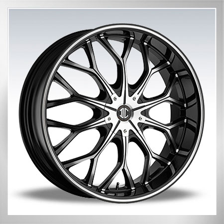

I just got these wheels ordered today. What do you guys think? 2 Crave Alloys No9 22's 5x112 ET+35 , Bore 72.82 Black Diamond.

Looks sharp!
I assume since they are 22 inches, thse will be the summer wheels? What are you replacing the 19 or 20 inches? What tires are you getting with those?

Thanxxx, i am replacing my stock 19s. I am going to wrap them in Falkens

Looks nice, how much did they run for?

I like the wheels... they will good on your white GLK!
Rethink the Falkens... cheap tires...

Nice design post some pics once they on the car.

They came out to $2000.00 U.S. with tires. I need to wait 2 to 3 weeks so they can arrive.

I really hope so! if you like go to their website and they have a white range rover with these wheels and its looks awesome! www.2cravealloys.com That made me do the purchase lol. Well with falkens that is the only tire the place i bought the wheels carry, nothing else.

Nice!!!....... but they sure look like a nightmare to clean and polish.... hope you have long summer weekends to buff those babies!

they look cool. you might have to buy center bore spacers, remember MB is 66.6, the bore on your new wheels is larger. you will have to fill the void. also you will be limited on tire choices, because of the offset and rim size. trust me, i went through it. you can't run anything bigger than a 255/35/22 with a 9.5in. wide rim. they will rub the inner wheel well. my 22's are 22x9.5, et35, & 255/35/22.

Thanx, damn spacers. Let's see how it goes once they arrive. The width of this rim is a 8 so I'm hoping.to put a nice wide tire n not rub
