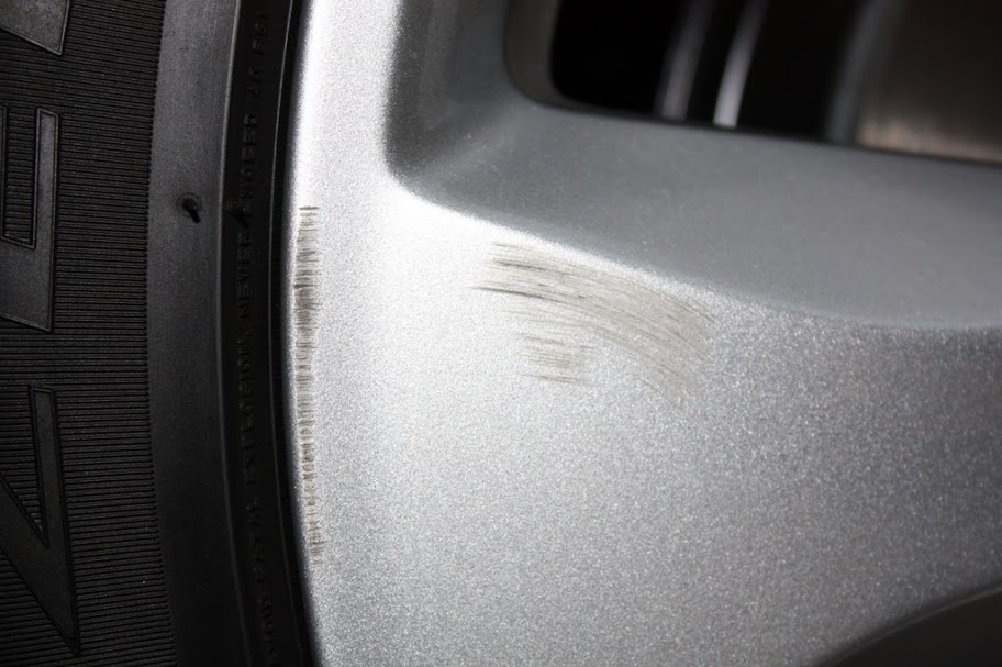

I only have before...

Looks familiar. I can't tell how deep the scuffs are, but as a minimum you could sand down (with wet emery paper and a flat sanding block) the peaks on the curved section near the tire.
Mask off the area. You might try a filler from your local body shop, but I'd just use the caliper paint to build up the valleys using repeated applications and wet sanding (again with a flat sanding block rather than just your fingers.) Once you are satisfied with the surface, then use a final silver coat and clear coat. It looks to me that the scuffs on the spoke only would need perhaps a light wet sanding with emery paper and then paint when you do the final coats on the deeper scuffs near the tire. This repair will not be "perfect", but it will look vastly improved compared to the current situation.
