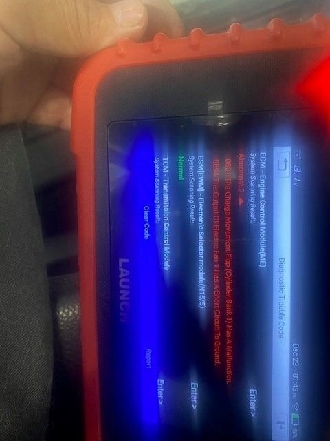

Thanks for the feedbacks. I managed to get another mechanic to look at it today. Attached, please find a new code that he managed to pull from his scanner.
This is the 3rd mechanic that has charged me but at least his scanner showed something different from before. What is your view based on the new code?

Can you actually read the code number ??? No it’s unreadable. But it says fan short to ground! Check the connections for corrosion if not better replace . I wonder if spraying it inside with electronics cleaner would be worth it? It would be worth getting one ordered today and shipped . FCP euro stands behind their lifetime warranty

Codes are readable for me (the only challenge is the image was posted 90* clockwise)
0521: Charge Movement Flap Malfunction: (Common on E350, GLK350, ...) A broken pivot arm, carbon buildup, or faulty actuator in the intake manifold flap system, affecting airflow and causing RPM issues.
0694: Points to an issue with the electric cooling fan 1 control circuit, usually a "high" signal, meaning the PCM/ECU sees too much voltage, often causing the fan to run constantly or erratically, leading to potential overheating and A/C issues, and usually involves a ... bad fan relay, wiring short, or faulty sensor.

Thanks. Yes, these are also what I gathered through AI.
The mechanic confirmed that I need to change the fan.

Agree completely. And for reference, it looks like your mechanic is using a Launch CReader, which is available on Amazon for less than $150. Even if you don’t do the repairs yourself, you go in with a good idea of where the problem is.
