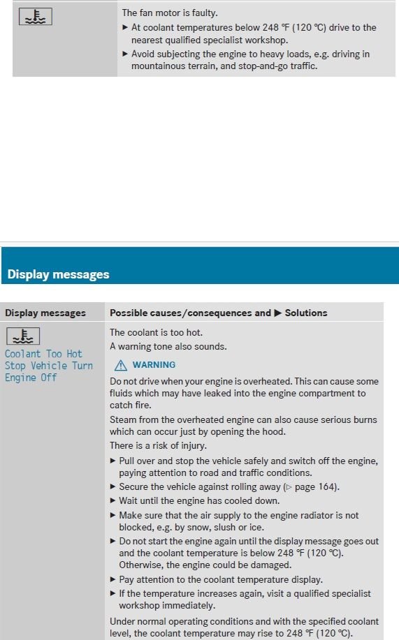

OK, first of all, ignore my previous post. I was thinking warning light, not warning message. Second, do you have the Owner's Manual? What does it say?
This is from the OM for 2014:
Do you have any text, or just the icon? For 2014, the icon alone seems to mean that the fan isn't coming on, or isn't effective. Make sure the fan spins freely and there's nothing blocking or plugging the radiator.

Thanks. My OM says the same thing as yours. It could be the fan. I am thinking of replacing the new thermostat again, plus a new radiator and fan. It is getting expensive, but it seems there is no choice. No icon, only the warning message/symbol.
