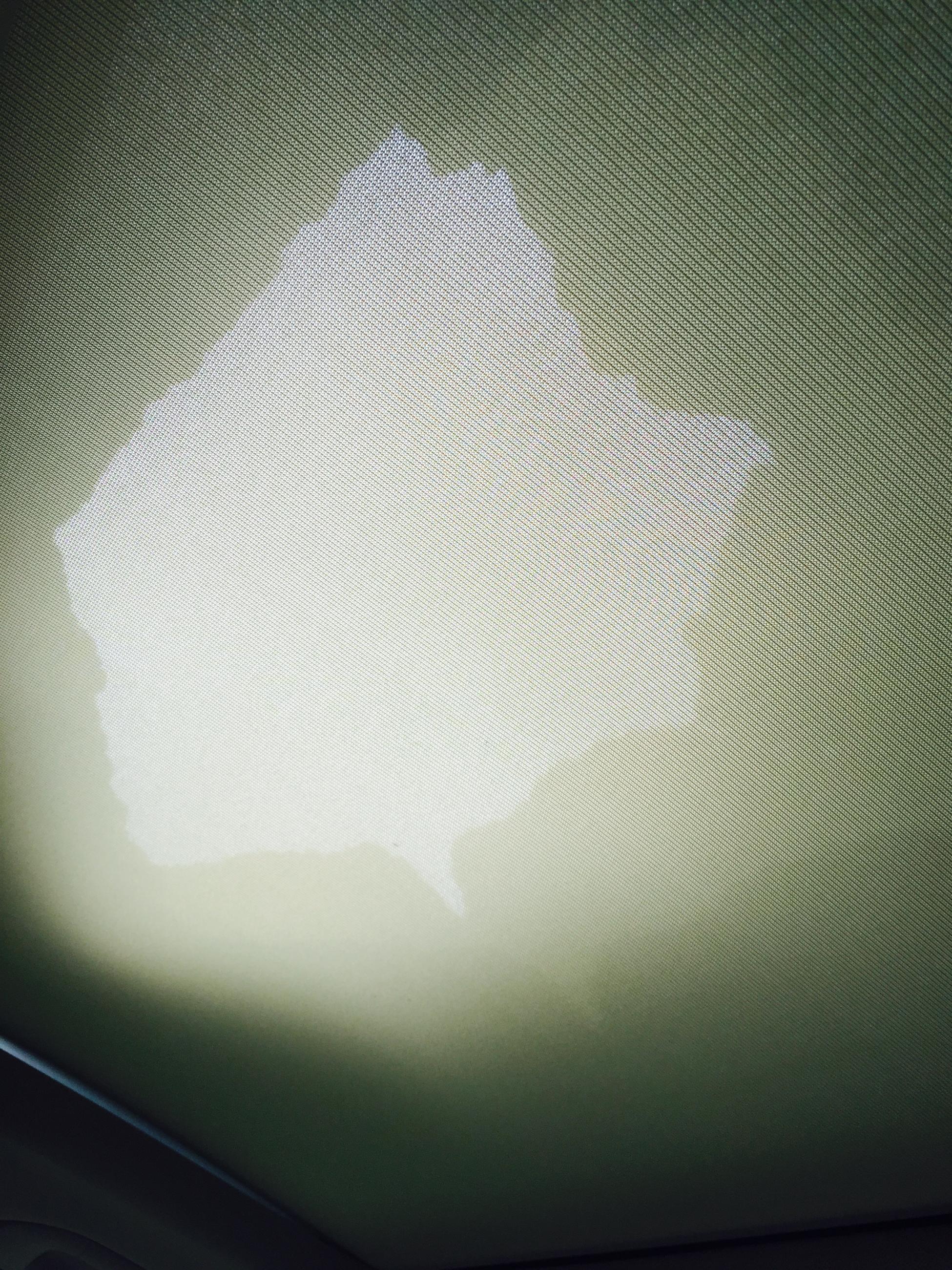

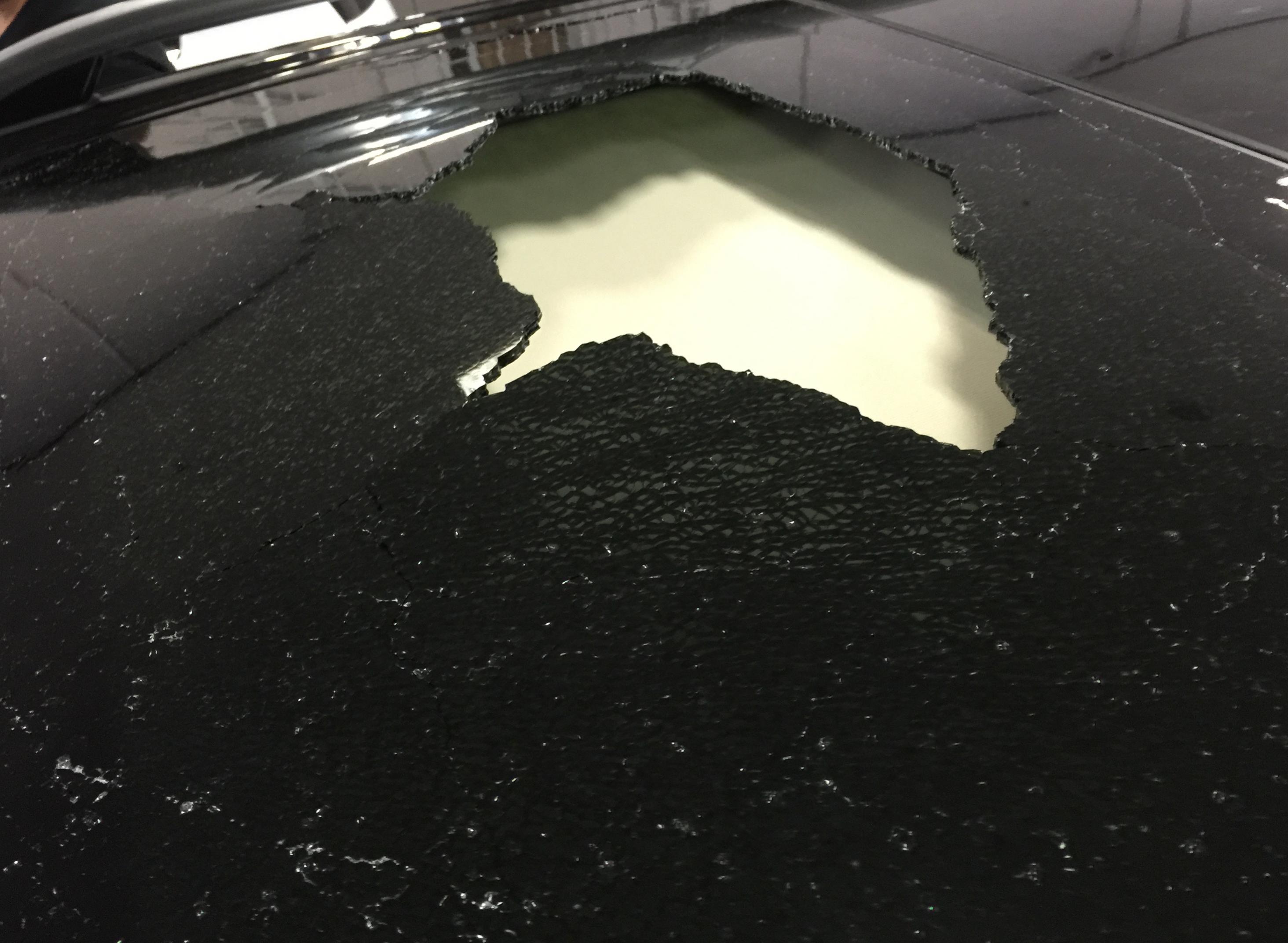

I was driving to the highway in my 14 250GLK and I heard a loud pop.
There were no other cars on the road so I figured the noise came from my car.
Next I heard what sounded like a window was not quite shut all the way.
I checked all four--all good.
We pulled over and saw that the entire pano sunroof had shattered but it was still in place (see roof1 & roof2 attached photos).
We call our dealer and he said to bring it in ASAP and he would organize a loan car.
We were about two hours away so we heading in hoping we could dodge the rain.
About 15 minutes into our return a couple of small pieces of glass were missing from the roof as we looked through the retractable sunshade.
Another fifteen minutes most of the roof flies off. (see roof3)
We made to the dealer minutes ahead of the rail. (roof4 is picture from the outside)
Questions--Has anyone seen this before on a Benz?
There was not any traffic or overpasses that could be the source of something hitting the roof. Temp was in the mid 60s F. Road was smooth and the speed was not excessive (75-80mph).
Any pointers to avoid this going forward other than a new rabbits foot?
How do I prove this is a defect instead of an insurance claim?
Thanks in advance for your assistance!

Just a WAG: maybe an object "fell" on the sunroof? Glad to hear passengers are OK and dealer is now on it to fix it. best of luck.

That glass is tempered, which sometimes creates stress points. Changing temperature or physical shocks can make the glass shatter.
BTW, most insurance companies have a no-deductible glass replacement policy so you may still be OK if the dealership doesn't cover it.

Reply: The same thing happened to my GLK350 2014. I was driving like at 55mph and all of the sudden i heard an explosion in my SUV and I stopped to see if anything hit the car but the only thing broken was the sunroof which was completely shattered for no apparent reason.
I went to the Mercedes dealer and the service adviser could not see anything that can point him that it was an external object that broke the sunroof.
I will let you know sometime this week if it went under warranty. But if they make me pay for it, they will meet my lawyer.
Hope everything goes ok with your situation.

It is spontaneous breakage! I am in the glass business and spontaneous breakage on tempered glass is somewhat rare but does happen. Tempered glass is heated just like the rear glass and side glass of a car. Windshield is made by a different process. Your pano is defective if it experiences spontaneous breakage. Nothing hit it. Sometimes it will break if the glass experiences very high temps.
