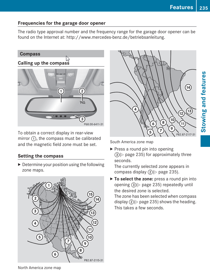

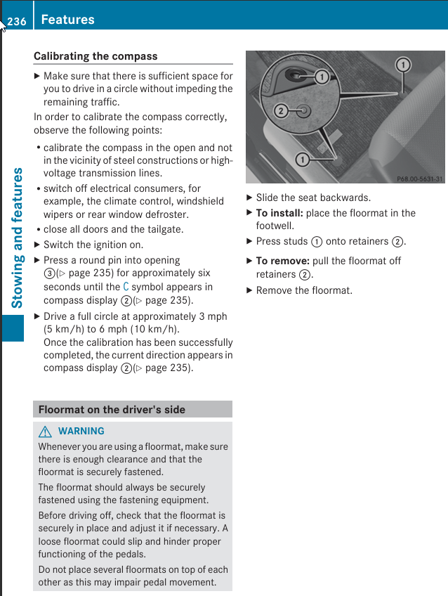

Old Dec 30, 2025 | 11:27 PM
eg1HnS4AHskZ's Avatar
Joined: Dec 2025
Posts: 23
Likes: 12
From: CHARLOTTE NC USA
2012 GLK350 4matic
Compass Calibration
Was perusing the owner's manual and stumbled upon this section on how to set the compass zone and calibrate the onboard compass for my 2012 GLK350. I've never seen instructions to calibrate a compass like this before.
How to calibrate the compass on 2012 GLK350...
Setting the appropriate compass zone on 2012 GLK350.
