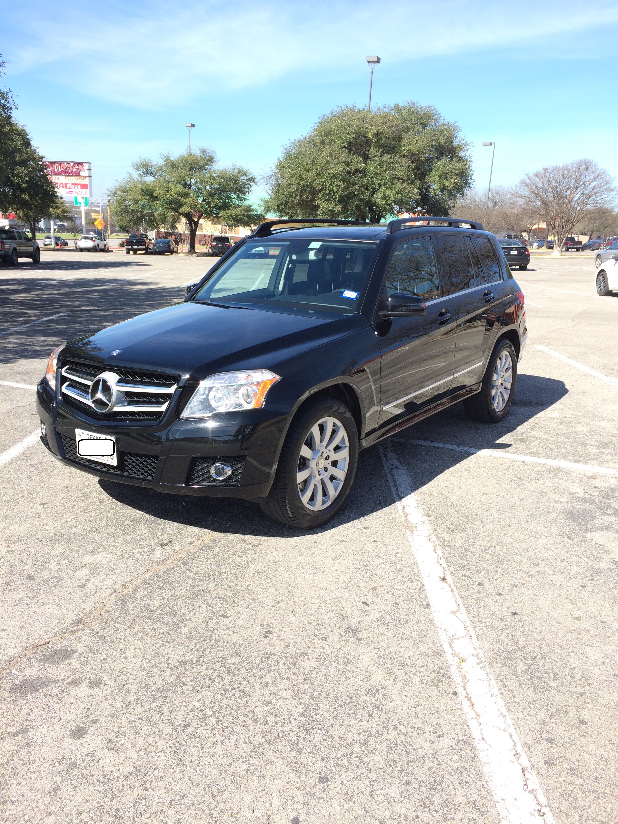

Sorry for the long story. Here is the car.
Attached Thumbnails newly purchased GLK350 - was this a mistake?-mbglk350.jpg
