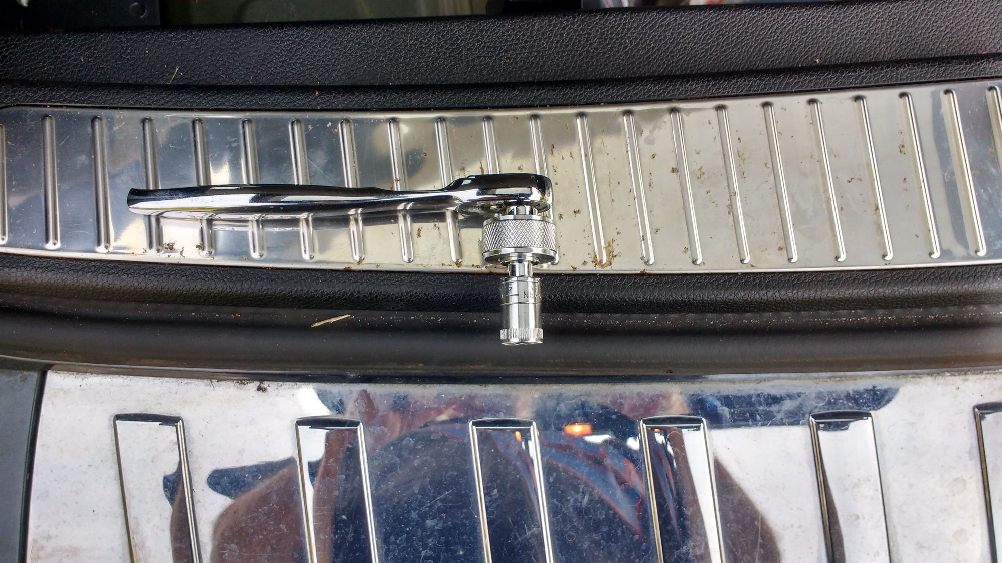

I just installed a Westfalia Hitch (PN 313 434) on my 2013 GLK 350. I gathered a great deal of helpful info about the process from the members on the forum, the folks at PF Jones and YouTube e.g.,
(Great YouTube video BTW). Thank you one and all!
I did want to share a couple of things, that was not in any of the material I saw, that might be helpful.
Removing and reinstalling the 4 nuts from the two brackets just below the tail lights seem to have caused a bit of pain for some. The thing I used was a thin profile ¼” ratchet, a ¼” finger grip socket adapter and a 10mm ¼” drive socket.
All the bolts can be reached easily from below. The hardest thing about the reinstall process was that it had to be done by touch since you cannot see the threaded stud. The finger grip socket adapter with the socket helps a lot though. BTW a creeper did come in handy as a head rest for this part of the job
The gentleman I talked to at PF Jones was not sure the hitch would be hidden. It is though. I removed 3 ¾” of material the width of the center section of the bumper. I could have reduced that if I had smaller hands.
Hitch installed
