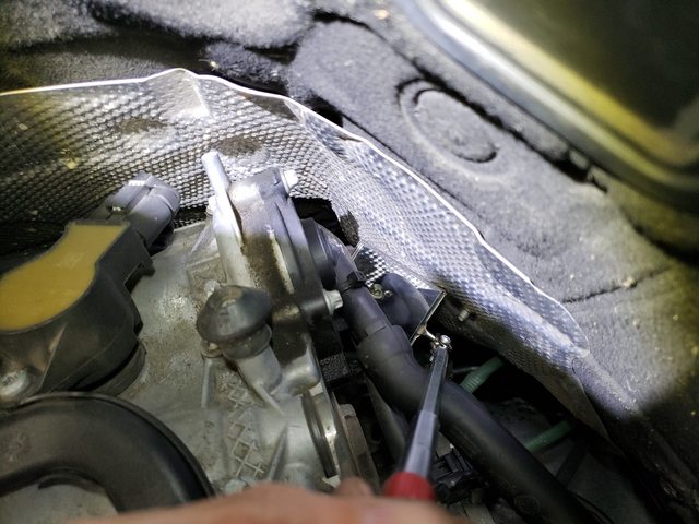

If it's like the 2011, it's not a hard job, but access and visibility are less than ideal. There are three screws attaching the centrifuge to the back of the engine that you need to remove, but there's very little room between the back of the engine and the firewall. Two top screws are easily accessible:

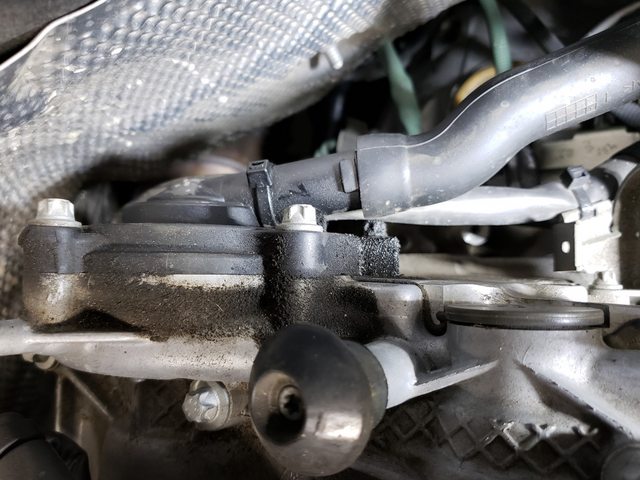

But the third one, on the bottom, requires an inspection mirror or feel to see and access:

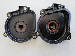

So be prepared for some "wrenching by braille". Here is a comparison of old and new covers:
For a professional mechanic, this should be a 30 minute job, including a bathroom break. So anything above ~$150 for labor is gravy for the dealership.
