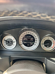

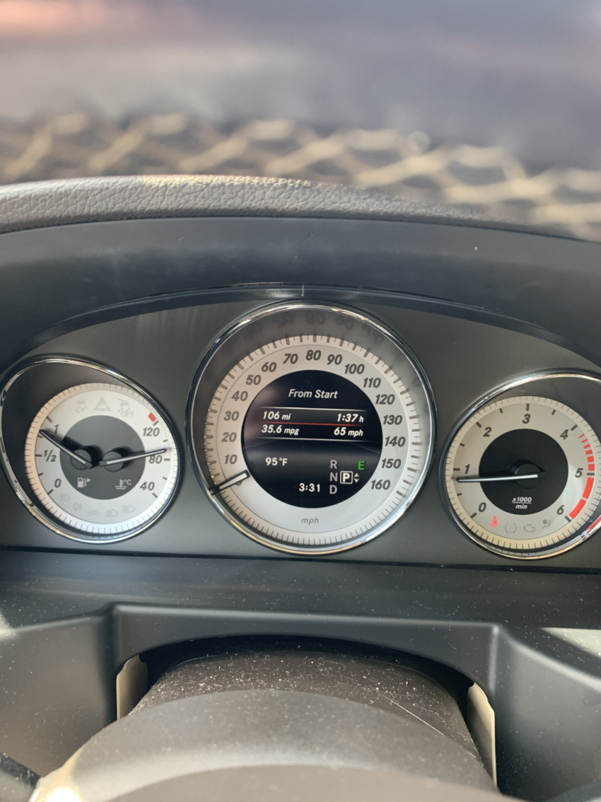

I hate to be negative but I contacted several tuners and the answer was the same everywhere, No. I've started the first phase of my testing. I've replicated a delivery drive back to my daughter's house. So far I'm impressed. I can't tell any difference in the way it runs. Fuel mileage seems spot on if not slightly better.
