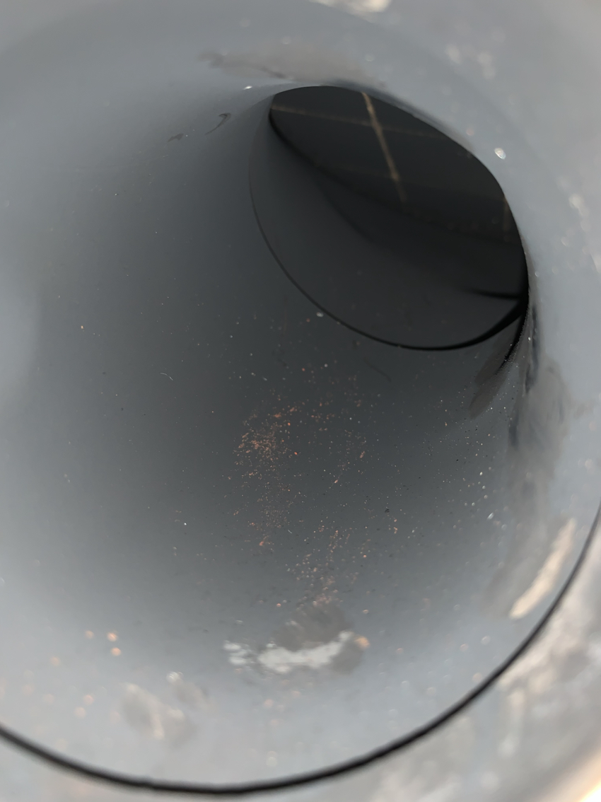

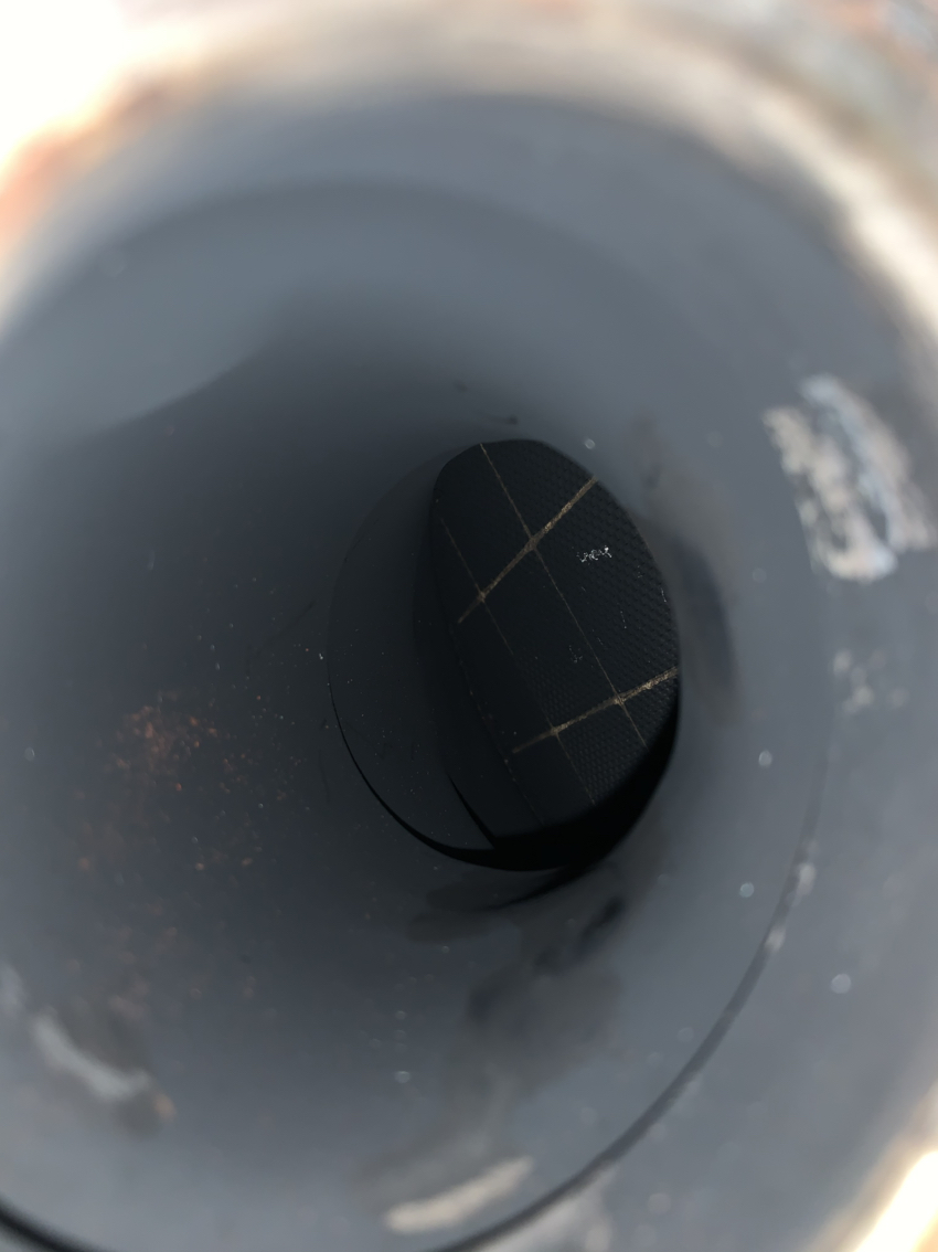

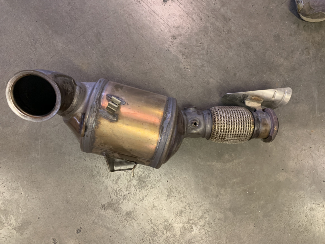

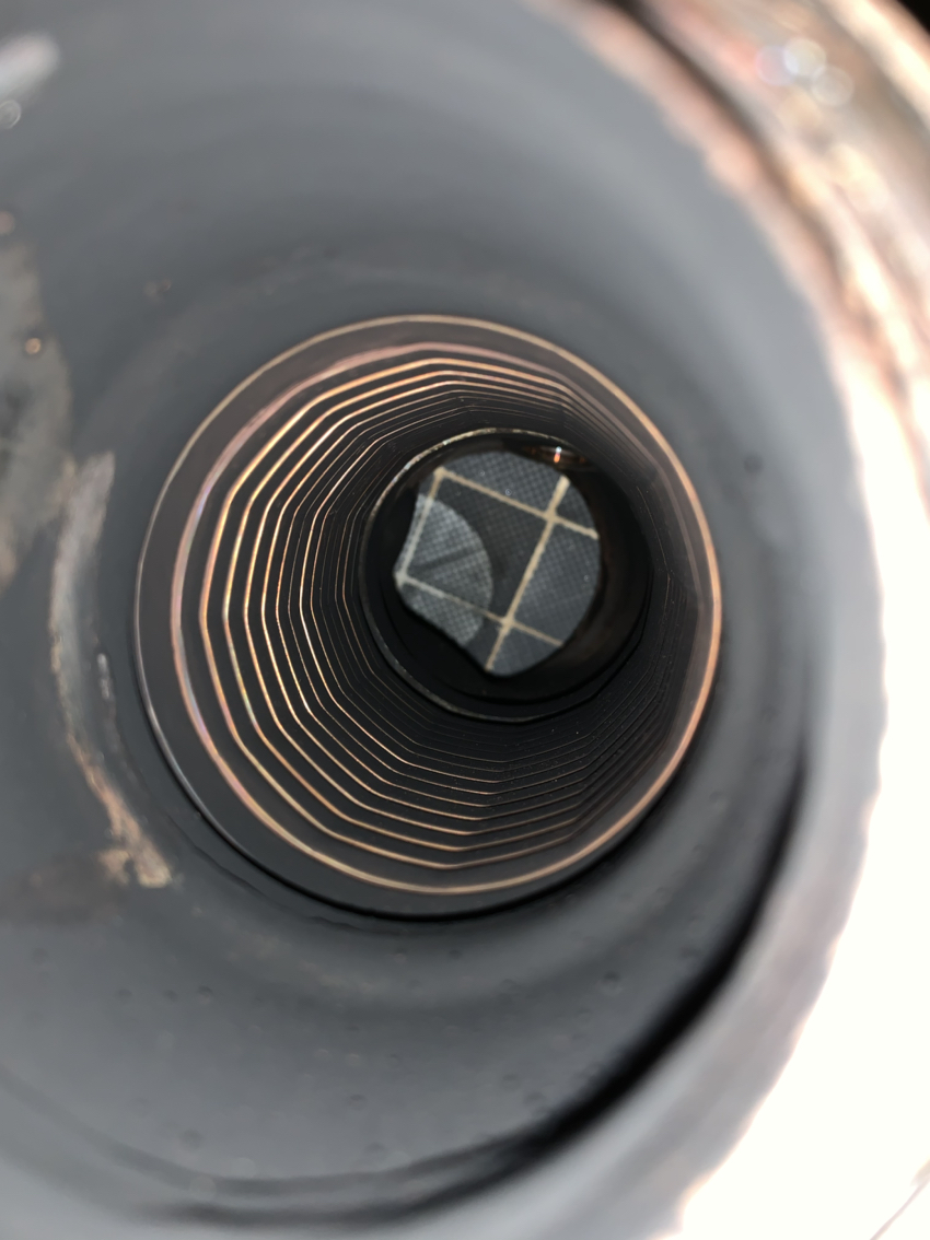

Hey guys I removed my DPF today to have it cleaned. I'll update pictures and findings as I know more. I have contacted OE Tuning to inquire regarding a refinement in the programming for the regeneration cycles. Their response was not encouraging at all. I don't need more power. All I want is better programming for the regeneration system. More details forthcoming.

I'd be curious how much ash/soot you're able to remove. Maybe there's a way you could weigh it out?
By the looks of it, I'd say manual cleaning is overkill. But the pics of the process are appreciated, for those that want to undertake this possibly themselves. I would also clean the sensor(s) that plug into the DPF.
There is a DPF cleaning kit that LiquiMoly makes, including a spray wand and concentrate solution. It can be done by the DIYer at home.
Good luck, let us know how it turns out.

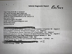

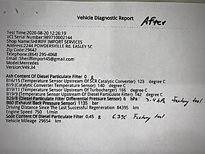

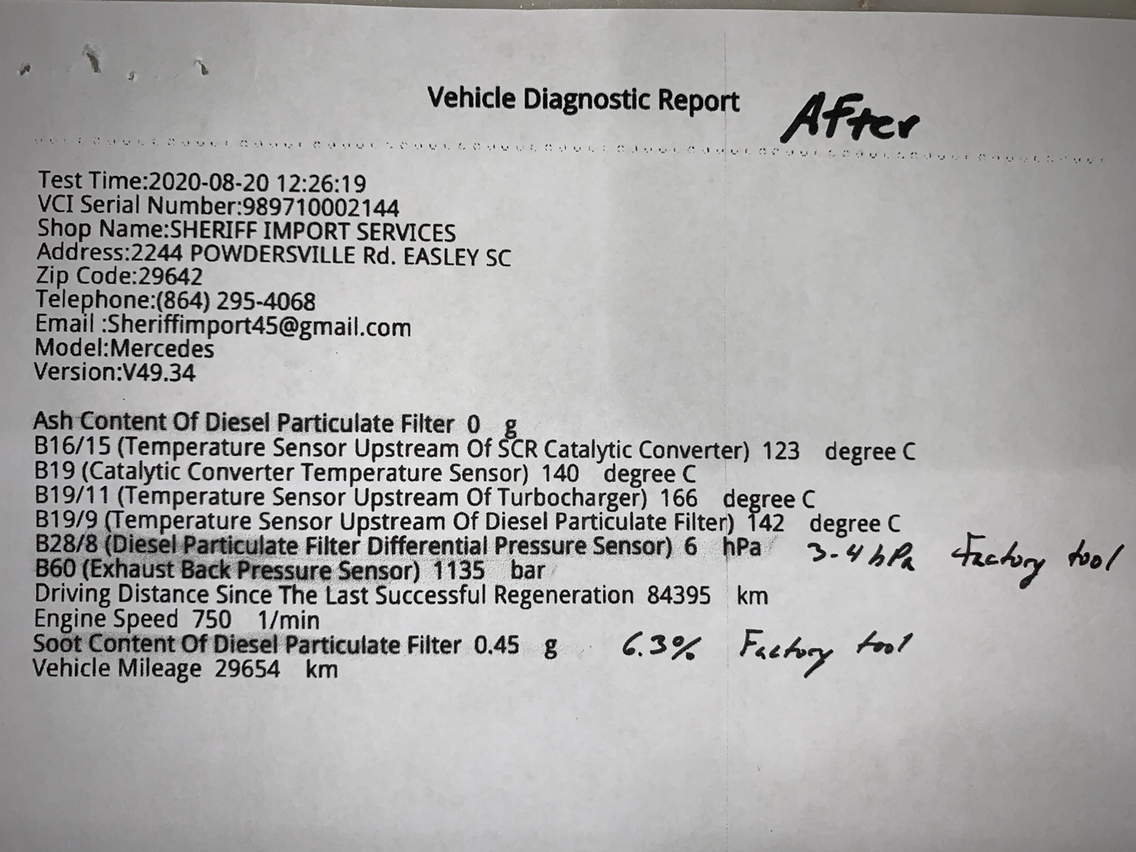

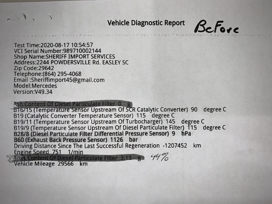

Here's the final results. The attached pictures show results before and after. Hand written values are from a MB scanner and the other information is from another scanner. Both indicated a massive improvement. Time will tell.
Attached Thumbnails Check Engine - DPF error-photo104.jpg   Check Engine - DPF error-photo320.jpg

A good result, but I maintain it wasn’t necessary. Good on you for doing it anyway, and for posting results.
Why not necessary? The ash mass limit before a DPF is “clogged” is around 150g, give or take. Yours had 13g, now down to under a gram. More than 90% unclogged basically.
Also the pressure difference went from 9hPa to 5-6hPa, which amounts to hundredths of a PSI, or almost immeasurable.
Again, I commend you for doing it and posting the results, but your DPF would’ve been fine for many tens of thousands of miles. The errors were (and may yet be) the result of unhappy sensors, not a flow or clogging issue.
