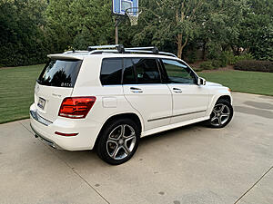

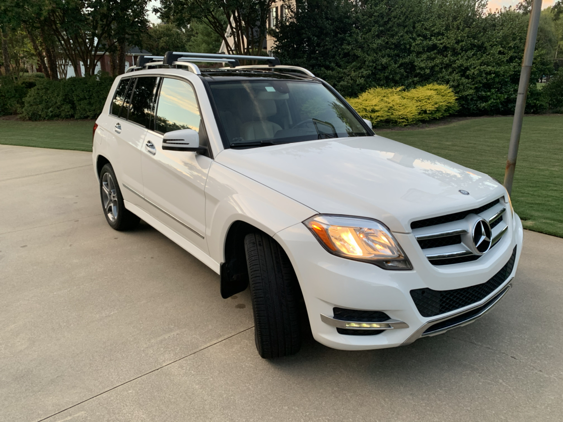

Thanks. I gave it the royal treatment when I got it home. A good shine has to help doesn't it?

OETuning has good solutions and I was happy not to have to chop off parts. Plus the thing is truly a beast now; was no slouch before, but now it’s exactly how I wished it was from the factory.
Srb, she’s a beauty and we’re all hoping she gives you no more troubles. It needs to be reliable for your daughter and you’re being a great father faking care of things.
Keep us posted on the progress and wish everyone a happy, safe Labor Day weekend.
