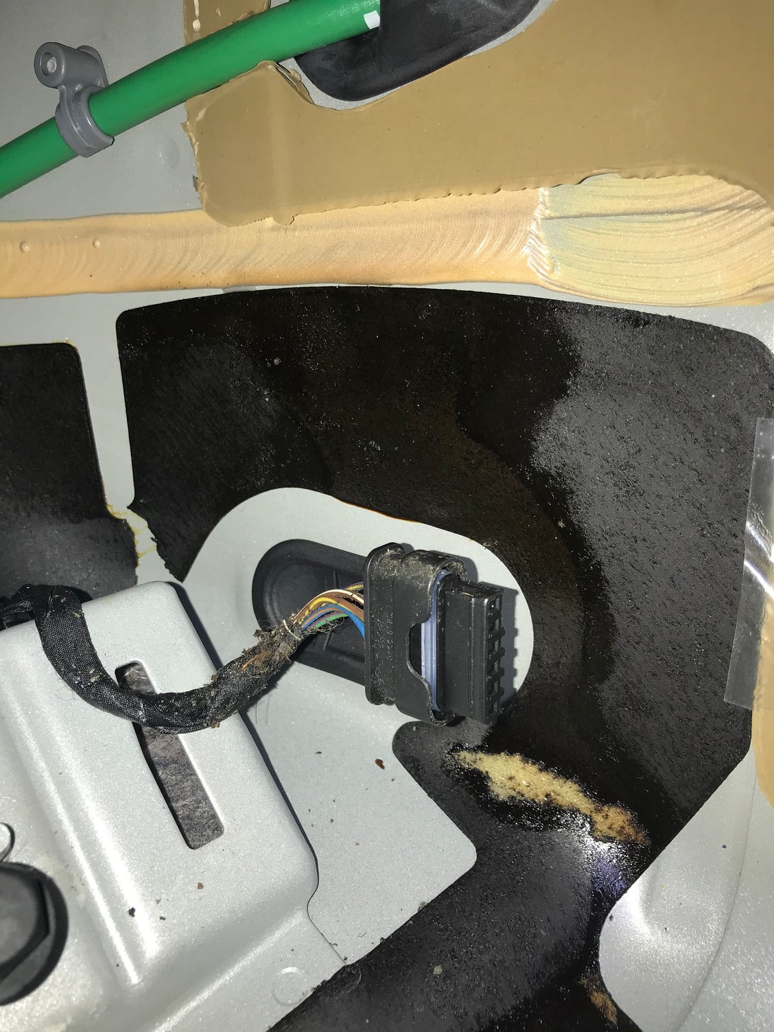

Hello all,
I need some help. I woke up the other day and noticed my driver side carpet was wet...we had some heavy rain. I pulled off the panel under the driver side and pulled back the carpet to find where the water was coming from. I found water underneath this (see picture). The foam insulation underneath was soaked...the foam above is bone dry. Any idea where water could be coming from?
The bottom of the gasket that meets the firewall seems to be where water is coming in.
Any help is appreciated.

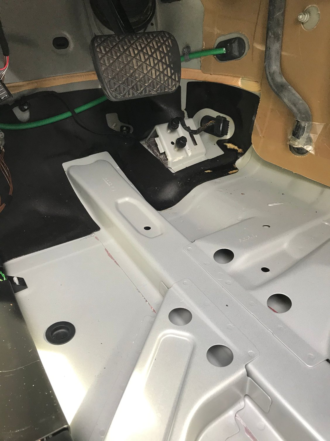

Just an update. Pulled carpet out and the floor is dry...just the foam and carpet wet. The fluid is clear but seems to be slightly oily? You can see where the fluid is running down by gas pedal.
Any clues?

know on some other cars (like Cayenne) you need to make sure outside drain vents (by the windshield) are not clogged otherwise water finds way over time.

Oily ? Maybe antifreeze, check coolant level.

The drain for rain is on either side of the wipers in the corner, slowly run a hose and see if it drains out below , then leave the hose to see if it leaks inside.

Get a good inspection of the fluid. You should be able to affirmatively identify what it is.
Smell
Consistency (oily, sticky)
Color
If it’s water, the sources are external leak from rain, or HVAC condensate.
Of it’s not water, the sampling procedure points you to the next step.

Try running the car in the driveway, warmed up with the heat on the highest temperature setting, A/C button turned off (not lit). Raise the rpms over 2,000rpm and hold for 20-30 seconds and see if you can cause a leak.

If the test was conclusive, which it isn't necessarily, it would mean the HVAC unit isn't leaking coolant. Another test is to run the vehicle in the driveway, with the A/C "on" and the temp turned to the coldest setting. Let the car run this way for quite some time, maybe 15 minutes at least.
The two tests are intended to look for either coolant leak or condensate leak from the HVAC unit. If no leaking after these two tests, the water is (presumably) not coming from the HVAC system, but rather somewhere else. For example cowl drain, sunroof drain, door seals, windshield seals, etc.
Have you had any glass replaced on the vehicle?
