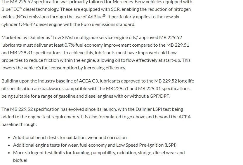

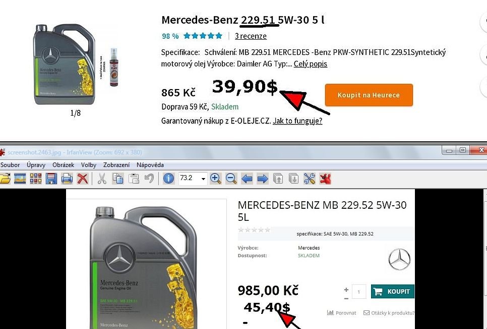

Hi. Last time I wrote it without reverse translation. And Translator probably translated it according to his mood. The translator translated complete nonsense. I'm sorry. I hope you understand me today.
Understand specification 229.52 as a facelift 229.51. The reason why is 229.52 = ever-stricter emissions.
More in the attached picture 1
In Europe, the price difference is not large
Figure 2.
Your engine doesn't need 229.52. The choice is yours. From my point of view, uselessness that gives the engine nothing.
PDF file: Oil specification by engine type
