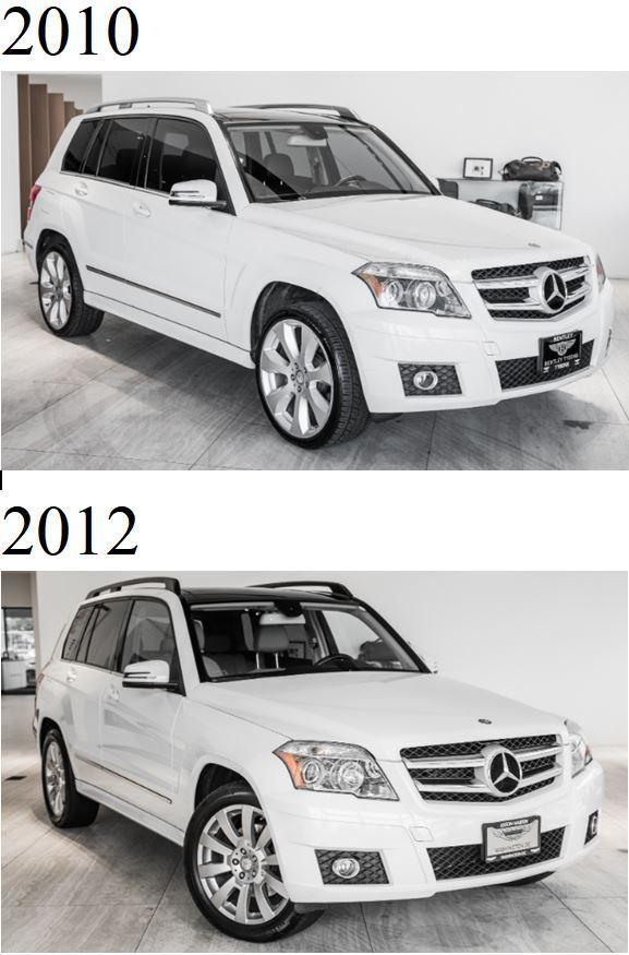

i was wondering what the difference is between a glk 350 2010 and 2012-15 headlight assembly.

You got me wondering, too (I'm new to the GLK). According to Rockauto.com (my go-to for compatibility questions) they seem to take the same replacement headlights. Hmmm.
So I looked up what the two years actually look like - not much (any?) difference I can see...

OTOH, if you want to see the difference between the 2010 and 2013...
