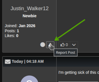

I thought I'd Reply, in case others don't know about this forum feature.
For every Reply, there is a small triangle (see arrow in screenshot) in the User Info box.
That's "Report Post" -click it ... a message box shows up, type your concern, then tap Send Report.
A Moderator will probably investigate and decide what to do
