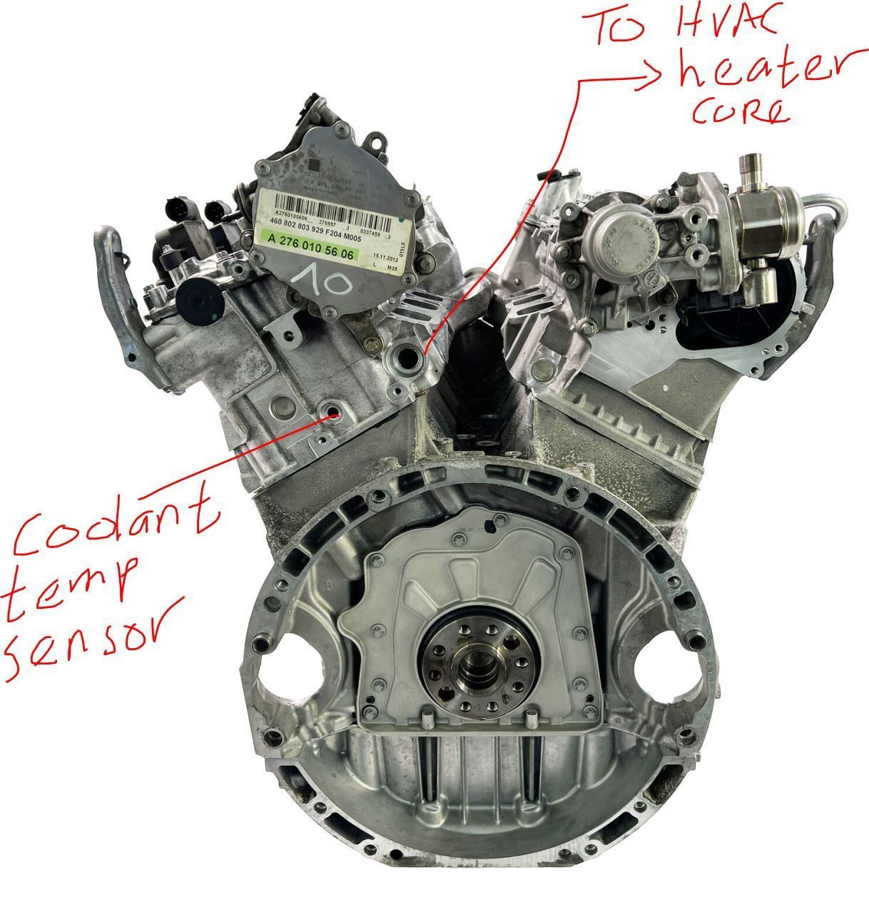

My 2015 GLK350 gauge started to peg out at 120, however, the car was not running hot as the fans were on and the coolant was not boiling. The independent shop I took it to claimed the PCM was the cause of the false reading, they said they see the PCMs have internal fault codes often and it'll be a 2k fix. I thought that was odd, has anyone ran into this issue? I was assuming it would be a coolant temp sensor but that has become a pain as I can't see it on the back of the engine to even change it.

I was wondering if it rose to 120 in a second or two after the engine began to warm up. That would indicate a failing temperature sensor or a wiring problem. I’m not familiar with the ECM causing this, but I’ve only had one M276 to work on (mine) and it was quite reliable. You might consider changing the sensor any way. It’s a $20-$30 part, even if it’s hard to get to.

No, it rose there after the engine warmed up, upon further analysis the heater has stopped working, and the top radiator hose is hot while the bottom radiator hose is cold. I'm going to replace the thermostat, it's just weird that the engine wasn't showing symptoms of overheating

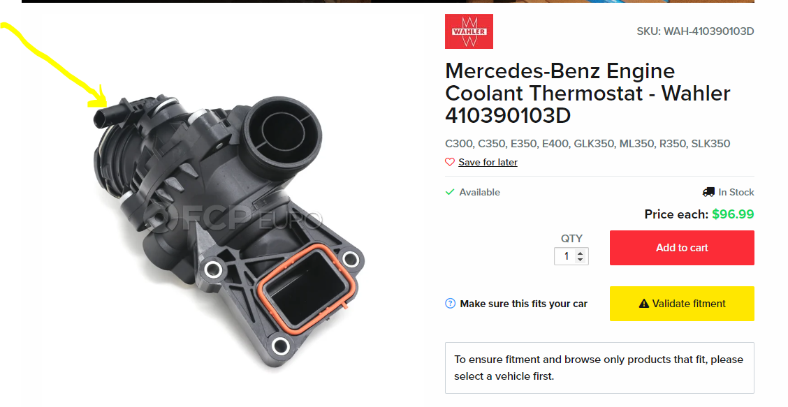

The thermostat for M276 is 276-200-05-15. It has an electrical connector on it, but I doubt that it’s a “smart” part. It’s less than $170 from Mercedes, and fairly easy to get to.

That is not the case for the M276 engine,
That connector is for preheating as far as I understand. At least is electrical, controlled?
Also, the cluster reported temperature is a FAKE value. MB controls the reported temperature in ranges. 120 C is HOT since it is above the "normal range".
