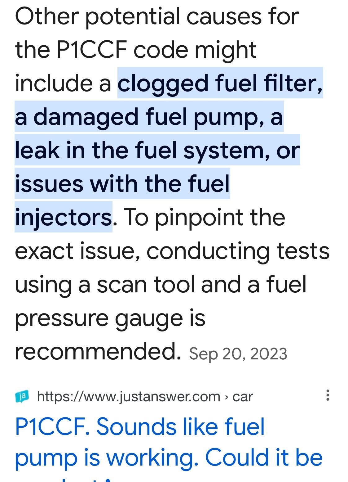

So I put a new battery in two weeks ago, it's been over 200 miles couple dozen starts and the P1CCF code is still in the background although it has never illuminated the check engine light since that one time.
Vehicle hasn't been unable to go into reverse since the new battery either. And I've noticed it seems to run even smoother, more peppy, and even better gas milage since the ECO now kicks on more frequently and stays on for an entire red light. I think that's a good sign the new battery was needed. For the record gas milage and performance have always been great.
How long should it take this damn code to go away, or become a bigger issue and show me something?
My blue driver scanner won't clear it. I'm honestly at the point I was thinking of pulling the - battery to clear it to see if it comes back, although I know that's not ideal, and I don't know why it didn't clear when I swapped the battery because I don't think I did it in under 60 seconds. That's how long the internet says it should take.
This code is so freaking mysterious. Most of the threads it pops up in there's a bunch of other fuel related codes and issues. The few threads where it's just this one code often points of battery.
Here's a screenshot of the fuel trim range on a little drive I did this morning. I don't know what that drop is but long-term seems right enough? Rail pressure is always in range and it never gives us a problem starting no misfires no hiccups.
It got a new low pressure fuel pump fuel pump module pressure switch and fuel filter 11 months ago and haven't had any issues.
I finally searched this in a manner that found me that AI answer pointing to catalytic converter, but when you read it's two sources they don't mention catalytic at all. I'm really not scared of AI taking over the world.
