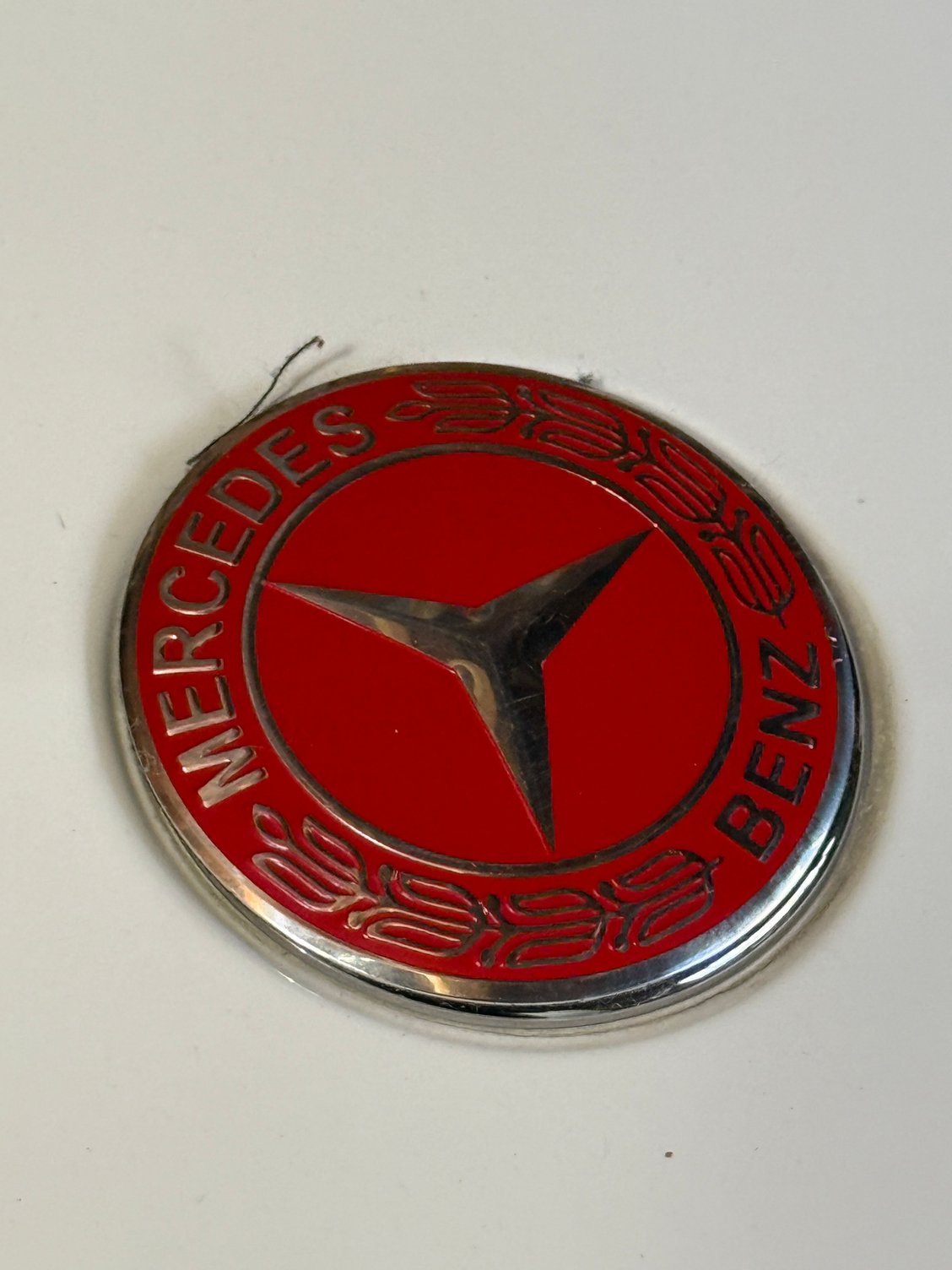

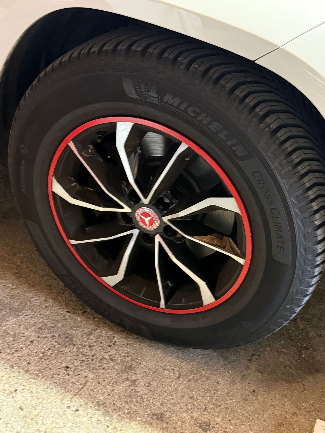

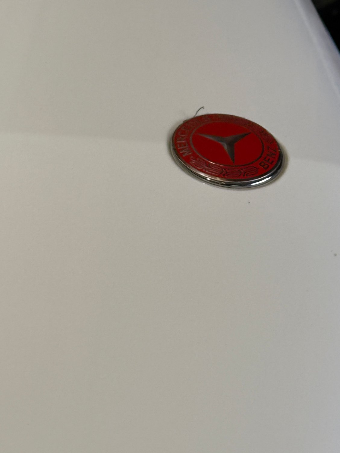

I just had mb wheel center cap emblems shipped from Canada to Chicago , it should be no different the the other way ?
