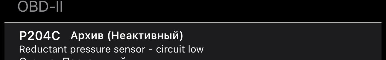

After i drove approx 300 kms, check engine light showed up. I have cheap OBD scanner and it is showing me code P204C and P062A (00) (active)
I try to delete the code, and after 2 days it is showed up again. It says: “Reductant pressure sensor - circuit low” status: Permanent. And Fuel pump (FP) A - control circuit range/performance
