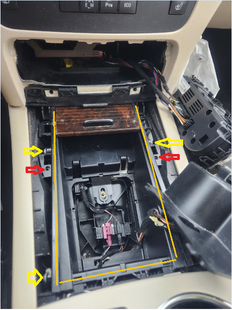

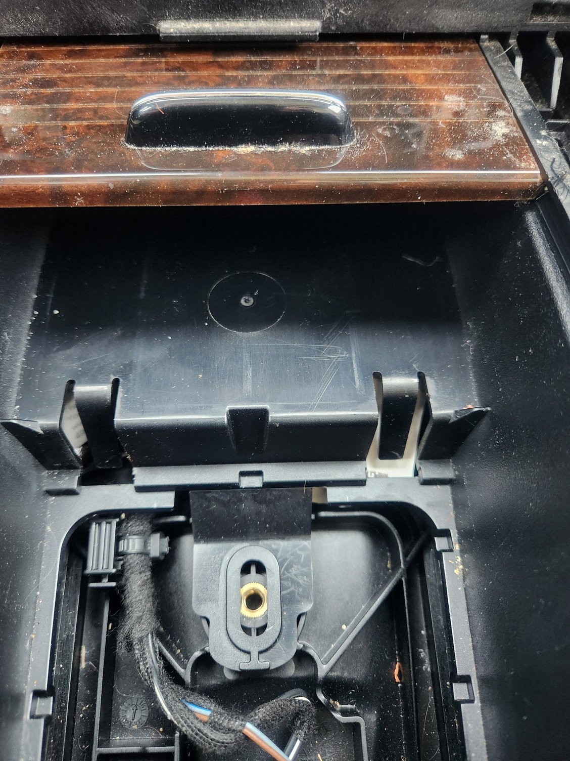

I've placed a red box around the plastic part. It is all part of the same mold that makes up the sides and the "frame" that creates the center console.
You can see the white paper behind the spring clips that hold the ashtray in. That's what I am trying to retrieve.
I'm wondering if I can figure out how to unscrew the 4xT20 screws on the sides (yellow arrows) if the whole frame will lift off (orange box area). I've removed the 2xT20 top screws (red arrows) and that allows the top of the frame to flex a little.
My current thought is to simply cut a square hole in the top of the plastic, somewhere around where you see the circle from the mold injection. There is a rubber insert that covers this whole area so you'd never see it and of course that will make it easy to retrieve items in the future. Has anyone else done that?

You gotta take out the rear AC vents, and then you can move the center concole back and full out. There's two hidden Torx 30 you can't see.

To much work taking it all apart to find that lost telephone number, why not use something like a Dremel tool or blade to cut out a piece of plastic , you won’t ever notice the hole and it won’t matter .
