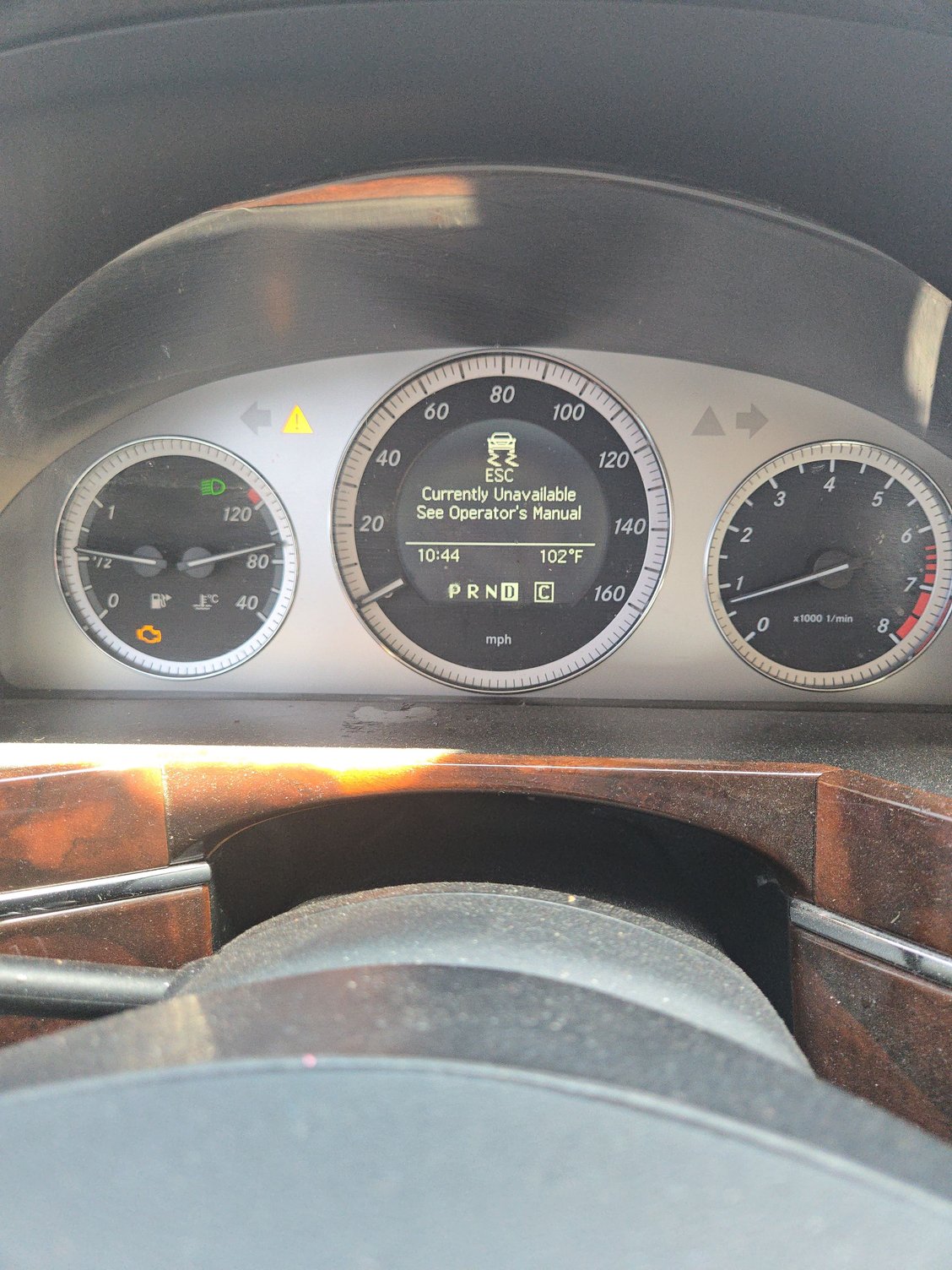

Hello everyone, I have been having issues since July, my ESC currently unavailable see operator's manual popped up and my truck loss power. I turned it off and back in I got to work & on the way home it did the same thing. My mechanic changed the coils/spark plugs , then he said it was the secondary air injection pump so I replaced that, then every other day it would continue. He claims he checked all the sensors then said my alternator was bad so Saturday 8/9/2025 we replaced it today after not driving all yesterday it did the same thing ESC currently unavailable. Someone ple
Please help me
Please help me
ase offer me some advice. This issue has costed me my job

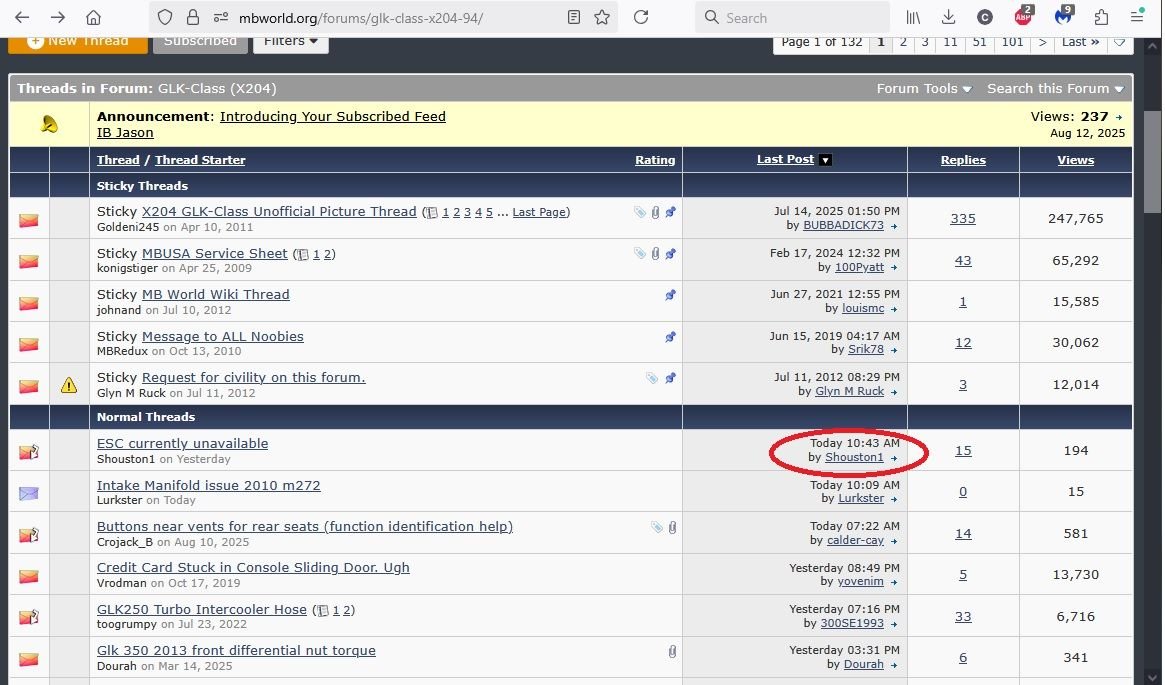

Odd: the forum index says there's a new post to this thread by Shouston1 at 10:43, but when I choose "View first unread" it takes me to post 1, and when I go to the end it shows the last post as mine from 10:39. I wonder what will happen when I post this reply at 11:00?
Curiouser and curiouser .. One of my posts (after this one) also vanished.
