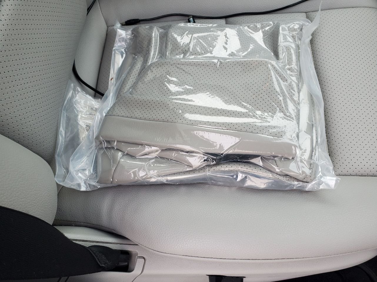

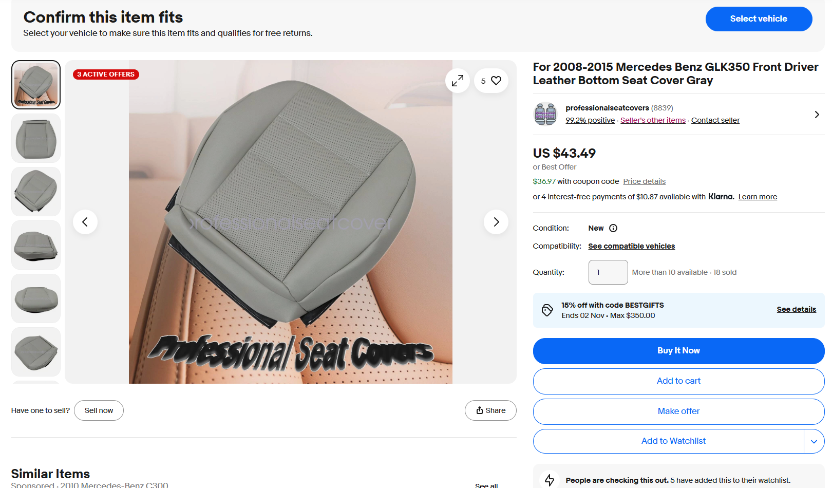

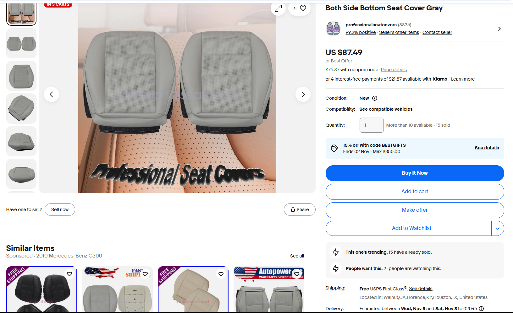

Think I may try an inexpensive ebay cover. I was just looking at a listing $74.37 for two or $34.42 for one cover using an ebay coupon. There is one review with a photo and it looks ok to me, a little wrinkled but im guessing it came folded and wasnt ironed before installing,. I'll have to contact the seller to make sure its the alpaca grey to match what I have.
I went ahead and ordered one. Will see how well it matches.
The above photo looks like a really good match.
I found a listing specifically for the GLK350 and there is one review with a photo and the seat appears a little darker in color compared to the upper seat in my opinion. I dont know what the review says though its in spanish.

Received the cover today. At first when I opened the package I thought there is no way it matches it looked like a darker grey. But when placed on the seat I just cant tell if i like it or not. It is def not a perfect match. Didnt open the package yet since im not sure I want to keep it.

Quote: Received the cover today. At first when I opened the package I thought there is no way it matches it looked like a darker grey. But when placed on the seat I just cant tell if i like it or not. It is def not a perfect match. Didnt open the package yet since im not sure I want to keep it.
I'm not "there" but it looks like quite a good match to me.

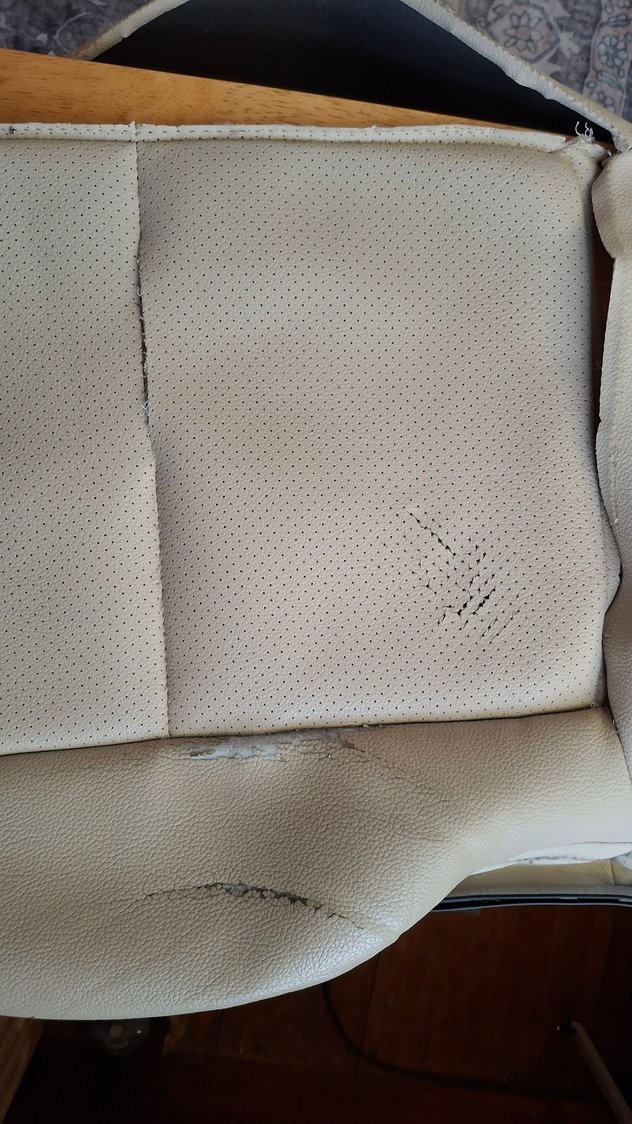

Our 2014 GLK350 Base is experiencing a slight flaking on the driver's seat, lower cushion (big surprise!) ... so, will need to be replaced.

The split in my cover is getting to the point where I'm concerned it might stress the heating pad to the point of failure. Overnight temps have been running in the single digits below zero F and I don't want to loose the heater!

My second Richmond (replaced under warranty) driver's seat bottom is looking like it may be starting to split. I can see some of the dots are beginning to connect. The sides are great. It's the perforated section that seems to have durability issues.
I don't think you need to worry about the heater. If it's the same as the 2010, it's a single wire that wiggles around a bit. That's likely why the heating performance is so poor.

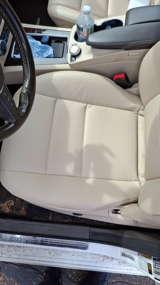

So, I went ahead and replaced the cover on the driver's bottom cushion. I decided to go cheap, and ended up with a cover from Professional Seat Covers on eBay. I didn't buy it the first time I looked, so they offered me a discount. I think I ended up paying about $32 including shipping.
Cutting the seat heater off the old cover was tedious but not difficult. I ended up trimming one of the attachment flaps attached to one of the crosswise seams on the new cover to fit around the heater wire. Otherwise installation was straight forward. The fit was good enough for everything except my OCD, as was the color match.
Two things I noticed. First, the new material is not as "slippery" as the original so you can't slide around on the seat as easily.(*) Second, the heater is definitely working, but doesn't seem to be as hot as before. It may be my imagination, or it may be that the new material conducts the heat from my butt better. IDK... I had considered putting some reflective tape on the seat cushion under the heater wires to reflect the heat up, as there was some discoloration on the cushion, but decided not to take the time given it might not hold up well, being less flexible.
All in all, well worth $32 plus 3-4 hours of my time.
The before photo:
After I hacked it up to get the heater pad off:
I thought I had an after pic, but I guess I don't. I'll get one tomorrow and add it.

Pictures, as promised.
