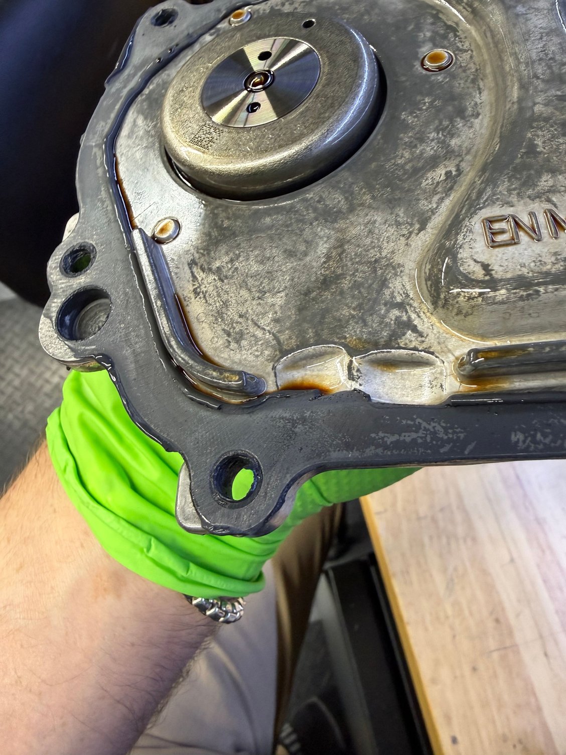

Thanks, I also thought micro crack or warped issue, so I bought a used cover from wolf auto parts.
it arrived yesterday and I noticed it’s even ‘more grey’ than mine, and after even more digging, it seems like the revision number is stamped onto the cover itself. My car has 004 revision, and what I ordered was actually older at 001 revision.
some more digging and I found a nice (used) and shiny, not grey, 022 revision part and ordered that. Will install the newer revision cover which apparently doesn’t have the anti corrosive coating, new bolts etc etc. one last time and hope for the best.

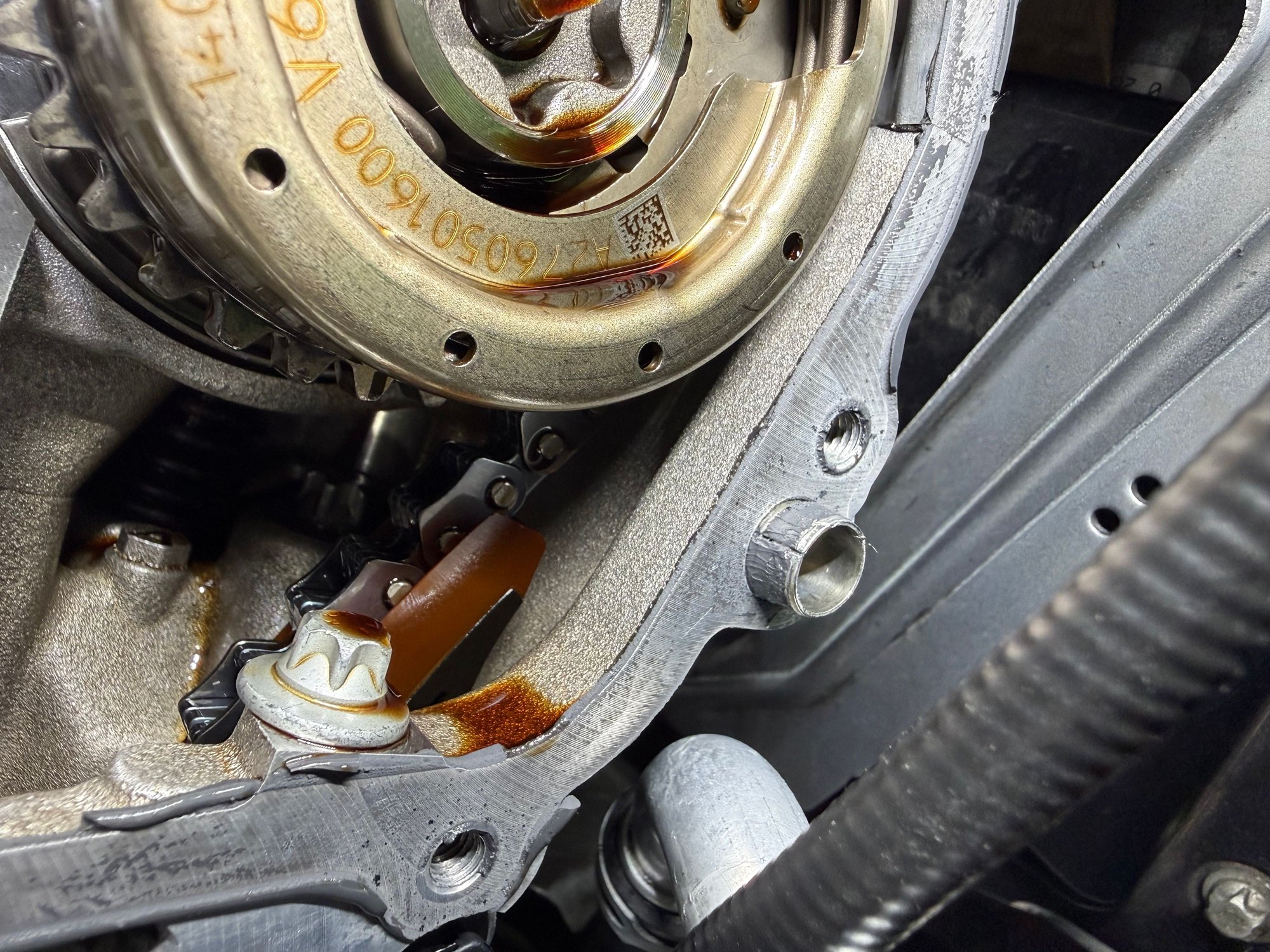

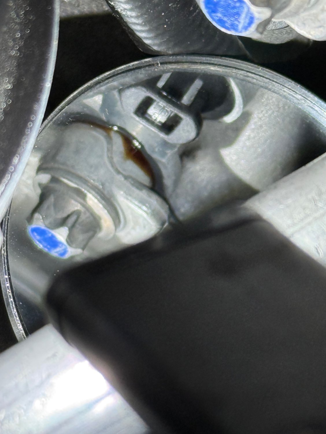

attached is a photo of the lower right bolt in question, shown as ‘moist’ underneath. This is after I dabbed away the about-to-drip oil. It really must be: cracked, warped: anti corrosive issue. I really can’t imagine two brand new beads of MB sealant with uber attention to surface prep could leak so quickly.

Does that bolt hole go into a space where liquid is present? Alternatively, is the bottom of the hole compromised, by, for example, screwing the bolt in when there is something incompressible in the hole? Either way, liquid will migrate up the threads and out under the bolt head. The fix is thread sealer, but be aware that will affect your torque procedure.
Old Nov 16, 2025 | 08:25 PM
pappe's Avatar
Joined: Nov 2025
Posts: 30
Likes: 12
2014 GLK350
The workshop manual doesn’t say to do anything special for this bolt, and the opposing side (passenger side cover) doesn’t have this issue with the bottommost left bolt. I do not believe this bolt should need thread sealant. I was considering adding it next time just in case the thread journal has a crack, but I don’t think this is the case.
It wouldn't, if the issue was the bottom of the hole was damaged. Admittedly it's a long shot, but not unheard of.

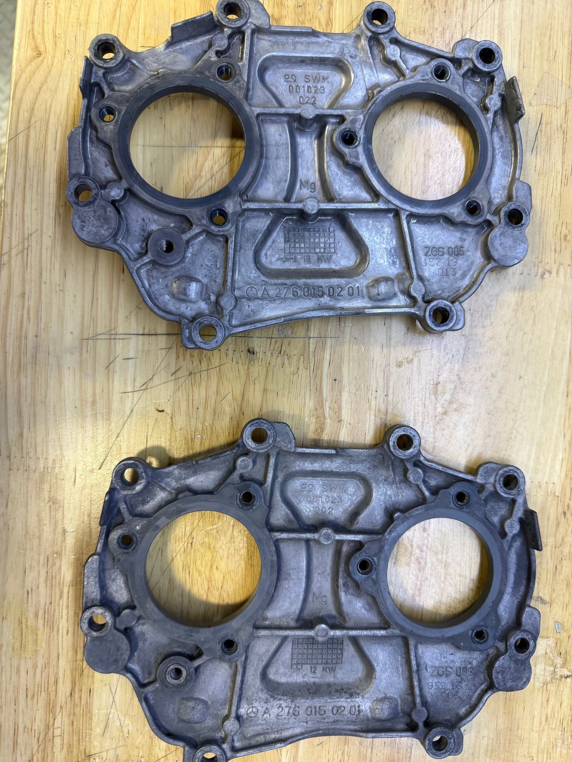

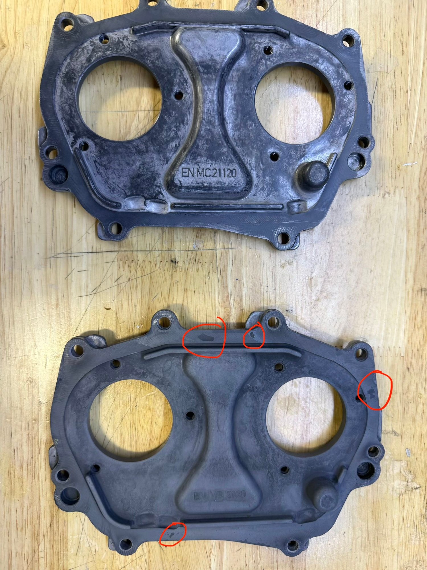

Here is a 002 revision valve cover plate compared to a 022 revision plate. Notice the newer plate seems to not have any of the anti corrosive coating.
Also note that the 002 revision part has significant deformations in the coating on the mating surface (in the red circled areas I can feel a difference in the surface height, and it isn’t dissolvable with gasket remover, thinner etc). Neither of these are from my vehicle, I bought both as used. I will use the newer revision part to try and finally solve my repeated leak.

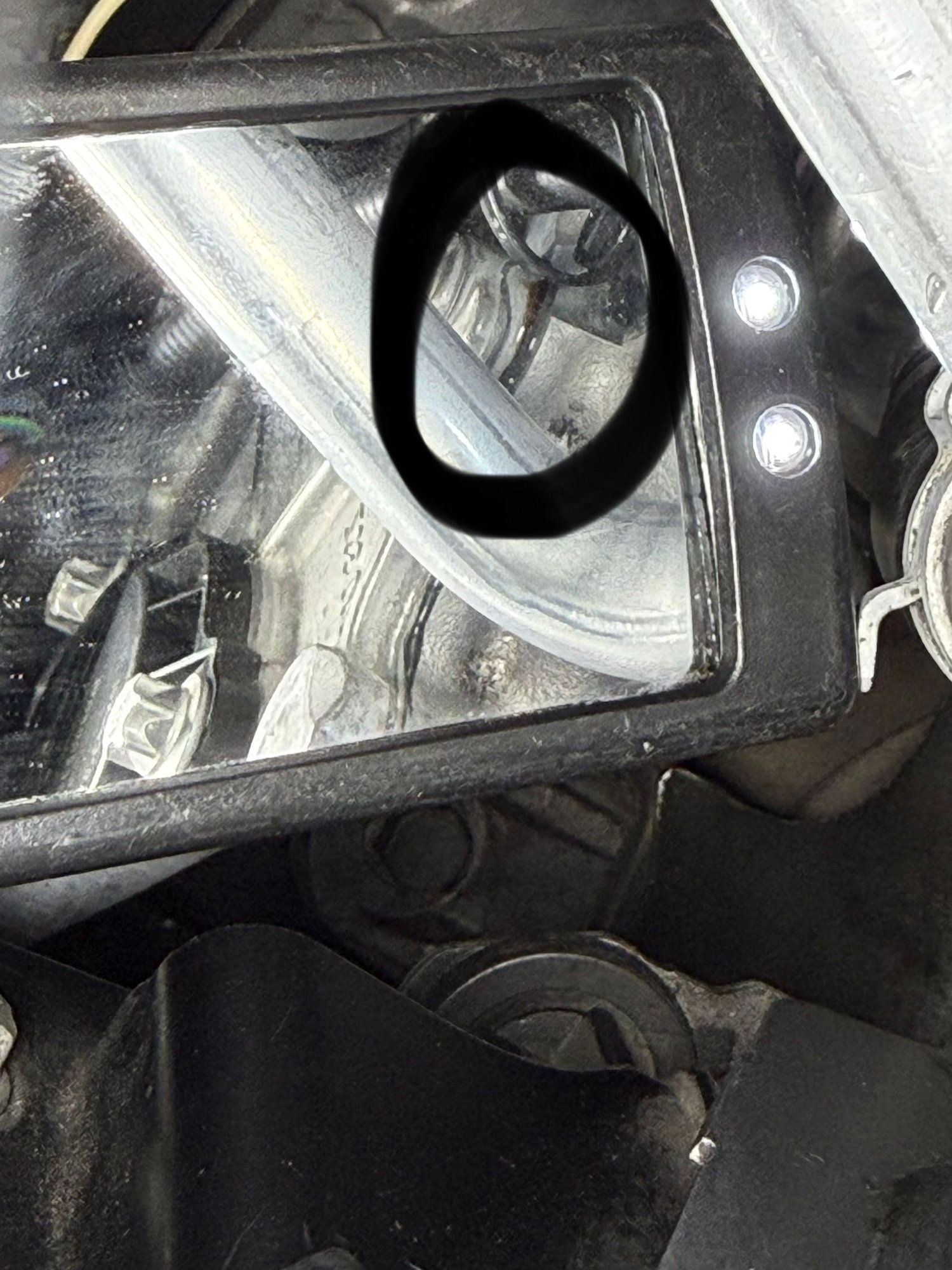

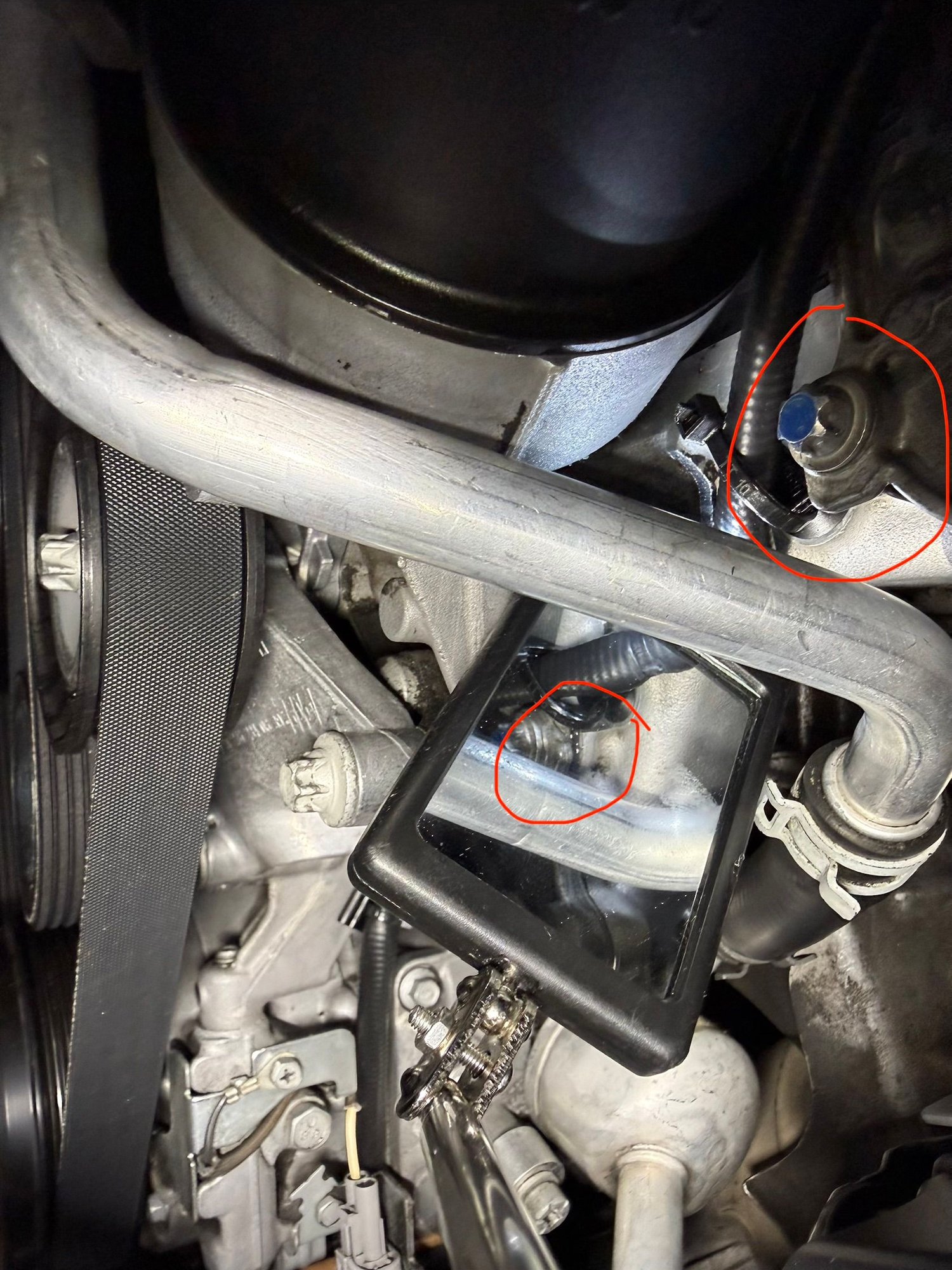

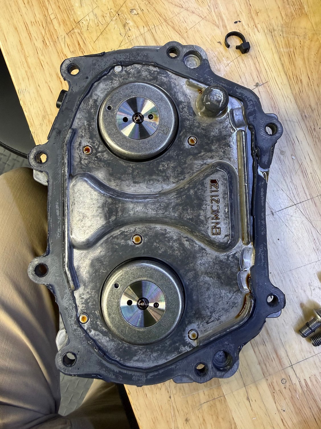

Well....on the first run with the 022 revision cover, all looked okay until turning off and letting it sit for 5 mins. Then, some oil appeared in the SAME SPOT.
I really am out of ideas, the camshaft solenoids are not leaking, and there is nothing else that looks like it could be oozing...the oil is just right on the sealant bead and just in the lower right corner....but I've done this 3x now, new sealant each time, properly dissolving and ensuring a flat and clean surface. I'm stumped!

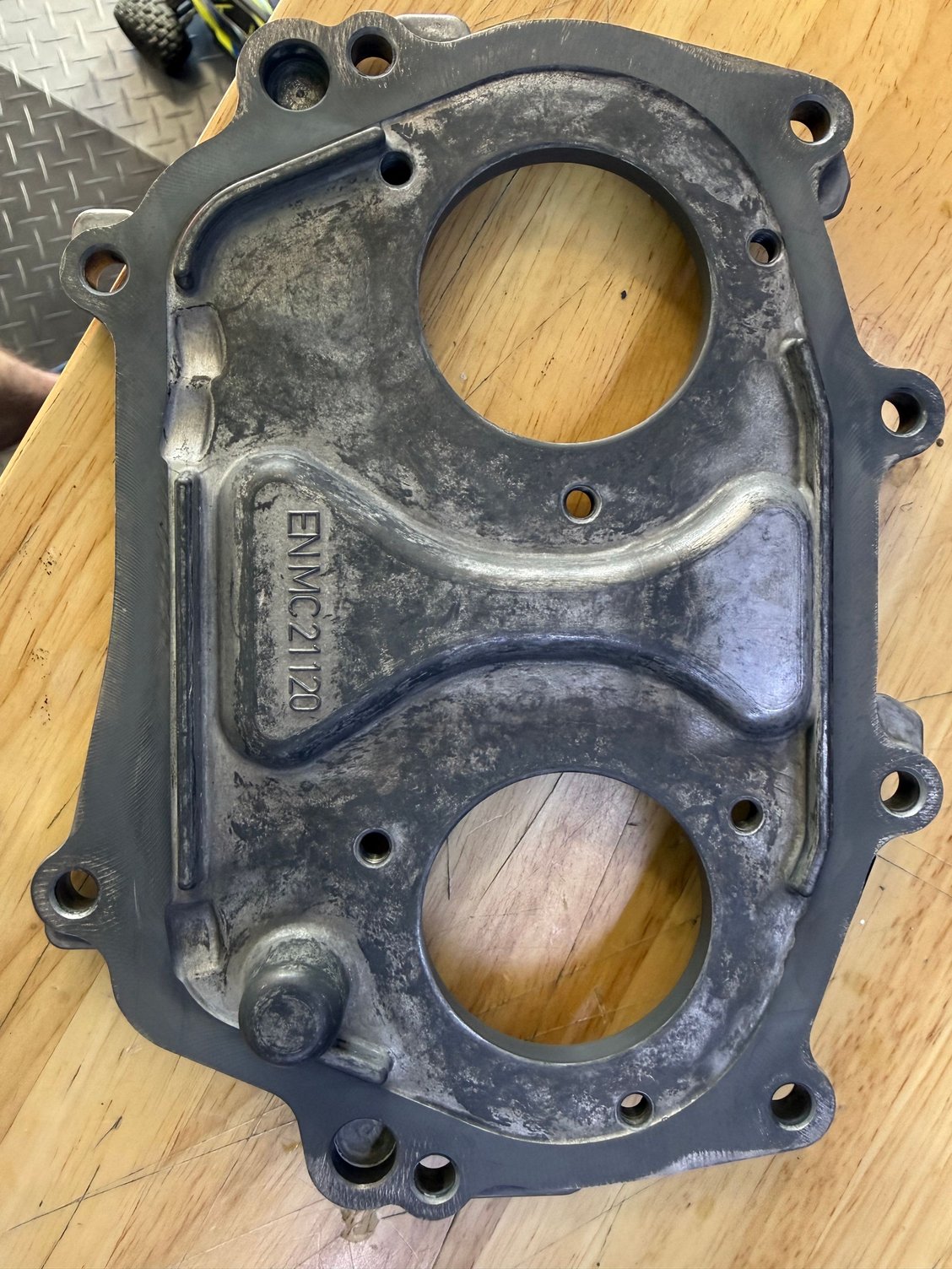

one more

What a massive pain in the neck! Have you checked to make sure there isn’t an obstruction in the bolt hole in the block? Some oil or grunge in there can shorten the effective length, not allowing the bolt to torque properly. Another possibility is that the hole in the block is either not drilled deep enough or threaded deep enough. Could also be the bolt is too long, or the tip of the original bolt broke off inside. You can verify by threading the new bolt in while the cover is off. You should be able to turn it in by hand to past the depth where it would be stopped by the cover, by at least a couple mm’s. Wouldn’t hurt to turn in the correct metric tap to make sure the threads are clean and healthy.

If you're seeing the oil at the lowest point there's a good chance the leak is somewhere higher up...

one thing I noticed: I could use a plastic trim tool and the MB gasket dissolver to get the mating surface on the valve head ‘silvery’ with very little trace of black residue, apparently ready for new adhesive. Using microfiber and mb dissolver as well.
however, upon using mb gasket dissolver in combination with a paper towel to really ‘scrub’ the surface resulted in more grey black removal from the surface. This leads me to believe at lease the last time, and maybe more, leaks were result of seemingly visually perfect, but still incomplete surface prep. Let’s hope….

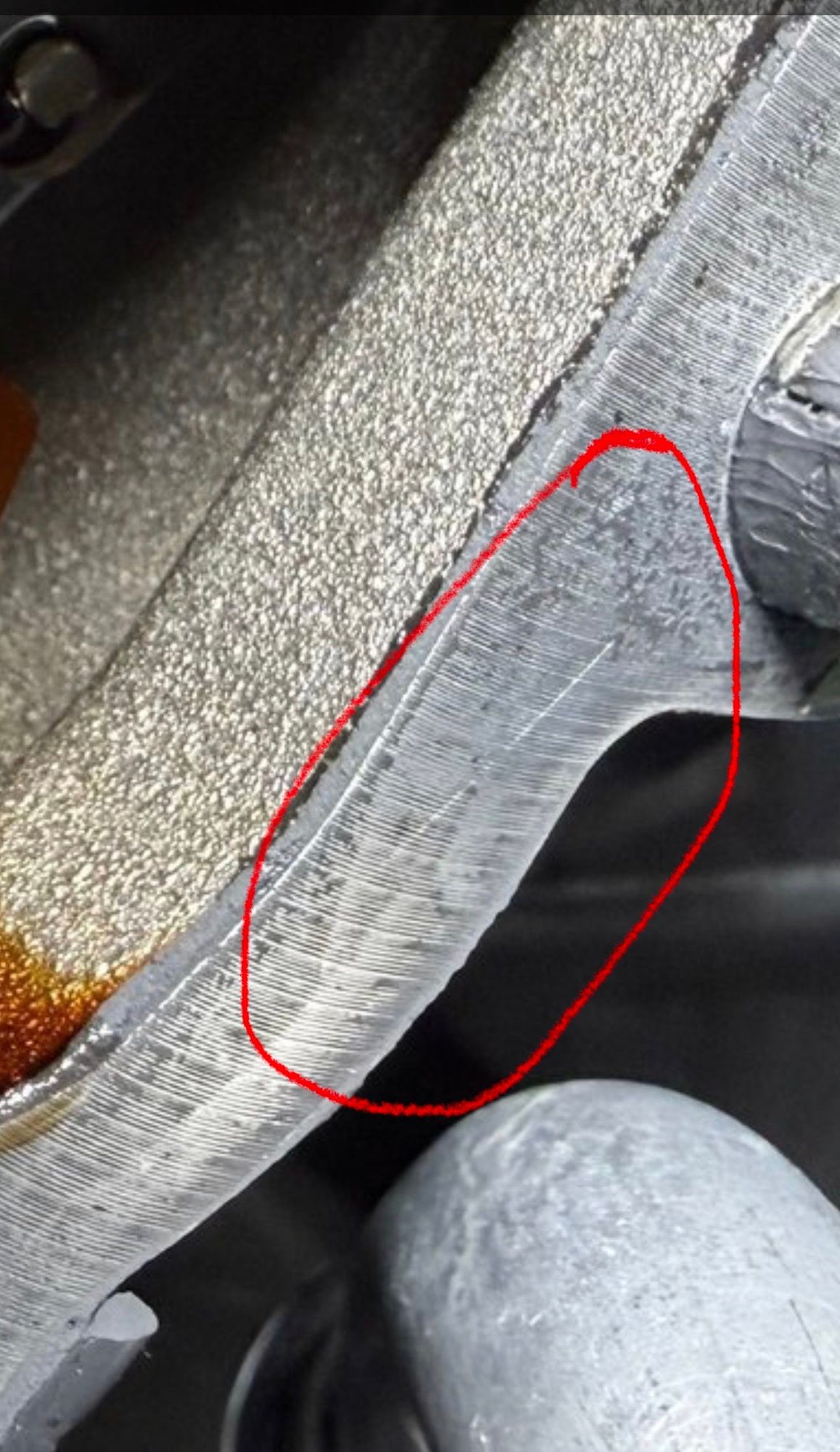

Note that I cleaned the threads each time with q-tip and degreaser. There’s no oil evidence in any screw holes.
if it still leaks this time, maybe this is to blame?
That tiny scratch? Can't imagine it would.
However, if I want to be sure, I'd use a straight-edge and flashlight (or similar) to verify.
And I would verify the complete mating surfaces, including the engine-side.
Doing so will verify required flatness.

Originally Posted by Sgt Pepper
the main point was that if the bolt is bottoming out inside the block, it will not hold the cover tight.
Or it will punch through the bottom of the hole into the interior, allowing oil to migrate up the threads and out.
The scratch in the photo doesn't extend from the interior to the exterior and so shouldn't be a problem.
The machining marks on the cover would be more of a problem, but the gasket and sealer should eliminate that.
