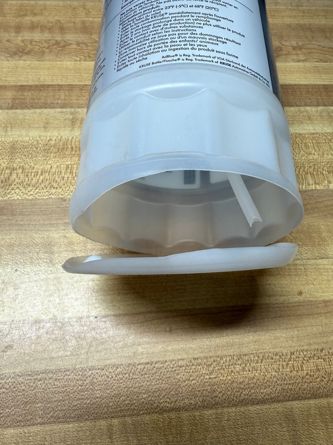

I solved this by buying some "Mercedes" DEF from the dealership parts department. They charge about 10 bucks per half gallon if you buy a carton of four. The DEF containers have a built in valve that handles the delivery (screw in and push down) and shut off (release pressure and unscrew). So if you should happen to fill it up to the brim, you just release pressure on the container and the valve closes. There is no spillage because the valve is below the top of the tank. Any left over fluid remains in the container.
As an added bonus, if you cut the bottom of the container off (or mostly off) you now have a funnel for adding off the shelf DEF if you want. I've not tried that yet as I don't use that much before having the tank drained and flushed every couple of years. Hope this helps.
Instructions may be hard to read but its basically take the top off, screw into DEF tank and push down.
Instructions may be hard to read but it's basically take the top off, screw into DEF tank and push down.
When you push down this valve opens. O-ring prevents leakage when removing.
Now its a funnel rather than landfill.
Now it's a funnel rather than landfill.

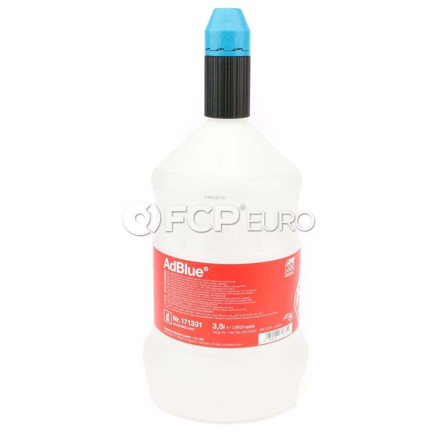

I purchased a 3.5 liter container of FEBI AdBlue. It has no instructions on the container or anywhere on the web that I could find, but looks very much like all the other products out there that do have instructions, like the one in post 5.
What could possibly go wrong? Well, press as I might, I could not get a drop out! I contacted FCP Euro customer service by email in the afternoon of Christmas Eve, expecting to wait until today for a response. Much to my surprise, I got a response late that afternoon. "Screw the bottle on to the tank until it bottoms then pull up (not push down) to dispense the fluid." Sure, I thought, bet it won't work. Well, sure enough, it worked perfectly...
So, Kudos to FCP Euro for responding on New Year's Eve, and for having the right answer. Points off to FEBI for being the odd man out, and supplying no instructions, especially when it seems everyone else uses "press down".
I bought two bottles in hopes that I could dissect one to figure out how to open the other one so it could be refilled. At this point, I'm thinking I'll drill a hole in the bottom big enough to take the spout from a 2.5 gallon jug, and use it as a funnel that way. Maybe I'll hack up the other one when I use it up and see, but I'm thinking there's no way to open it without destroying it.
Side note: The neck of the tank has to be all the way into the fitting on the bottle, bottomed out, if you will, to unlock the "pull up" feature. I made a "tool" from plastic pipe that allows me to unlock it, but that didn't shed any light on how to remove the valve from the bottle.
