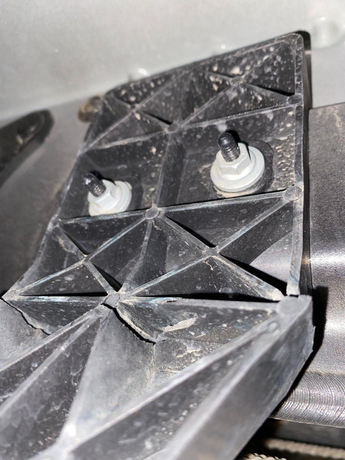

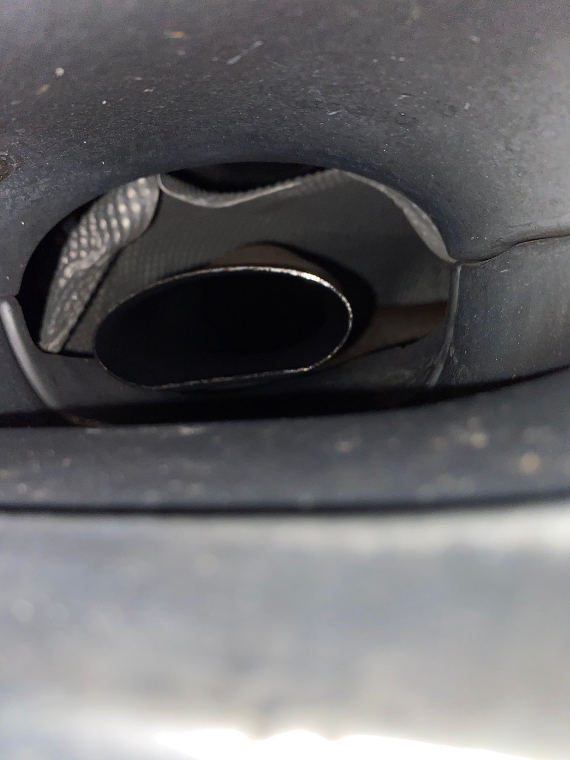

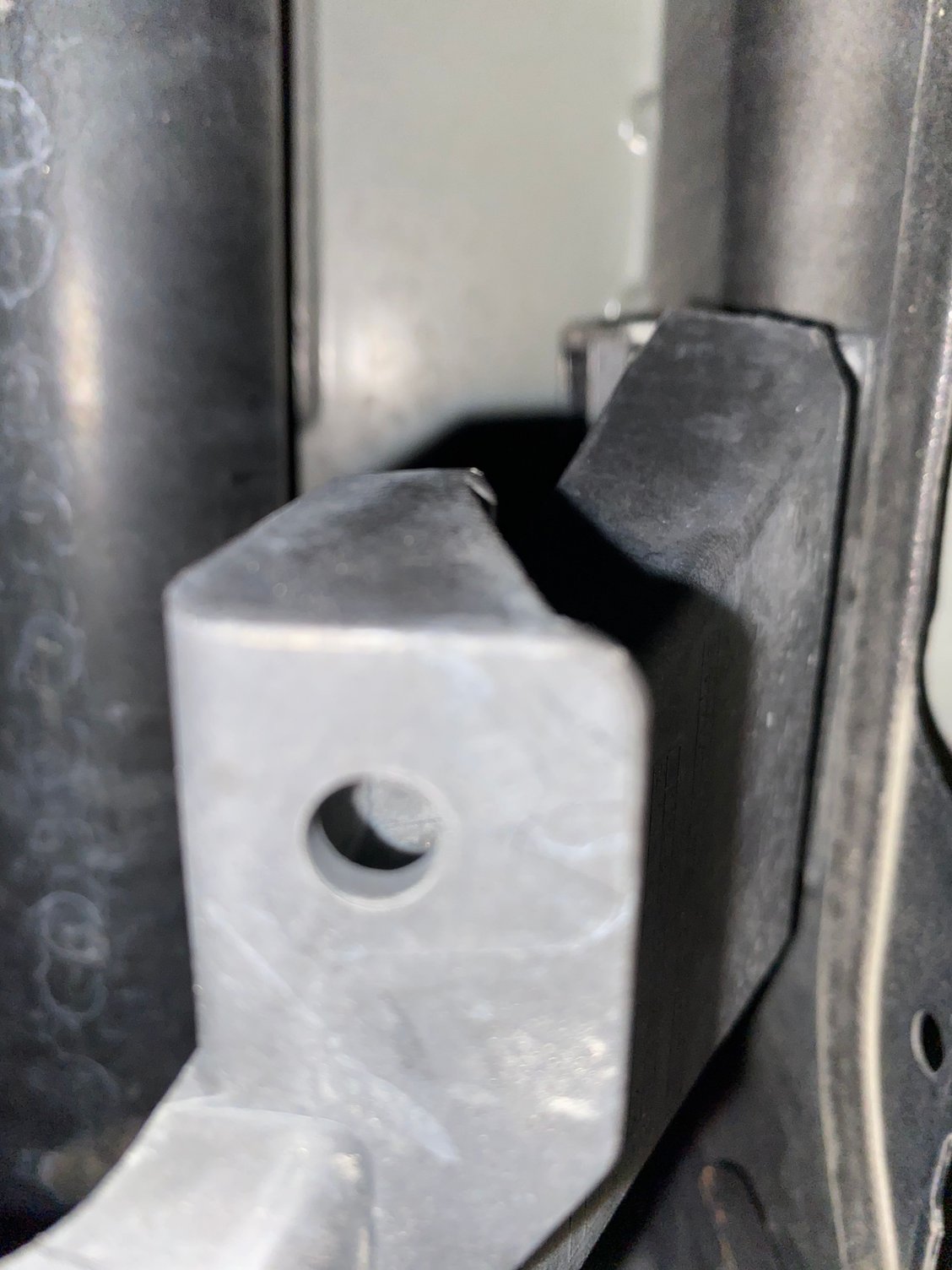

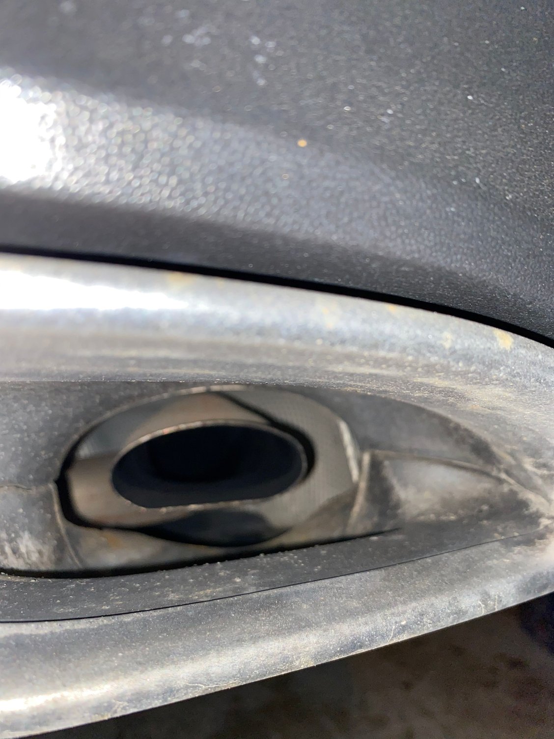

I took vehicle to local MB mechanic. They confirmed that sound was coming from exhaust moving bumper where a bracket was broken. Upon further examination, I found that tailpipe not aligned with bumper/diffuser. I also noticed heat shield was crumpled on that side and straightened it.
I went to buy part and fix myself but this part (166-880-45-00) not listed for GLS but I found it for GLE.
Does any one know why GLS parts don’t match with drawings or could it be that bumper was replaced and GLE parts just happen to fit?
Left tailpipe view through bumper
Right tailpipe view through bumper
Broken left mounting bracket 166-880-45-00
Top of Broken left mounting bracket 166-880-45-00

The photos clearly show collision damage. It's conceivable and likely that parts are shared between GLE and GLS on the W/X166 platforms.

Can someone take a photo of their GLS 550 exhaust, similar to the ones I posted?
Since there has been work done on this back bumper, I wonder if tailpipe is supposed to look like this or if I am missing parts.
