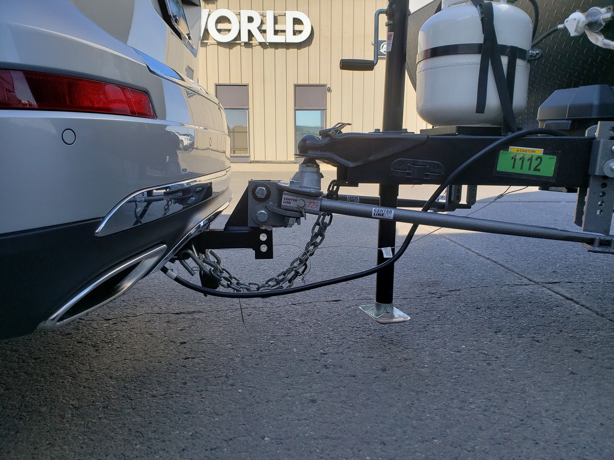

Thanks. Attched are the pics of the stickers on the hitch and the WDH hooked up. I checked with the dealer and they said it works fine.

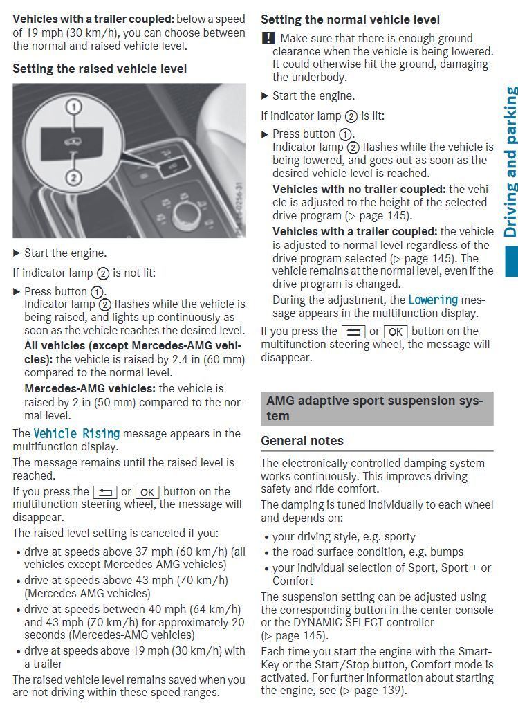

Your Airmatic will level the vehicle

while that is true, the advantage of additionally using a WD Hitch is to take weight off the rear axle and distribute it to the front axle and trailer axle(s).
i have used the terrain height when coupling up the trailer and connecting the hitch, then lowered it to road mode when going on the trip. excellent feature.

Thanks. Do you think the height from the top of the hitch receiver and the base of the ball shown in the picture is too much? On the spec it says should not more than 2". Did you use the vehicle rising feature when hooking up the trailer and then lower it when it's hooked?

seems a little high.
i tend to walk away 40 yards and see how everything looks from a distance. you will want it all together to be level.
yes, the raised GLS will help to take weight off the bars and since the lower position is the normal driving mode, that's what i ultimately set the hitch for and aim for regarding setup height.
