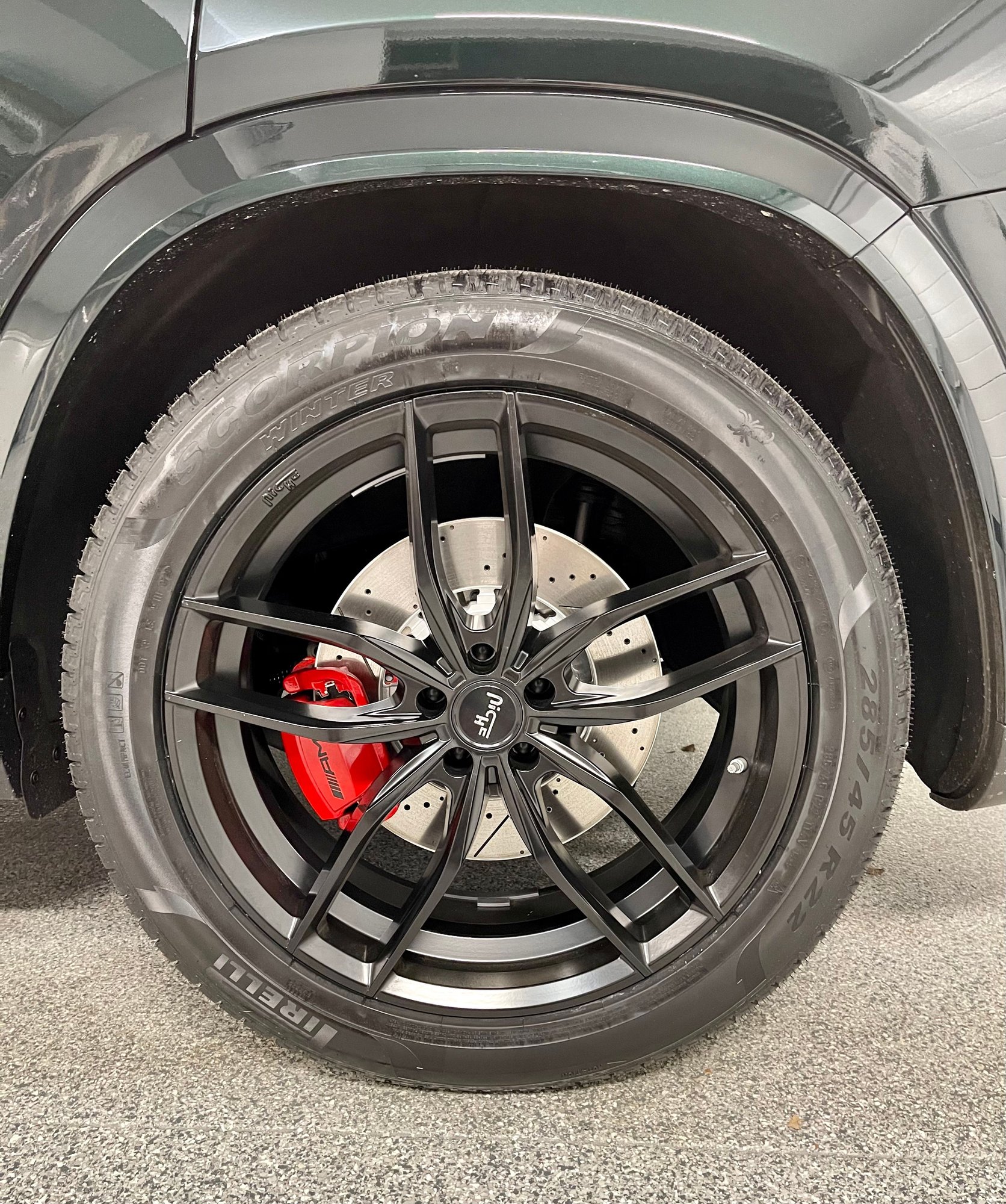

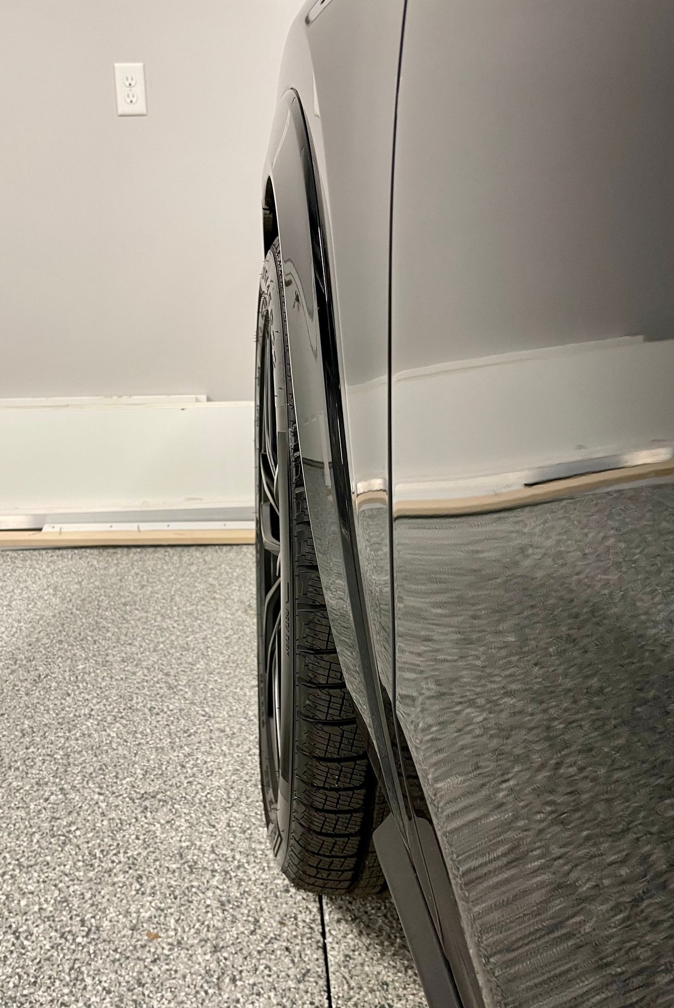

My setup:
Wheels: 22x9” Niche M203 wheels with +27 offset. Pokes 5mm in front and tucks 12mm in rear. No rubbing, not issues.
Tires: Pirelli Scorpion 285/45-22 all around.
Purchased from BB Wheels from Troy, ext 1022.. The TPMS they sent that reportedly work for the 2020 GLS580 DID NOT WORK. My local Benz dealer got me the right ones.
Let me know if you have any questions.

Front fitment
Rear fitment. Slight tuck.

Looks great! Really shows off those huge brakes on the 63!

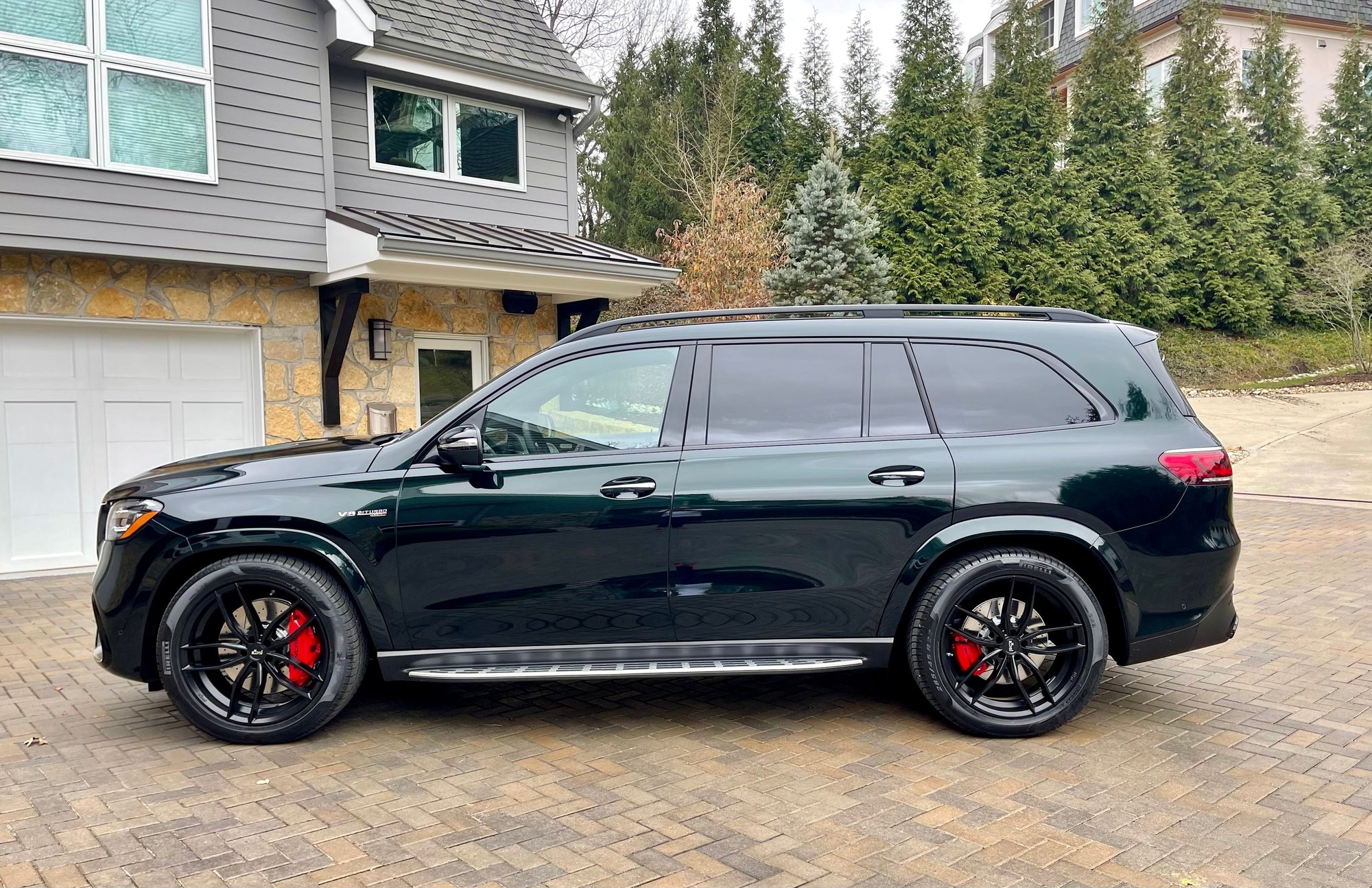

22” winter tires DO exist!
I now have in my garage a set of 4 winter tires that fit my factory 22” wheels! Pirelli Scorpion Winter in the staggered 285/45-22 F 325/40-22 R XL 114V sizes needed. That’s the good news. The bad news: $2,504 from my local MB dealer, unmounted. I know summer is still coming, but I’m now ready for fall!
Those are some wide tires!

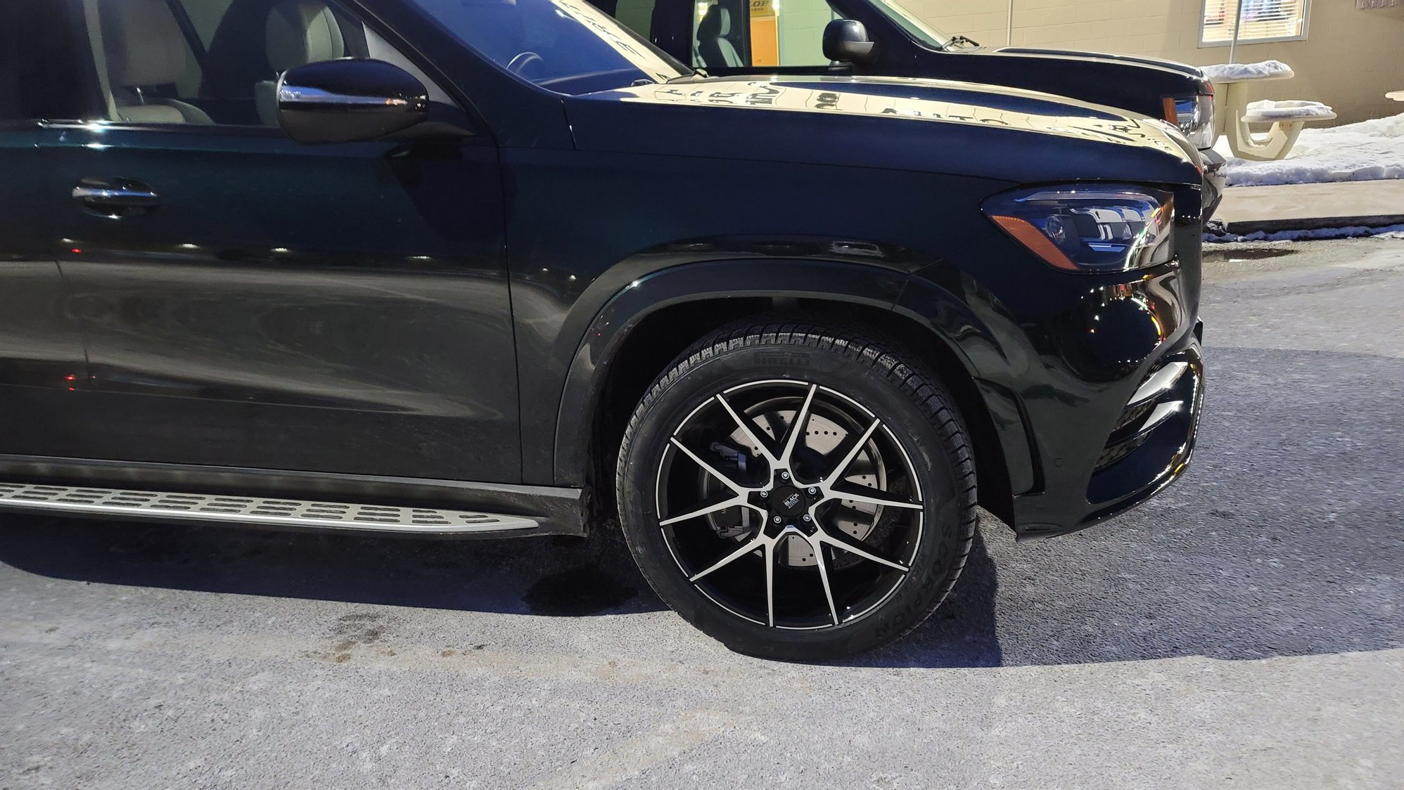

I just have a set of 21s of the same width as the front. As everybody else I have scorpions. They have mediocre snow performance but at least they are "decent" on dry winter snow conditions, it is what it is. The rims I got from tire rack actually look good. I would not recommend any bigger since snow performance is worse as the sidewall is reduced. Every spring I'm desperate to put the summer Contis back on since they are superb.
